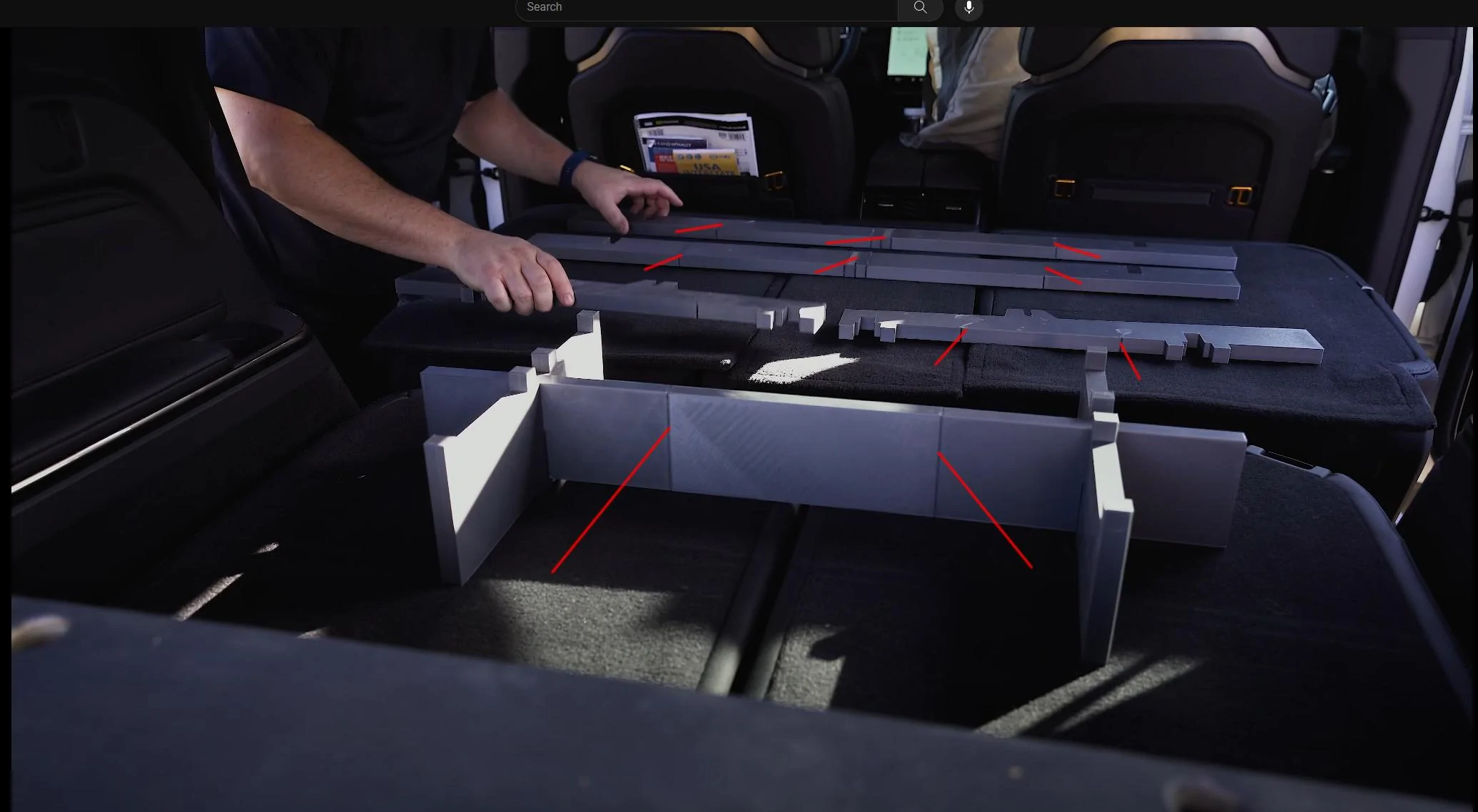

Came across this from Charge Overland on YouTube.
Plywood modular bed platform with 3D printed angular bracing to turn the rear of the R1S into a level platform with storage.
If you haven't checked out some of his videos, great Rivian eye candy and in depth California centric overlanding tips and tricks.

can anyone elaborate or ELI5 how this thing works? I mean, other than just prints, what are the costs involved? And would they do it at a UPS that has a 3D printer,etc.?
The brackets look pretty unimportant. Mostly to stop things from getting scratched up or damaged. Same thing could be accomplished with a specially sized t-nut and a 90.

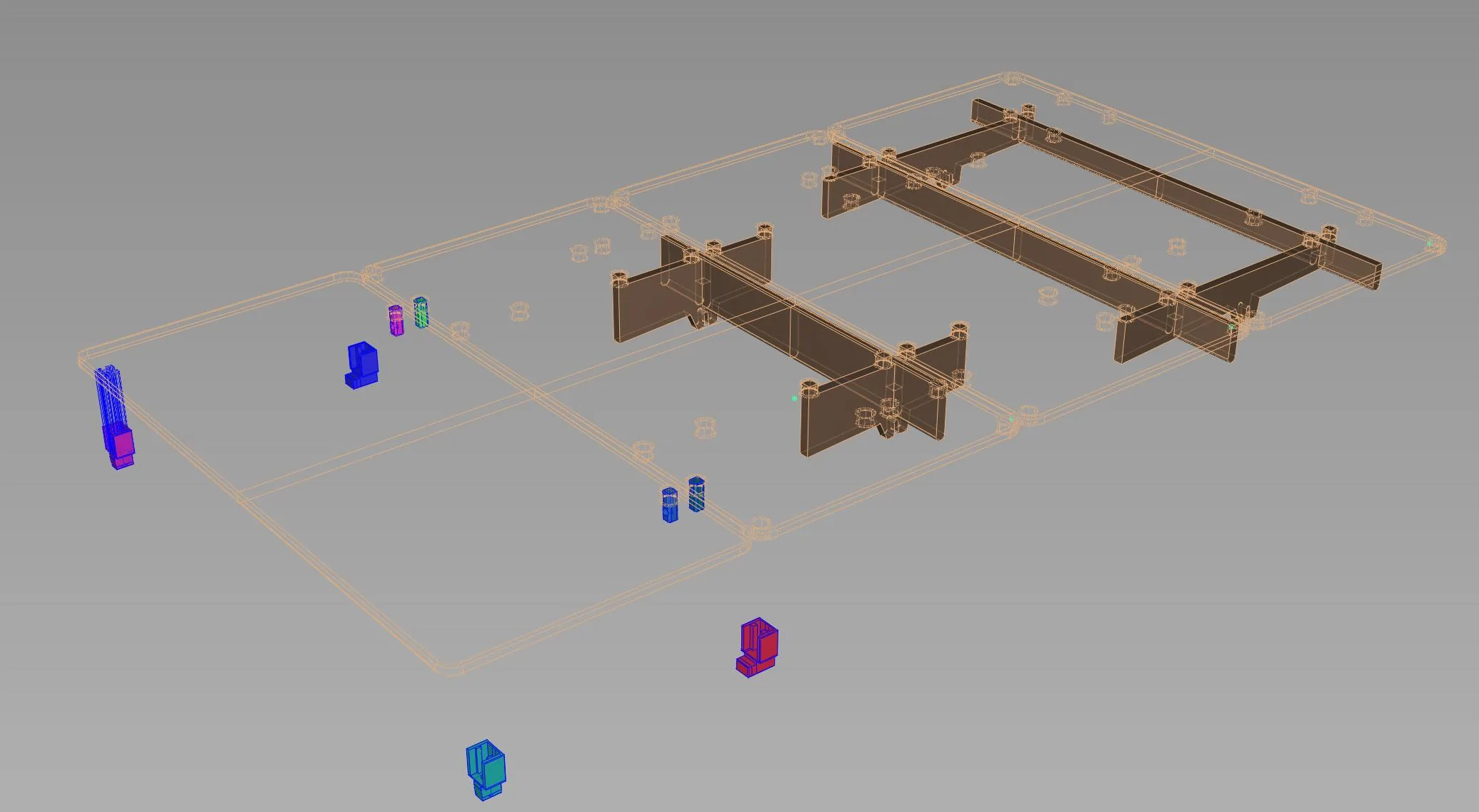

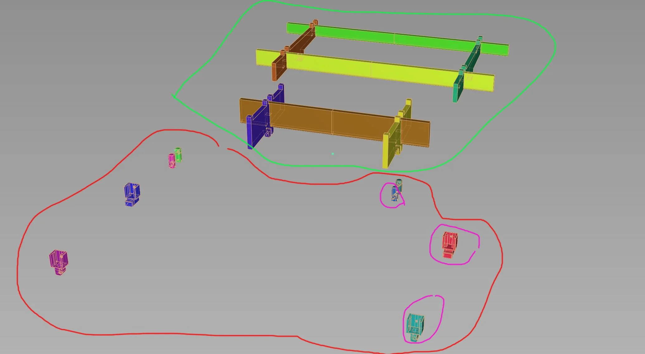

Looks like all those supports (grey) were also 3D printed in sections, Probably glued together because of print bed size. But they seem to hold the weight and he said he used them instead of using them as templates to cut from wood. I guess they could be made either way, wood or 3D printed.. I was able to open the provided data and there's really only 3 Unique 3D printed parts (circled in pink) to mount the aluminum structure, the rest can be cut from 3/4" plywood which is nice.. (3rd image orange)

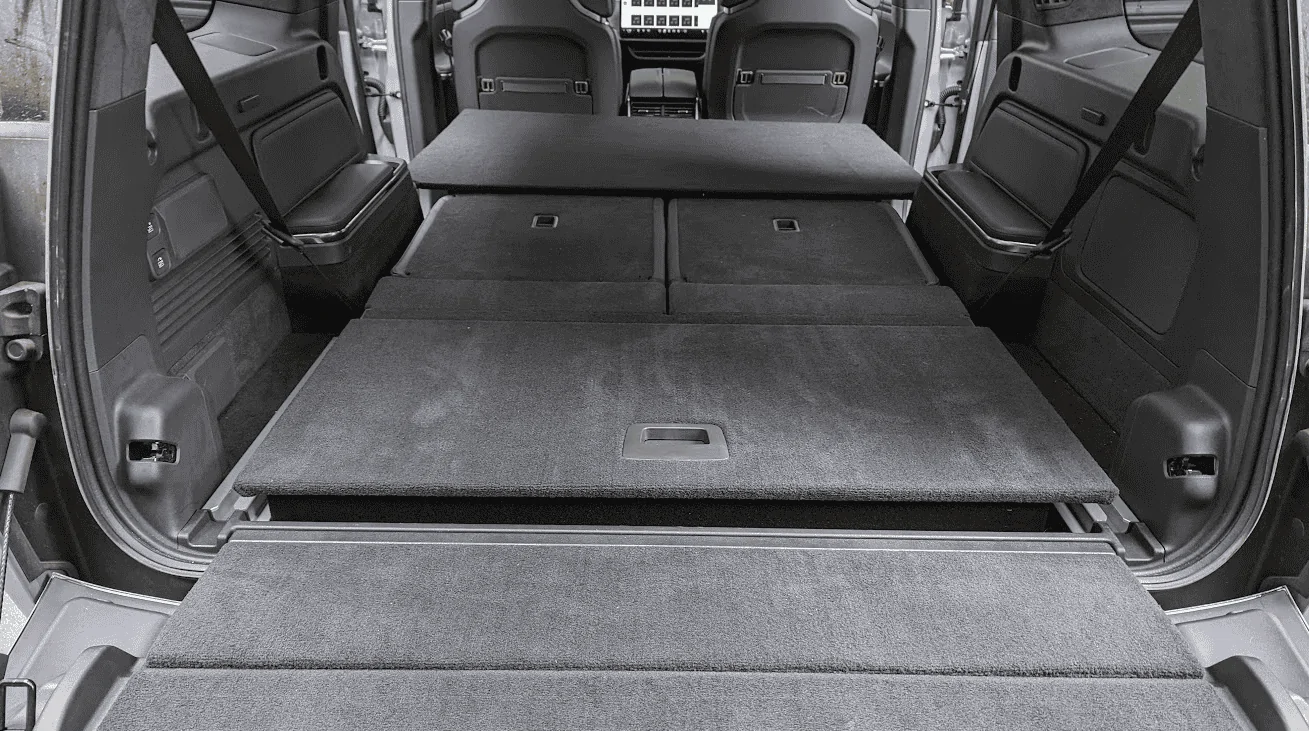

We have an exped medium duo that fits in the back and you can leave the second row up, just slide it forward, so that sleeping platform is super long.

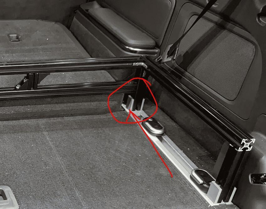

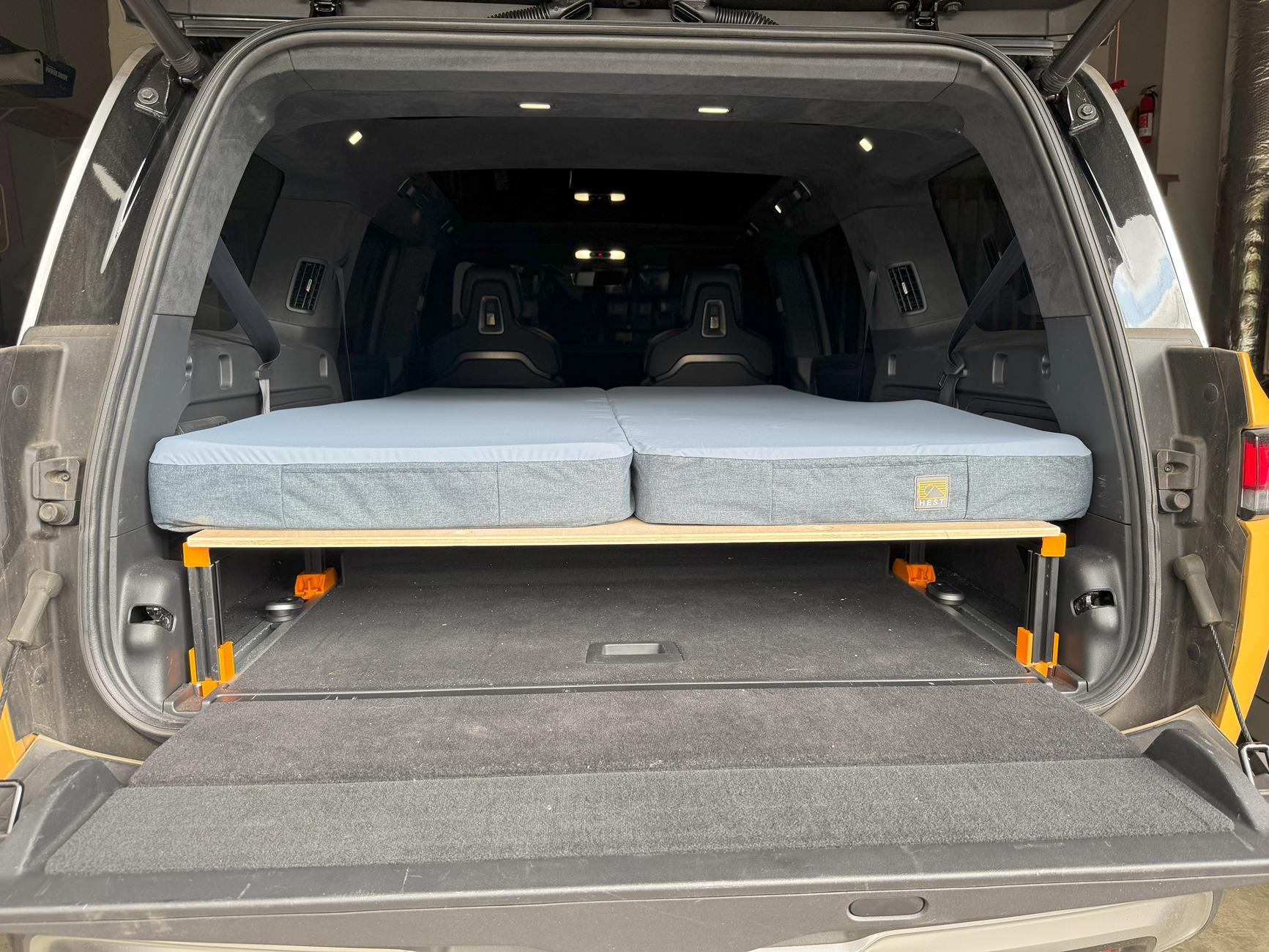

Has anyone been able to actually build this?
I have all of the parts printed, and extrusion cut, but hung up on getting this bracket in the rail.
Rivian R1T R1S R1S Interior Overland Bed Platform DIY 1740160458647-vs
I unbolted the whole rail, expecting it to lift up so I can slide the bracket in.
The rail seems to stay in place, so I can't get this bracket in there.
Any tips on how to get the Rail up or out, after I removed the 3 bolts inside of it?
Maybe I'm missing somewhere.
Thanks for any insight!

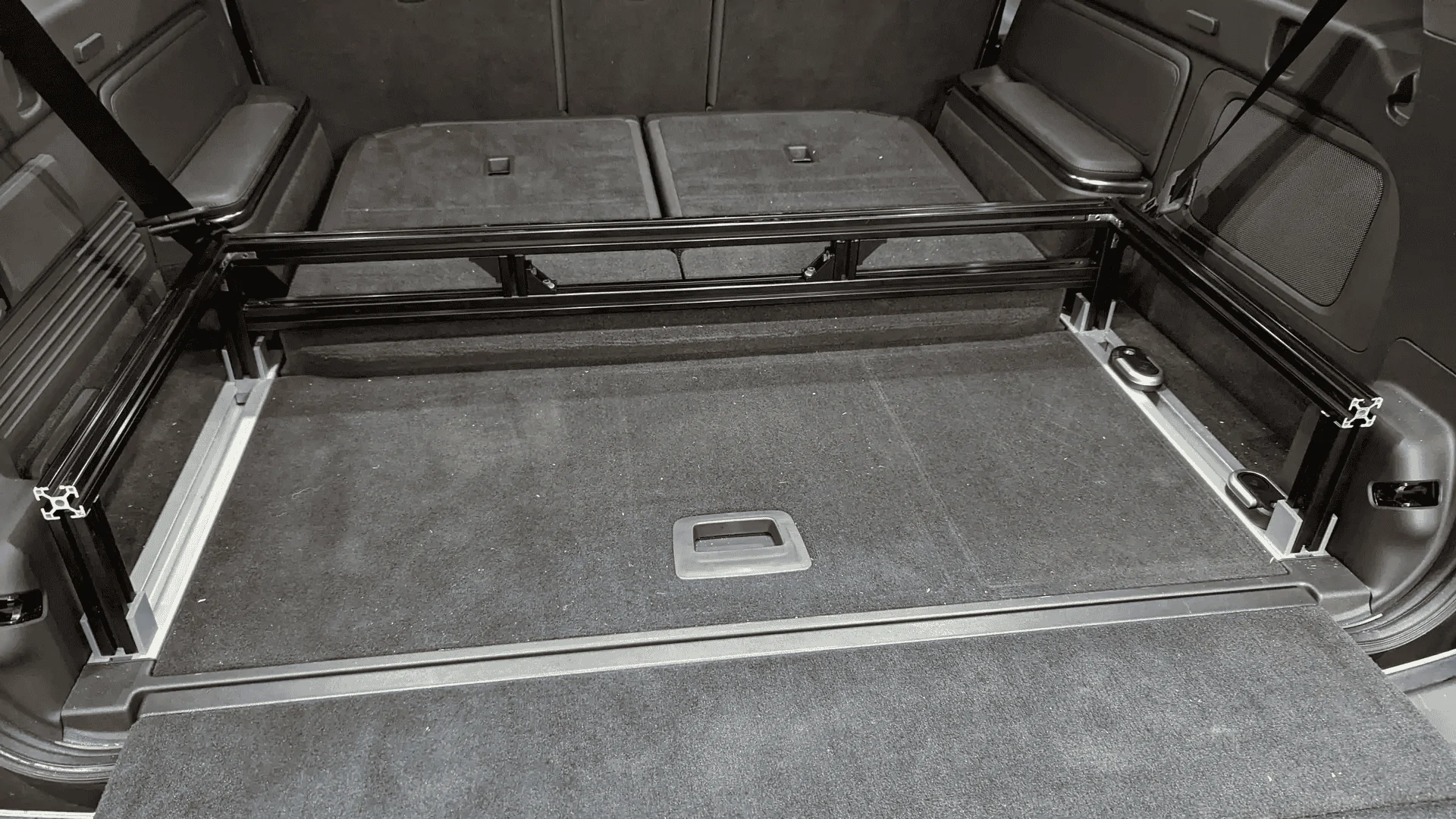

Nice Setup. I would have probably gotten that if it was available before I invested in making it. looks like they were heavily "inspired" by the original design.
