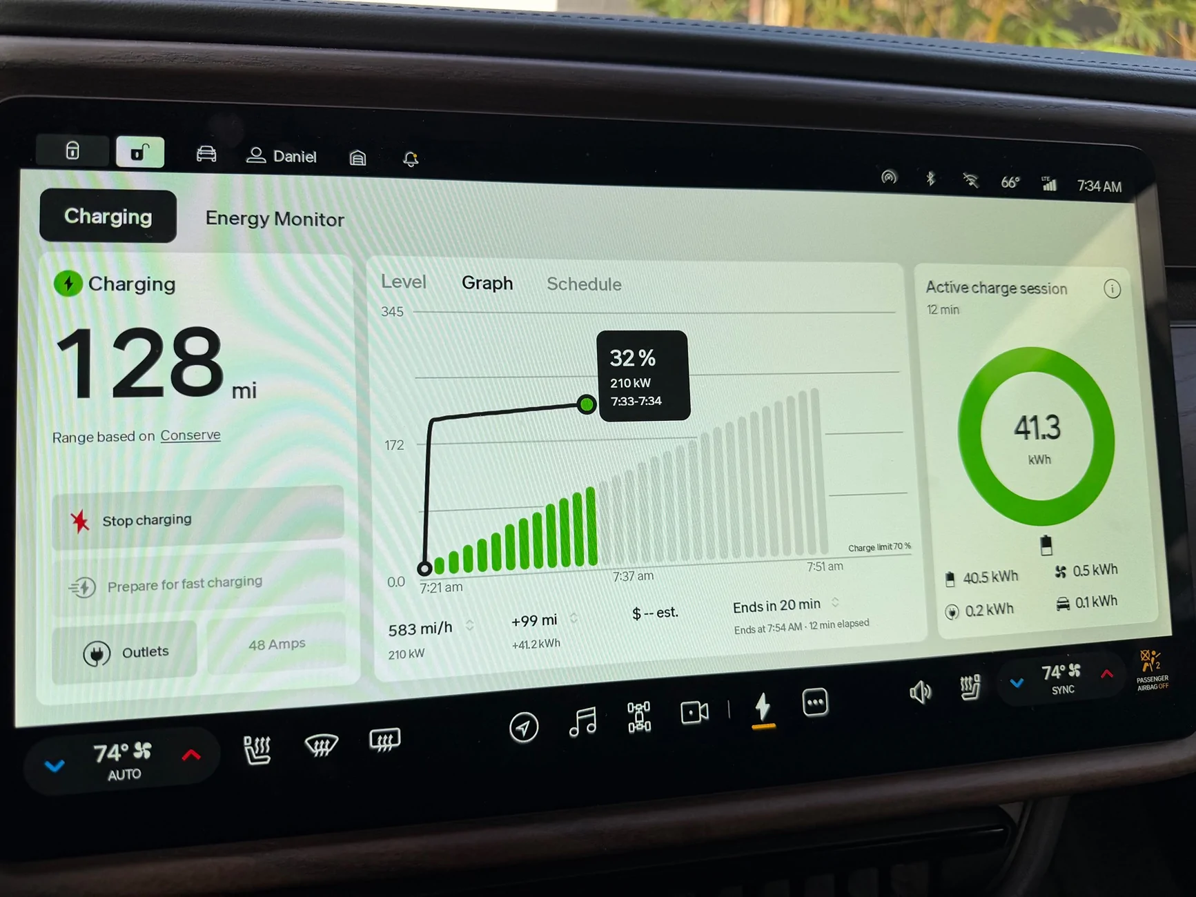

My curve from a few weeks ago. It typically looks similar to this. Gen2 r1s. I usually set the directions to the charger and so some preconditioning occurs as well.
Rivian R1T R1S R1S G2 Charging Curve IMG_0942

Show us a picture of your energy page the next time you do this drive to see how much energy your HVAC system is using.
