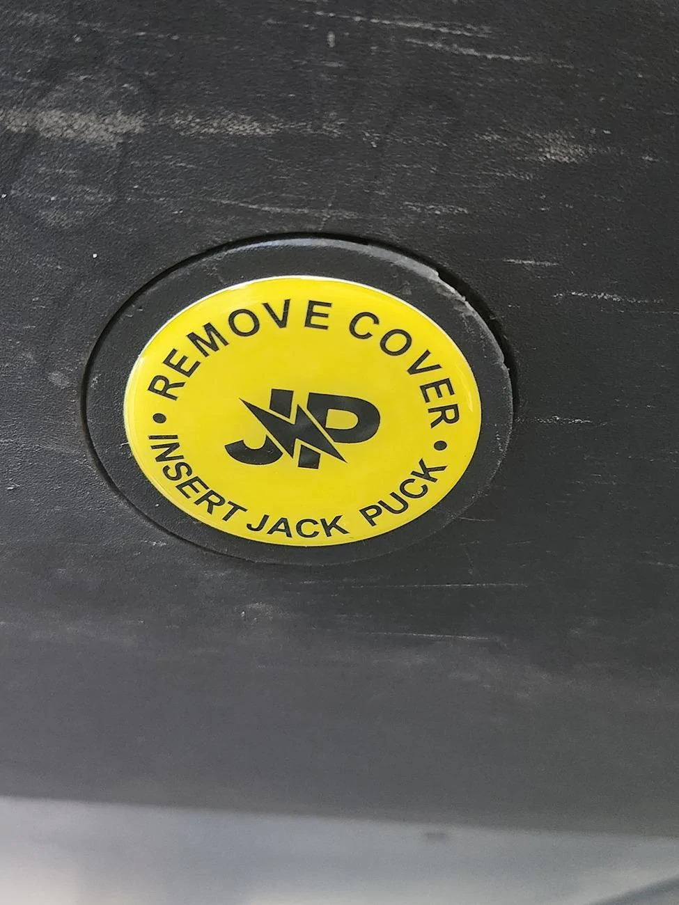

Thank you. I purchased the kit + emblem.

Rivian R1T R1S Puck nipples taken out Yellow Emblem 3

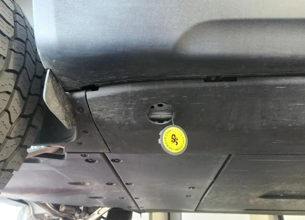

Rivian R1T R1S Puck nipples taken out 20250117_135818

Update: I had running boards installed last year and the installer removed the plastic cover (my call). After the inital issue with the DT visit, I thought this may be an issue so I explained this to the manager today and he said it wasn't an issue. He showed me the pucks he had and they looked new and with the nipples. They assured me that they had an experinced crew. After a few minutes, I got the car back with the tyres rotated.
When they called my car the DT person that worked on the car told me that they didnt need the pucks and jacked the car up on all four corners using their usual method. I went back in and asked the manager if that was the case and he said yes but not to worry as everything was ok.

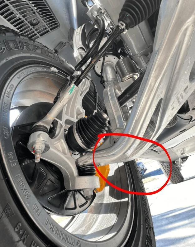

If they jacked from beefiest part of lower control arms, closer towards chassis, that is perfectly fine.

This area of the lower control arm is what Rivian field service has used.....

Yes, that too, and require less max lift height from jack. Better, actually. Forces are triangulated and better distributed.
