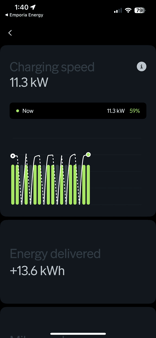

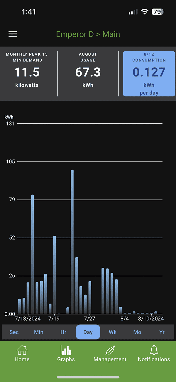

2 sources (screenshots below) give me some idea of drain when not driving but plugged in while in garage (no gear guard)
Rivian app screenshot of info while topping up . This graph disappears once charge level attained.
Emporia charger app data screenshot showing drain while parked compared to driving in July.
