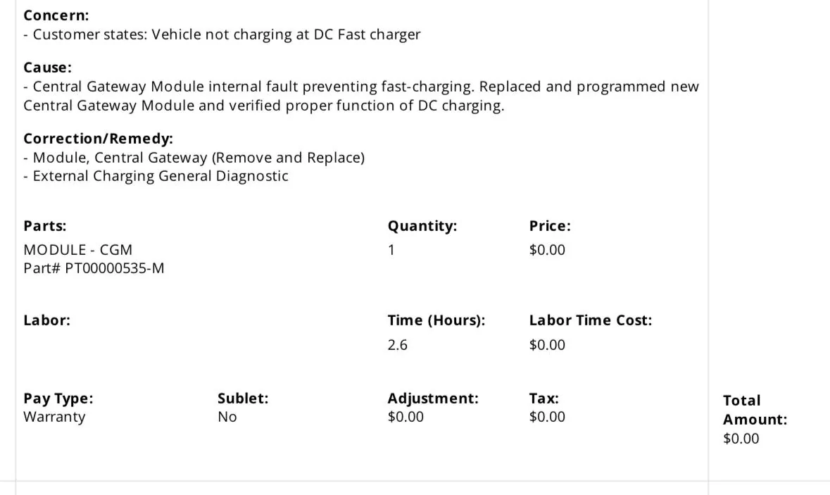

My T was delivered last week with the "Fast Charging unavailable..." message showing. Great final QC... :mad:
It's at SC now and they are ordering a "Charge Port Door Latch".
Seems difficult to believe that this is causing the problem rather than the module as stated here previously.
Anyone had this part replaced before?

Update:
The door was NOT the problem.
They keep the T for another few days.
So far I have had this truck in my possession for 4 hours, Detail Shop for 6 days, SC for 7 days with no end in sight...hrmmm.
