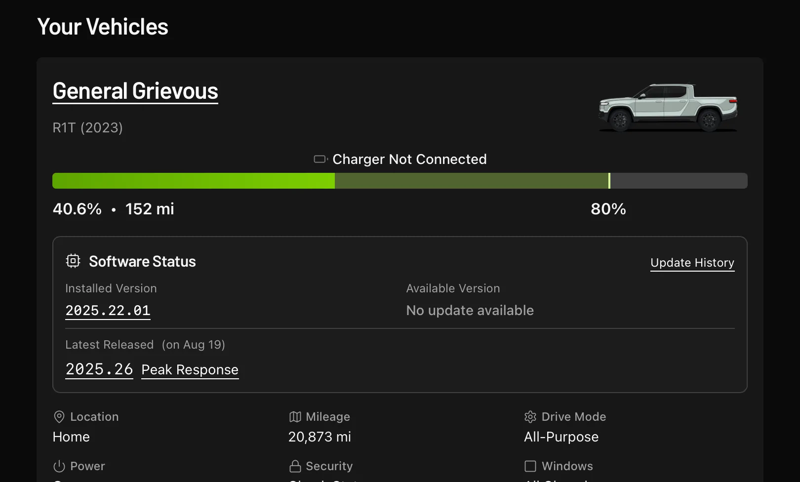

Has anyone else not received the latest update, 2025.26? Curious if anybody else hasn’t been pushed this update. Rivian Roamer shows 99% eligible for Connect+, and shows no update available next to 2025.22.01 for me. Gen 1 ‘23 R1T, Connect+ subscriber.
In typical fashion, 2025.22 was the first update in the past 1.5 years of ownership that I would say has been has been ‘problematic’ enough for me that it’s required two hard resets and a handful of soft resets to get various things working again. Was looking forward to updating off it, but 2025.26 doesn’t seem to be coming my way!

Just text support and request it be pushed.
Click the little wrench in the app and follow the prompts.

I had the same issue, and then one day noticed the update said “Paused” inn the Rivian update screen. Rivian Roamer indicated this was due to loss of connectivity, even though I have a strong wifi and separate mesh router in my garage. I did the two button reset, which did not seem to help. Then I started playing around with disconnecting to one wifi network to another. While there was a slight delay from doing these actions, the update proceeded to download and update. Note that I do not have Connect+. If I had, another option is to disconnect from wifi altogether and use cellular.

Rivian's connectivity is not the best. I see about 10% of owners wind up having the download paused because of connectivity issues. You can have the best Wi-Fi and it'll still sometimes happen.

Yeah looks like I need to try again. I did about 5 days ago and got told if it wasn’t an issue of a failed download there wasnt anything they can help me with and I just needed to wait for my batch to be sent out. Seems like that’s already happened for everyone.

I have had this issue happen once on a past update as well. This time it just never came through. I’ll see if service can get it pushed to me.

Thanks. Going to try this again now. I did 5 days ago and they said I just needed to wait, but seems like it just never made it.
