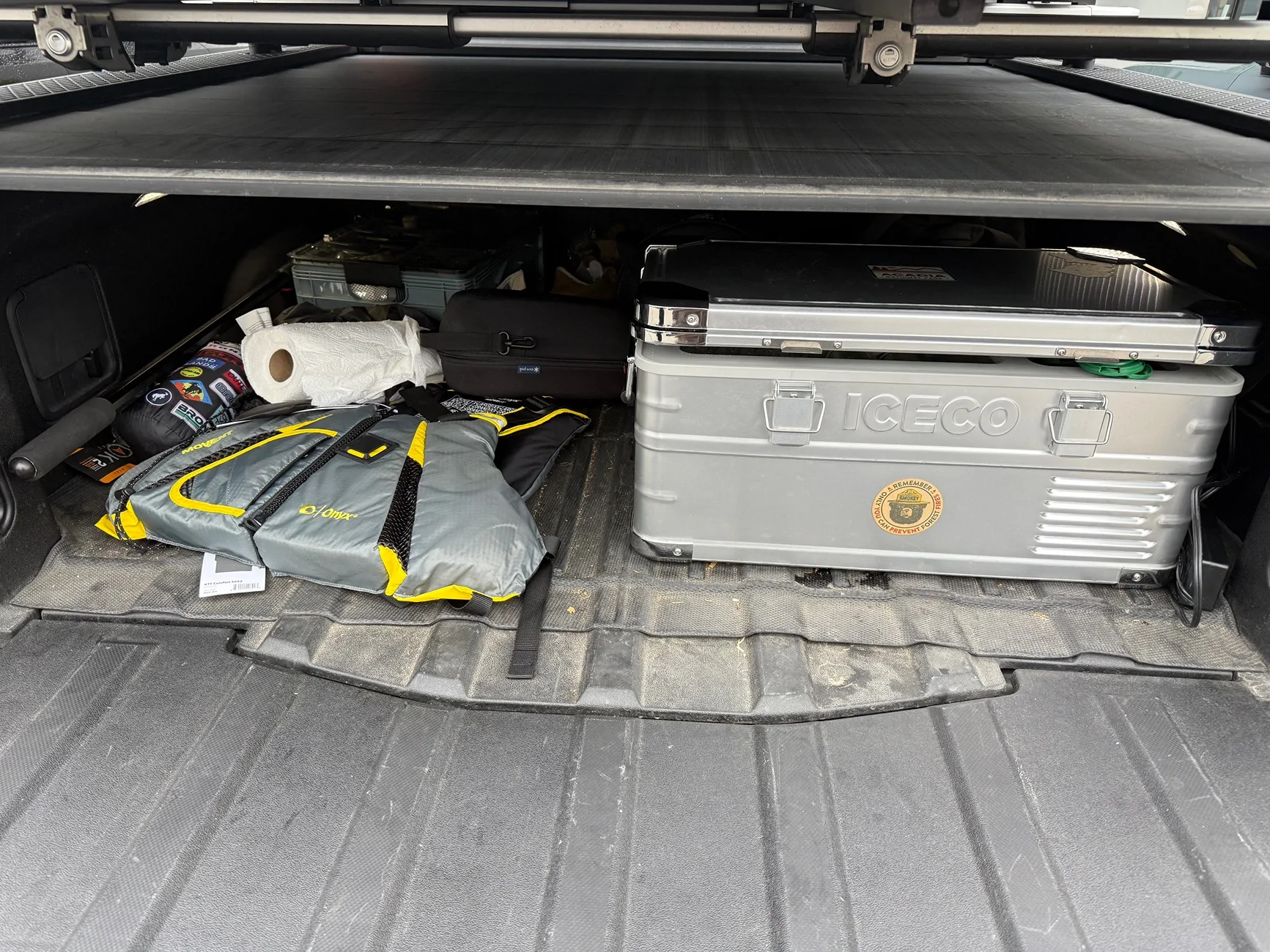

Hi all, I have an ICECO fridge that I want to mount on a slide in the bed of my R1t. I hate the idea of drilling into the bed, but maybe it’s the only way to do it. Anyone done this differently or have tips on what to do/not do with this?
thank you!!

So it's impossible for you to conceive that others have different needs?
As to a no-drill installation, I can see three easy things. One would just be a sliding arrangement with wheels or other supports to keep it from tilting down as you pull it out. Another thought would be literally just wheels, attached to the cooler or to a frame it sits in. And a third is to glue t-nuts or something similar to the bed.
If you decide to remove it and drill, just know that it's pretty easy to get the sides out. I've had mine out. I don't know about the bed, but probably easy also. If you do that, nutserts would be an obviously great choice for this.
