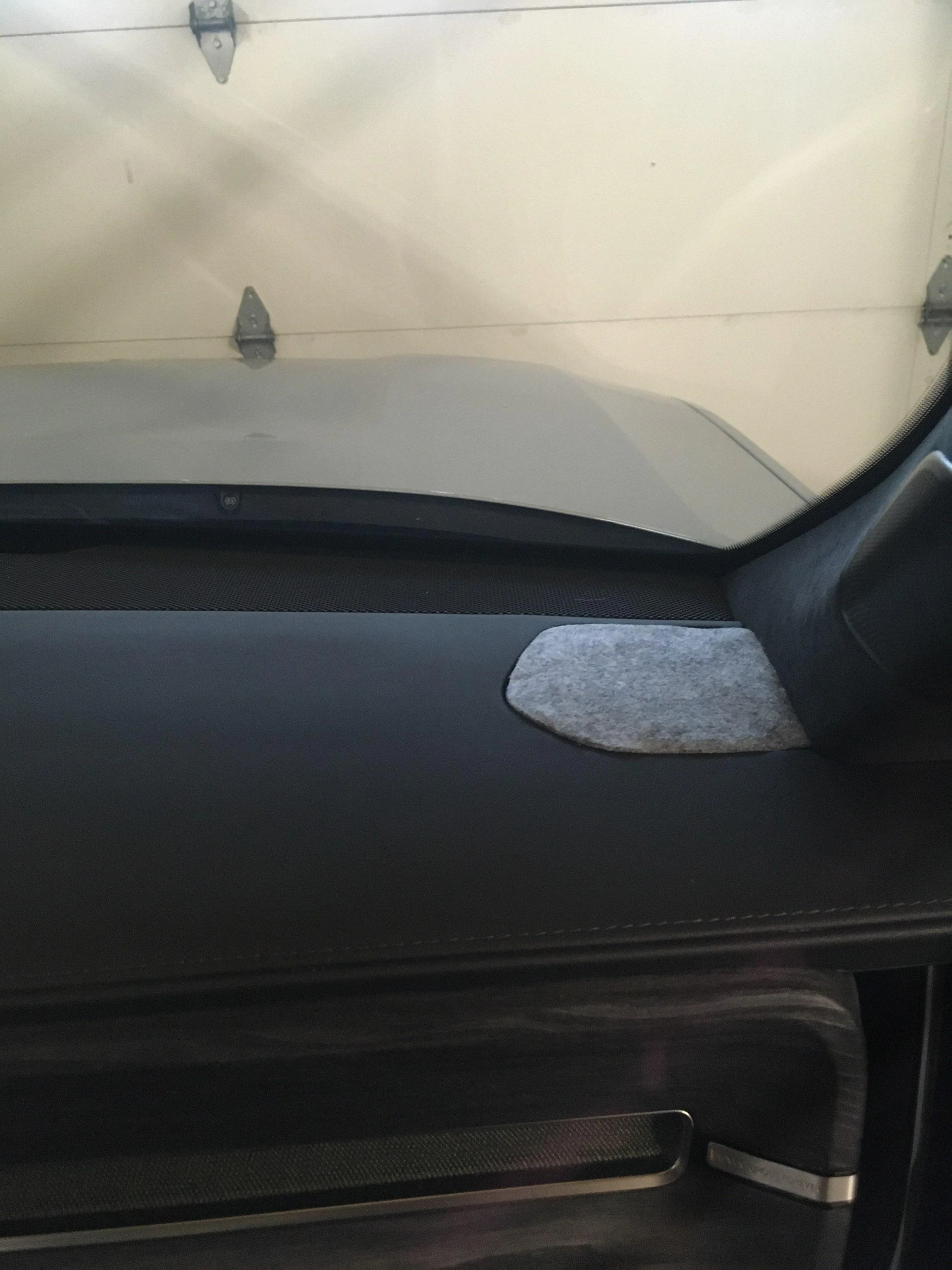

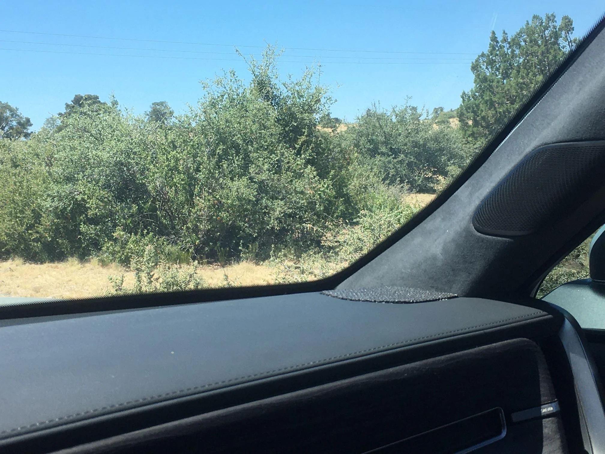

So, Here's my Rev-B: Shelf liner held in place with two-sided tape. Needs a little trimming, but we'll leave that for Rev-B/2.
Rivian R1T R1S Matte PPF for dashboard A-pillar speakers? IMG_2533
The shelf liner appears to hold on to the two-sided tape much better than the felt did, so I'm confident it should stay in place at speed with the windows open.
I'l take it for a ride later and let those of you who care, know how it works.

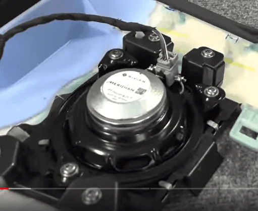

PS I will probably be taking all these speakers off in the coming days as I have tons of rattles that are driving my OCD crazy. If these end up being just clip ons, powder coating them or similar might actually work, not sure as I don't have experience with paints but sounds plausible.

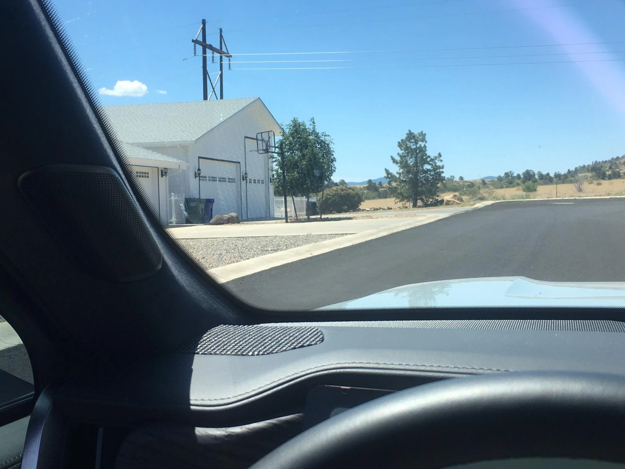

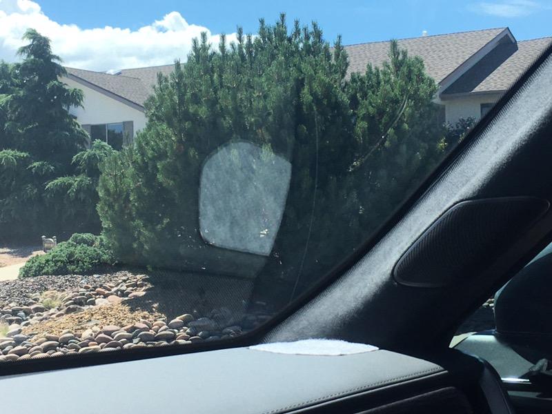

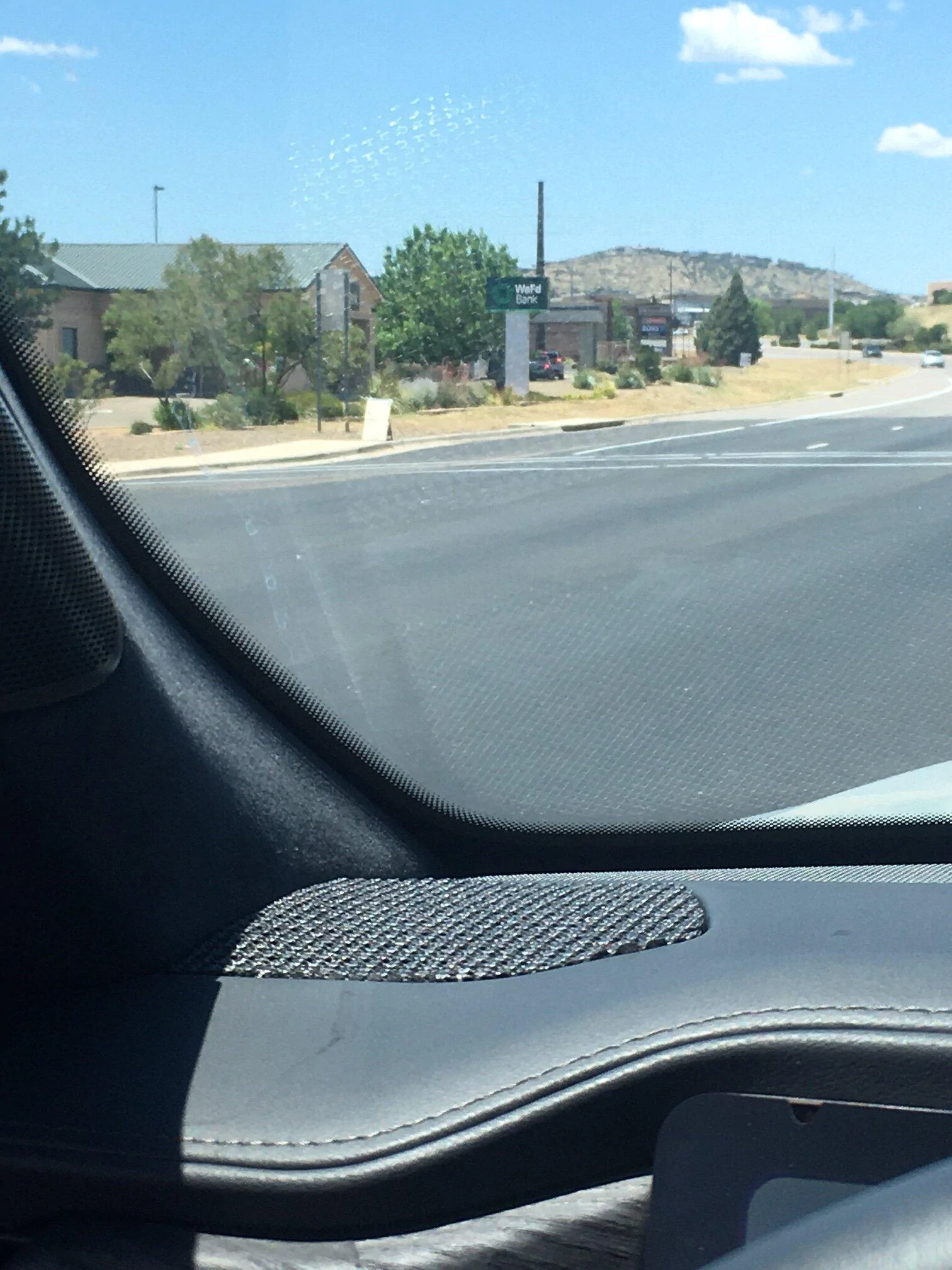

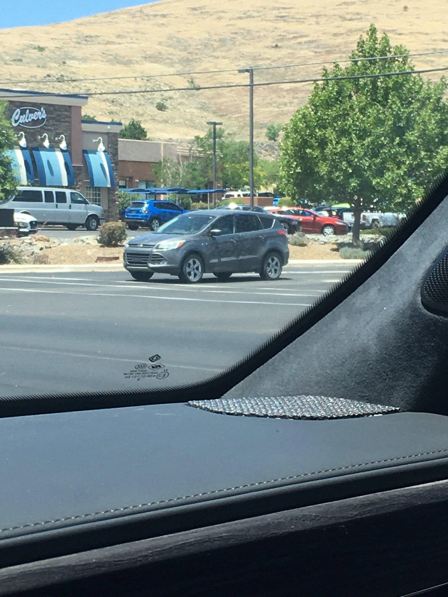

Rev-B results: Huge success!
Rev-B = black perforated shelf liner (Walmart bought Easy Liner Select Grip) using 3m two-sided tape on the straight parts of the perimeter of the speakers.
If you look really, really, REALLY hard, you can see the faint reflection of the speaker grills. In no way does it stand out while driving. Ta-Dah!!

The struggle isn’t real and the “solution” takes away from the beauty of the grilled. Hopefully you have calmed down now.
