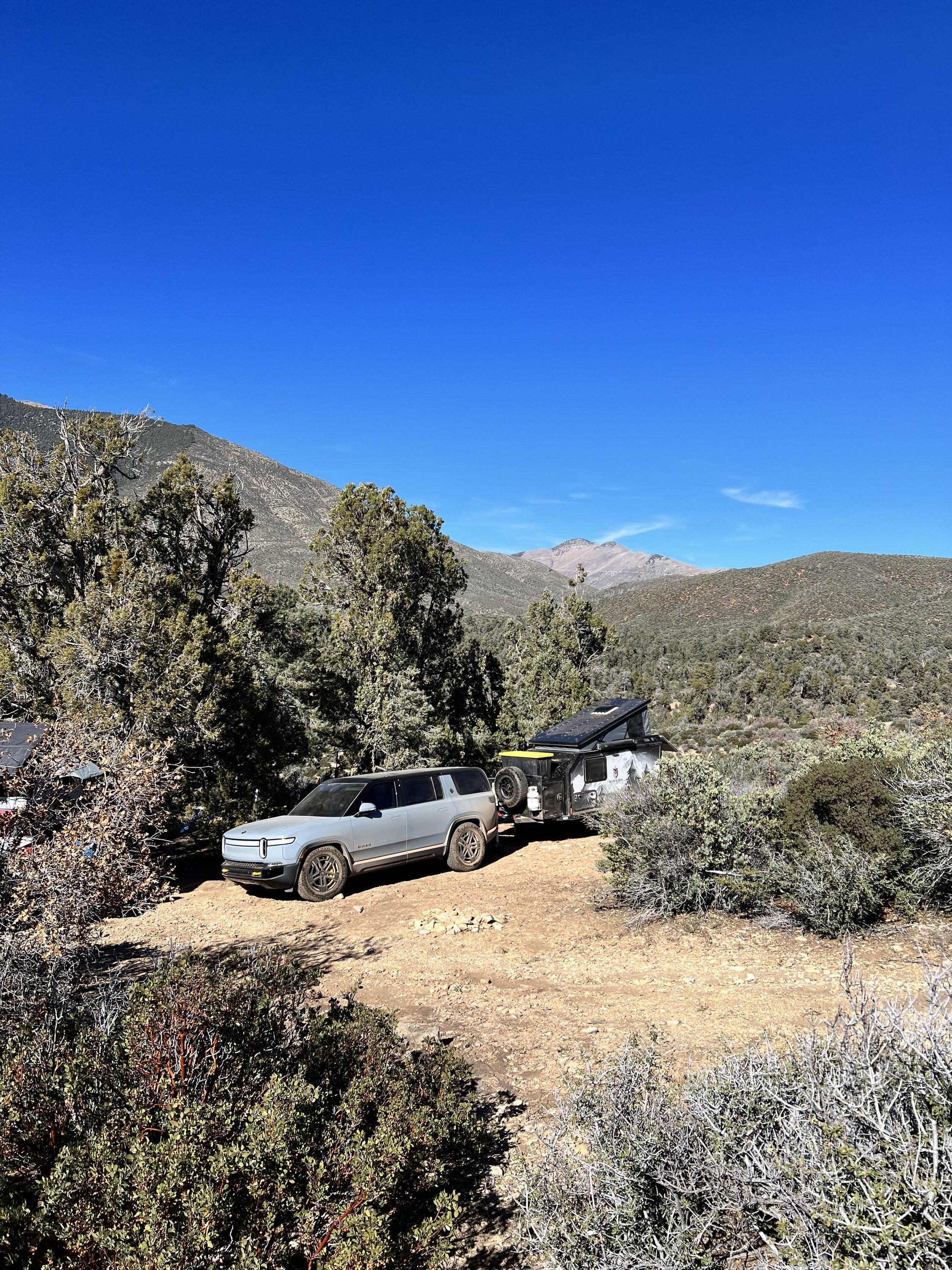

went camping this weekend and just thought to my self that Rivian should make a connection to be able to hook up a solar panel
so you can charge up a bit for extended camping trips
has anyone done this? maybe with a redarc bcdc?
