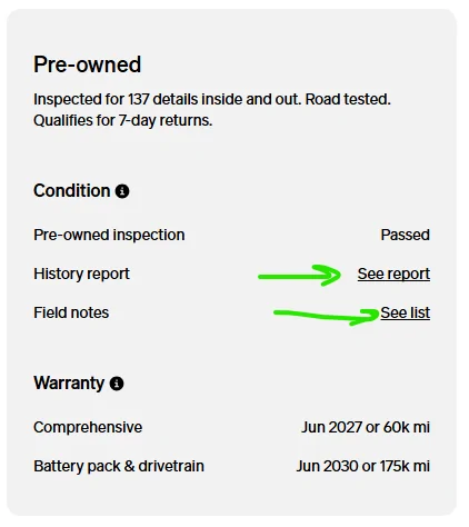

If you buy pre-owned from Rivian, they'll give you all the details you need to know (carfax, which includes VIN)
Rivian R1T R1S List Of Options 1767332245863-ft
