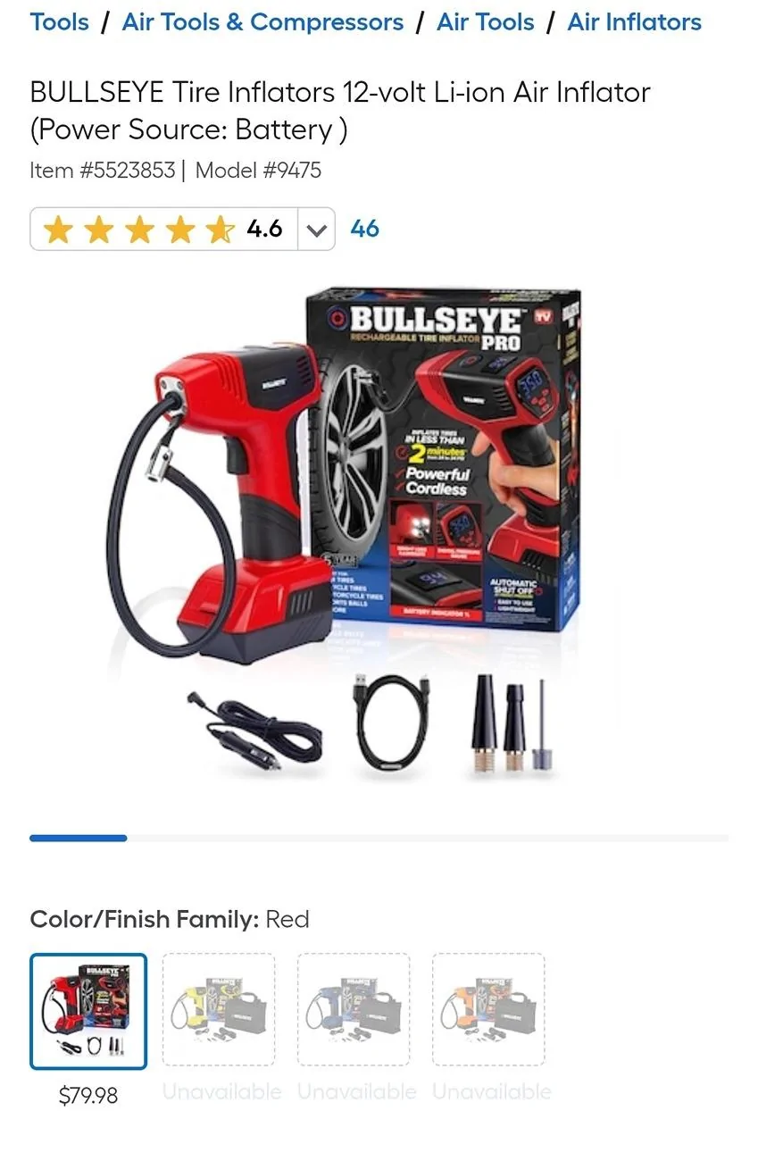

You asked, I answered. If you don't care about the answer, why ask?
Rivian R1T R1S Jacking Screenshot_20250526_124257_Edg
Have fun running an impact wrench with this...

I will concede that the lift bag has a potential of working.

Air tools tend to require steady pressure, i.e. compressor with a pressurized tank. The accessory compressor does not fit the bill. Unlikely it will work. But you’ll find out soon enough. And the longer you run the compressor, for tools or air jack, the more likely you’ll overheat it; leading to it shutting down to prevent catastrophic failure. Also, that Vevor jack probably doesn’t have enough lift height for the rear.

Even if the onboard compressor does work, you are going to absolutely smoke its life expectancy. I would not expect Rivian to honor a warranty on the onboard compressor if you're misusing it for these sorts of applications.
Even ARB themselves do not recommend using their 100% duty cycle twin compressors for air tools or jacking. They always recommend using a reservoir that can smooth out the load on the compressor.

Just for reference, it took me just over 5 minutes to inflate all 4 of my tires from 38psi to 48psi with the onboard compressor. While I love the feature and convenience of it, it's definitely meant as a tire inflater and not a compressor for pneumatic tools.
Also, the idea of using the onboard compressor for inflating an air jack seems like a lot of time spent standing and waiting for it to inflate. All the 5* ish reviews for the tool are based on users with a reservoir style compressor, filled to around 150psi, throw the lever, and your truck is off the ground near instantly.
