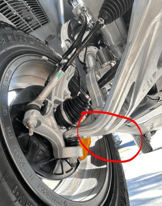

I've assembled all of the equipment for a wheel and tire change - spare set of wheels and tires, jack pucks, jack, jackstands, lug nut tools, and even a nice, thick knee pad. There's a special spot to insert the puck and jack up the vehicle but no provision for a jackstand. wtf?

Put jack under lower control arm with rubber puck to protect aluminum, use jack puck in factory jacking point to place jack stand.
That is how quite a few Rivian field service techs do the job.....it's pretty straight forward.

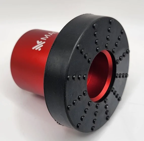

jackpucks.com
R1T Launch, R1S Canyon Red
Lucky to have a DIY garage in my area where I can pay by the hour to use their professional lift. Easy job with all 4 wheels lifted at once. (Need 4 pucks to do this.)
This is hands down the best way to rotate tires—on a standard commercial lift. A few Rivians have slipped off flat-plate lifts when using metal pucks without a rubber base. All it takes is a little fluid on the lift, and suddenly, it’s game over.
That’s exactly why I went with our super sticky rubber caps—because a secure lift shouldn’t be a gamble.

It's pretty straight forward.. jack it up using the pucks and locate the jack stands under the control arms, or... jack it up by locating the jack under the control arms then place the pucks/jack stands under the frame jack holes.
The main advantage of jacking it up by locating the floor jack under the control arm is that you only need to jack it up one or two inches as the suspension is already compressed.
