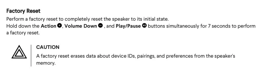

I know, you can laugh at me, but we actually use the Camp Speaker a lot! Mostly for playlists for exercise, but sometimes for camping too. However, though it’s worked fine for 15 months, my iPhone 13 now can’t connect. I’ve restarted the speaker and my phone. It was all fine until I updated to iOS 17.0.3. Any of the few folks that do use the speaker upgraded to iOS 17 yet? ?

I used it yesterday with my iPhone 15 Pro and iOS 17.0.3. But it was acting wonky at first. I had to reset the camp speaker and re-pair it.
Thx, hadn’t done that yet but it’s on the list!

I have an iPhone 14 pro max, had an issue connecting the other day. I told the phone to forget that Bluetooth connection, then reconnected, it resolved my issue.

fwiw, worked fine for me this morning on ip 13 and 17.0.3

FWIW, It’s working again, after 2023.38.0 update. Was a solid reproducible fail every time before the update…

Mine has been very very weird lately. I have an iPhone 14 Max Pro and use the speaker a fair amount as well. The last few times it won't hold the connection. I have reset it and restarted the phone. Forgot the device and when it finally links up it immediately dropped the connection. It happened to my friend's phone as well trying to grab the speaker.
I was going to call Rivian on this and as sad as I am for you as well. I'm happy I'm not the only one

See my post from earlier this evening, mine is working fine again after the 2023.38.0 update

Thanks. I have already done that update and it has done nothing to fix my issue sad sad sad

I had to forget the Bluetooth setup for the camp speaker on my iPhone and reconnected, seemed to work fine after that.

Thanks. I have done that several times. I’m just at a loss at this point.

I assume you did the reset on the camp speaker as well.
