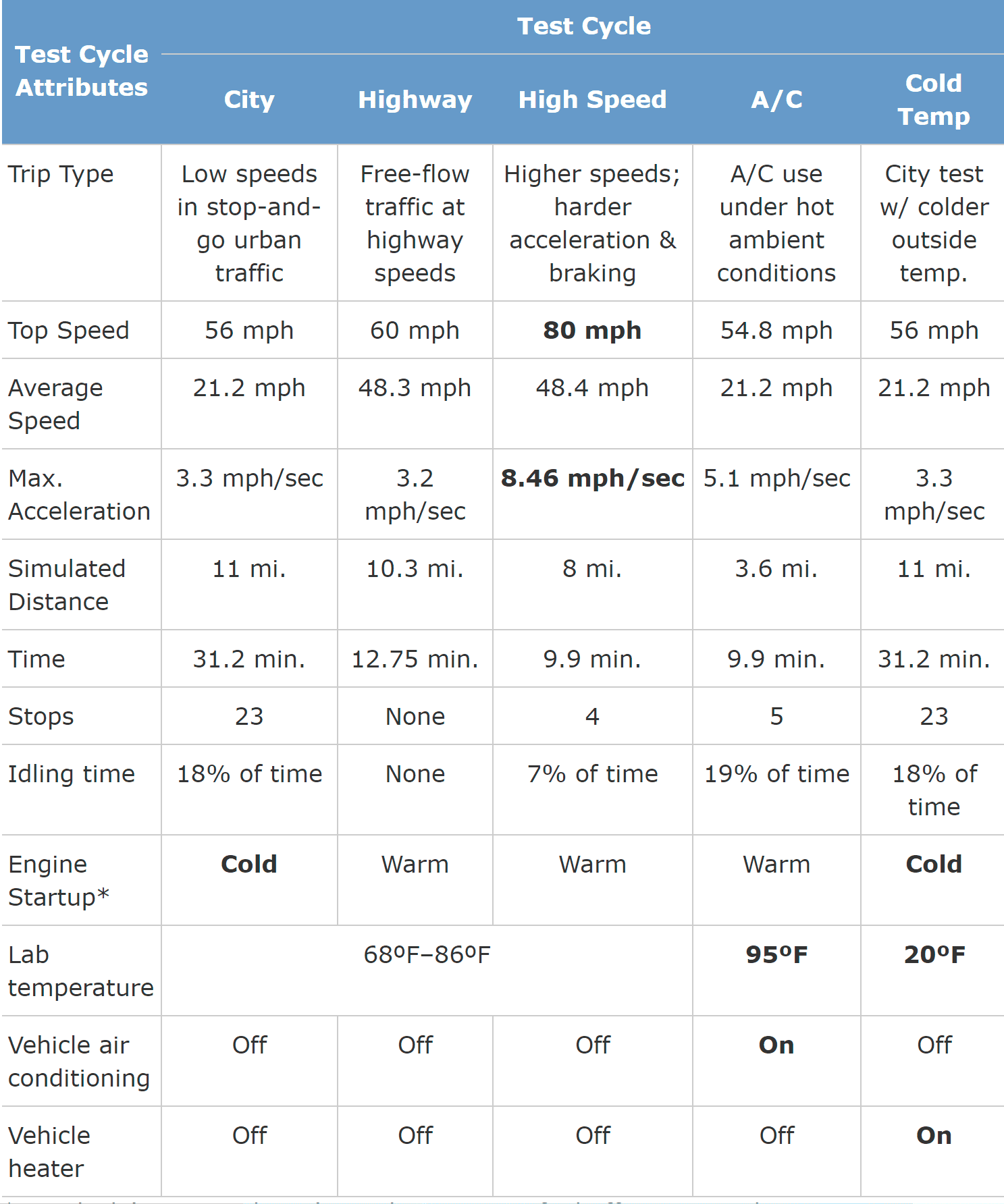

They could start by using the same test cycles for all manufacturers and not allowing them to choose between different test cycles leading to a mismatch when comparing BEVs.
They do use the same tests for all manufacturers. All are required to run the UDDS 30 and Hwy test.
Manufacturers may elect to run additional tests ("high" speed, hot and cold weather) that will (in theory) give a more accurate representation as those tests will yield lower range.
Rivian R1T R1S How close do you think real world range will be to EPA range? 1615935075146
If they elect to use the 5 cycle test (Tesla is not the only manufacturer to do so - Audi , Bentley, BMW, Chrysler, Ferrari, Kandi, Karma, Kia, Mitsubishi, Polestar, Subaru, and Toyota also used it on 2021 models)
If they use it, they have the option of submitting documentation to justify a custom derating instead of the standard 30%. Some do, some don't. If Porsche did, they might be able to put a more accurate number on the labels for the Taycan models. Audi uses 26% on the e tron.
Exactly my point. The results are not comparable when they can choose which tests are included.
Choosing to use additional tests is the same thing as not using the same test. The same test = the same test (no additions and no deletions).
ie. I took the same SAT test, however I chose to add additional tests - finger painting, coloring in the lines and barn animal identification. Once I factored in those results, my score went way up.
You can always look up the results of the 2 cycle tests (UDDS and Hwy) and multiply by .7 if you want. This will allow a direct comparison between any 2 vehicles

That is just simply absurd!
How so?
It will give you the consistent testing results (apples to apples) you are looking for.
All the 2 cycle results use the 30% derating, so applying that to the 5 cycle vehicles will give you the comparison (same tests) that you asked for.

How so?
Because that would require the typical EV buyer to:
1) Know how EVs are tested to a very high level
2) Know that the test reports behind the EPA ratings are available
3) Know where to find the test results
4) Be able to read the submissions (they are all formatted differently)
5) Do the math to come to a base number for each vehicle they might consider
Not only unrealistic, but simply absurd to think that but a tiny number of people would actually do this!
Or, they could have all BEVs use the exact same tests (no more tests and no less tests than anyone else) and then publish comparable numbers with the exact same adjustment factor.
As a second step, they should develop a new test method that does not have a margin of error of 30% (or more) requiring a 30% adjustment to come closer to reality.
