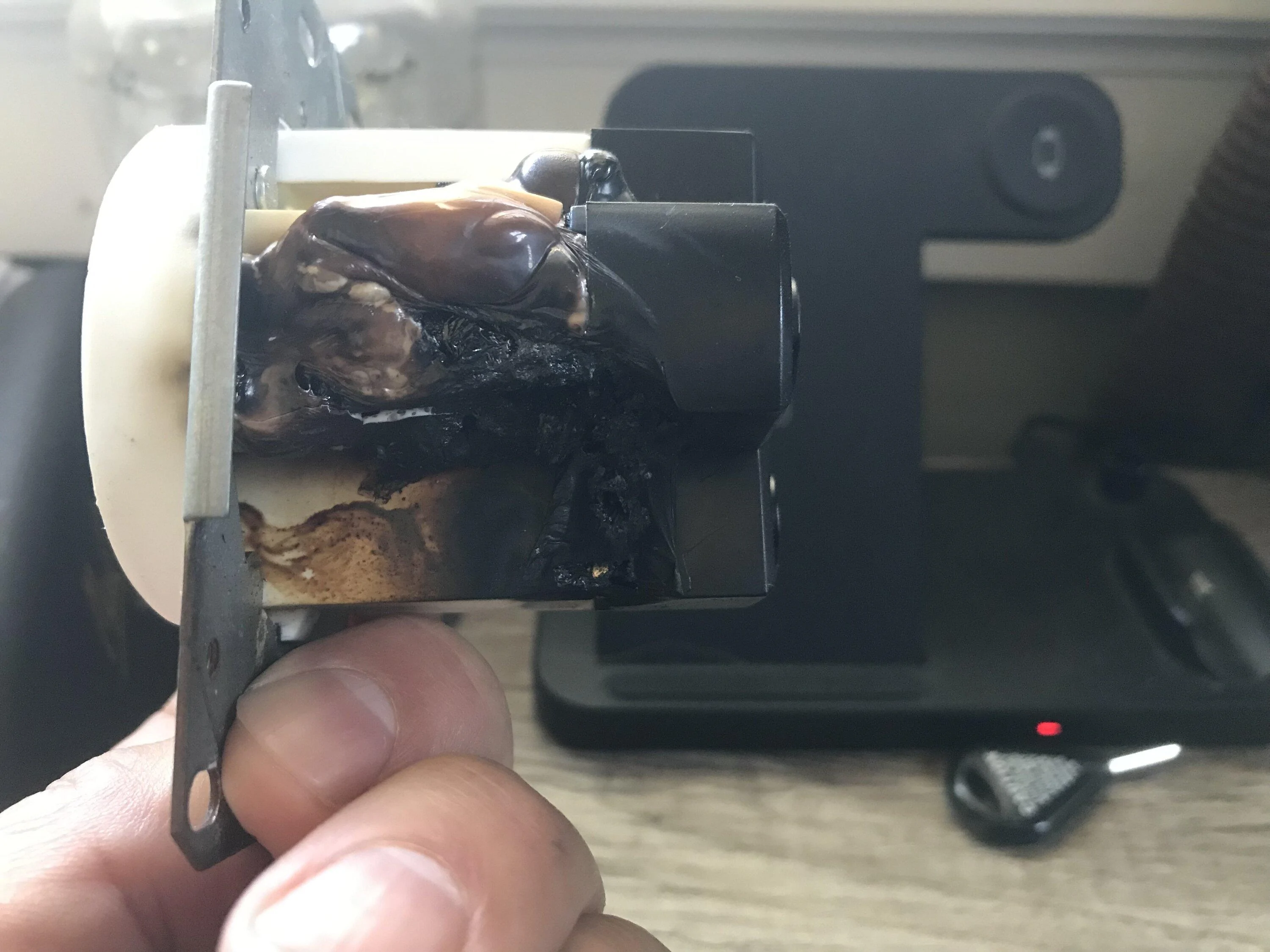

As others have said - go hardwire.
Here’s a picture to give you a good sense of why I’m personally adamant about it (now).
Me too, lucky I did not have a fire. I had a wire that was loose going to the plug in the wall and completely melted. Apparently the electrician did not torque the screw properly, or it vibrated loose.
