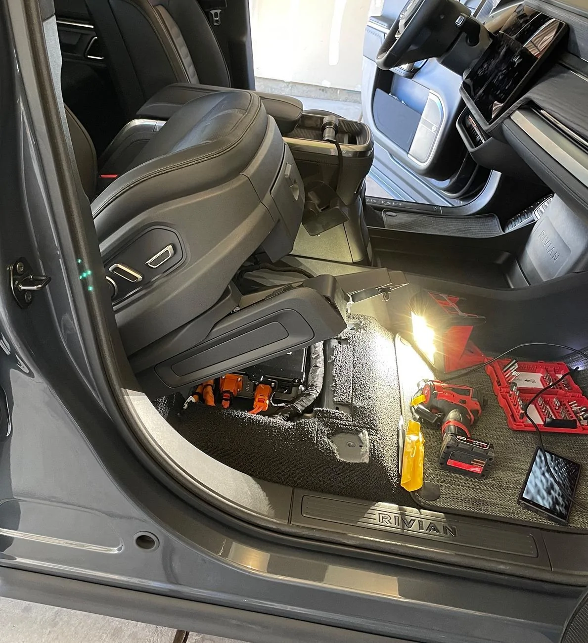

I couldn’t have guessed that my first post on these forums would be to thank everyone here and on Reddit for information on how to find and retrieve a missing ring. We were about 24 hours into ownership when my wife’s ring fell into the abyss.
We were on a road trip picking up the R1T so after getting home we unbolted the passenger seat, removed the plastic panel on the floor and with an endoscope located and retrieved the ring.
My only tip (can’t recall if it was said above, is to tilt the seat back forward so that the entire seat tips farther back giving you more access. Also, don’t be discouraged when you first try to unbolt the seat with a small socket wrench. The bolts are really torqued tight - I needed a breaker bar to loosen them.
Big thanks to everyone who posted about this!
Rivian R1T R1S Help! Diamond ring disappeared between drivers seat and center console! IMG_4637
Edit: added a photo of the raised seat and plastic panel

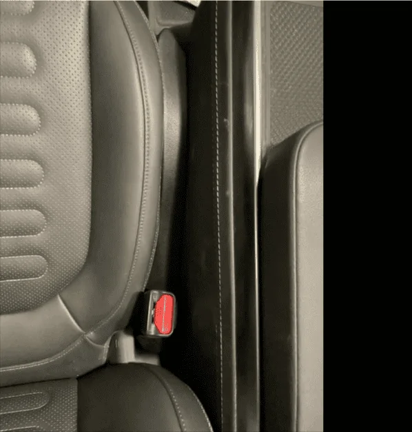

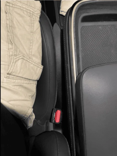

I accidentally dropped my ring between the driver's seat and the center console. In trying to retrieve it I pushed it further into a crevice where the carpet actually splits. Anyone have any ideas on how I might get it? Or does anyone know how to remove the seat?
