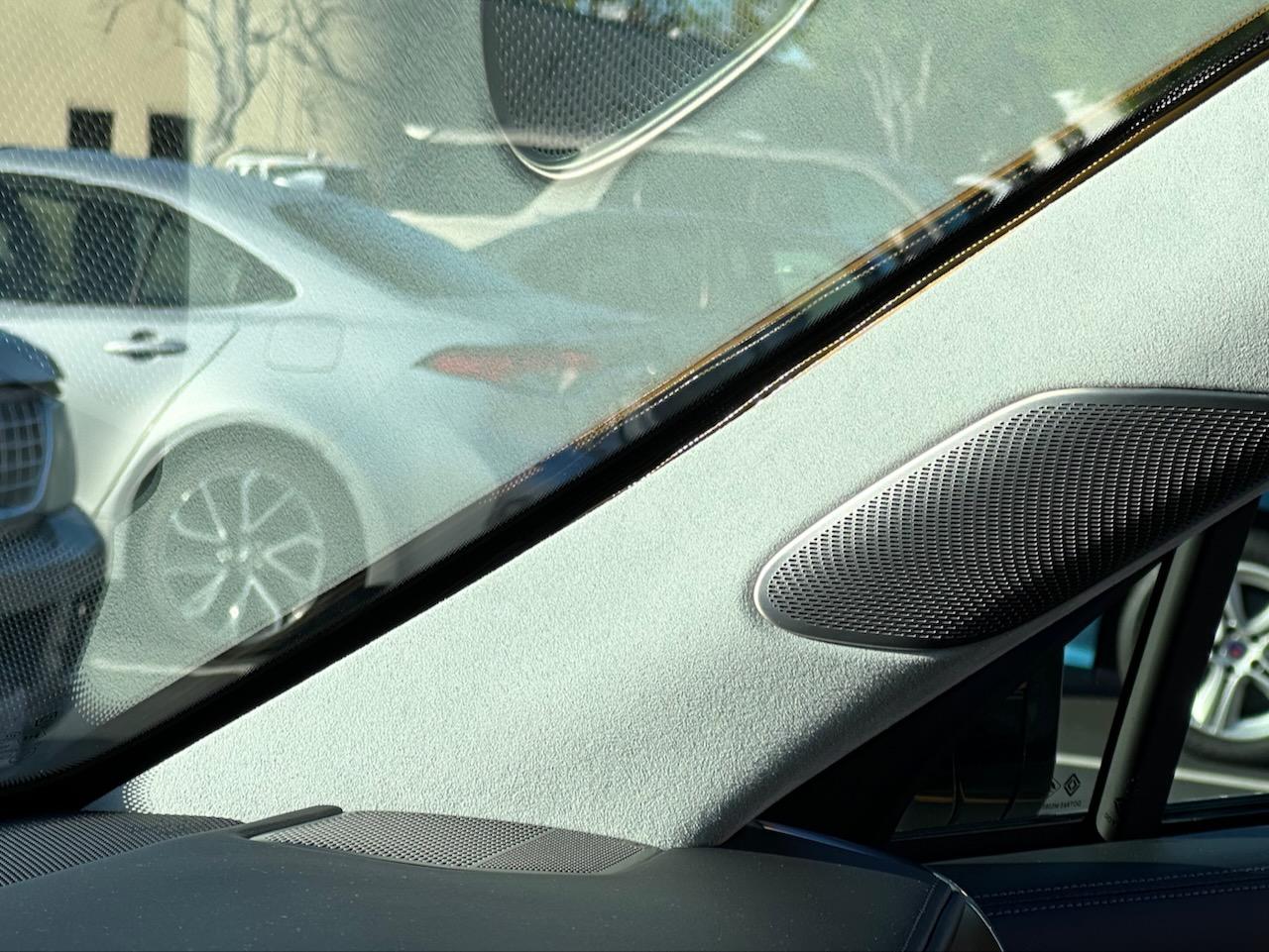

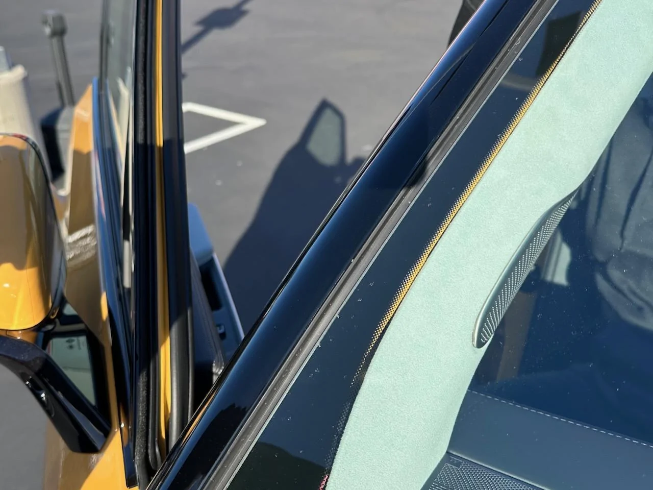

I've noticed that the interior liner on the passenger side A-pillar is revealing body-colored framing between the liner and the windshield. Normally this wouldn't be an issue, but I see it every time I look at the A pillar (sort of a "can't unsee once seen" things).
I've decided to add it to my service ticket, though I'm not sure what Rivian is going to be able to about it (except make the issue worse). There appears to be some sealant squeeze-out as well
Anyone experience the same issue? Pics below for context:

Did you ever have your windshield replaced?
(I had access glue from the windshield replacement that needed to be cut off for the trim to fit better)
Have you ever been in for service previously?
(There's a recall where they take this pillar off to fix some clips related to the airbag and they do this without telling you ahead of time. It should be on the work order though. Maybe they didn't clip everything all the way back)

Nope and nope, but I don't know what was done with the vehicle before purchase (new).

Both my S and T are the same. It's more noticeable on the T as it's white.

My R1T is at the service center for a number of this, including this. We'll see if they can address it.

Quick update:
Truck is still at the service center. They had to take the windshield off, and *weld* a seam together along the A pillar due to poor assembly at the factory.

Got my truck back on Friday; issue is fixed! Service center replaced the liner and windshield as part of the process.
I noticed that the passenger side windshield wiper wasnā€™t working after pick up. Good thing I had one of those bolt-tightener thingies (I think they are called wrenches) in the garage. I can confirm I was able to tighten the arm to the pivot shaft. As good as new!

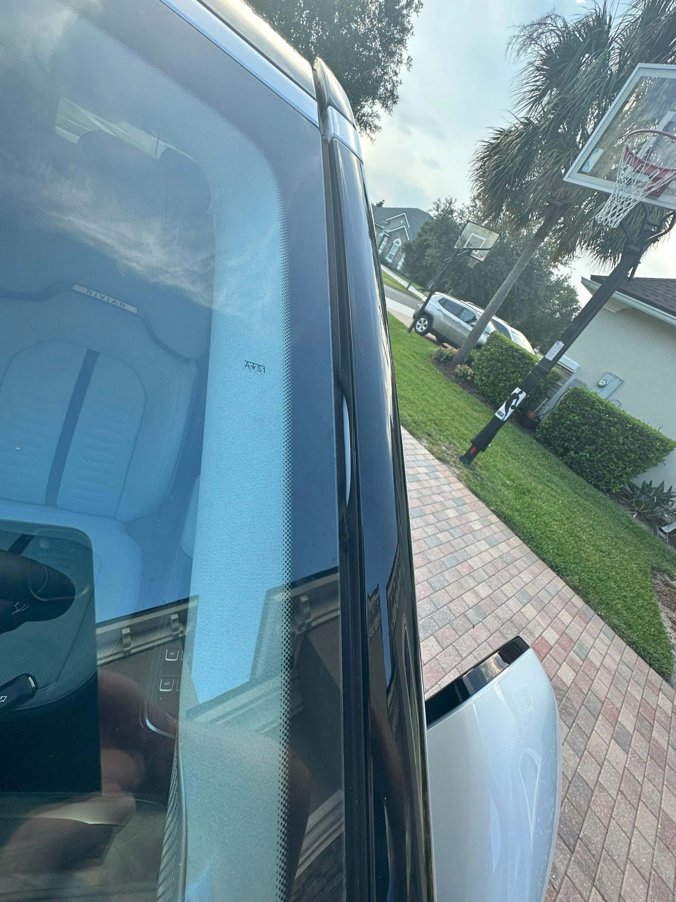

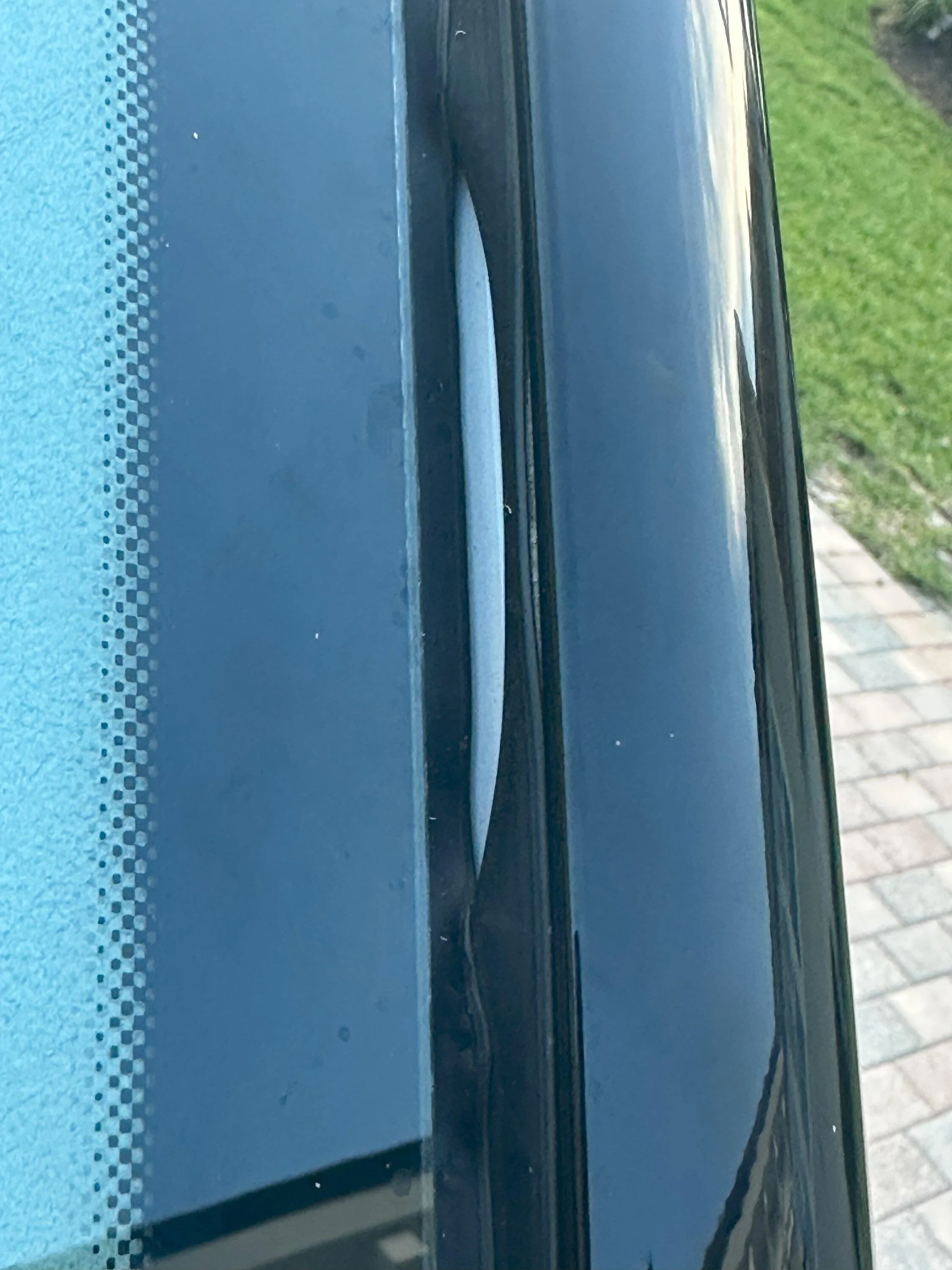

I found something similar on mine, driver side a pillar, seeing body paint through what should be windshield seal, but mine is on the outside and probably contributes to wind noise. See photos. I added this to my service center list. My call center technician said they'll fix this no problem, even if they need to pull the windshield and replace the seal.
