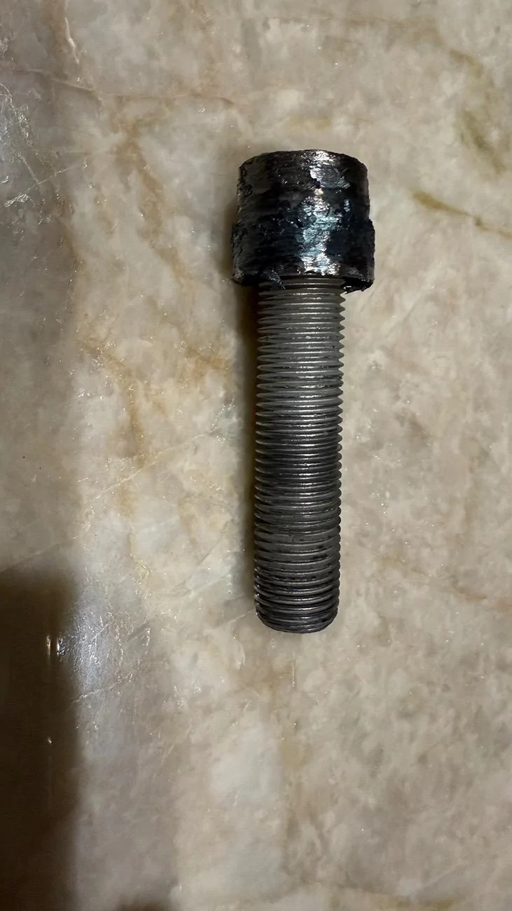

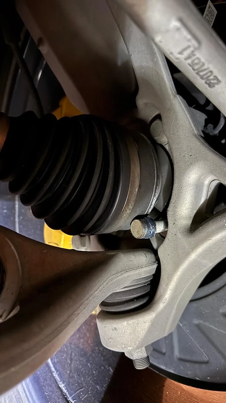

I had a squeal last night. After reviewing this forum a bolt on metal made sense. I was able to take mine out the rest of the way with my fingers. Obviously, there is no thread lock on it.

Everybody with an R1 should be checking this at least every time you rotate tires. It would be good if Rivian would release what the correct torque spec should be.
It’s easy enough to check once you know what you are looking for.
Imagine the number of emergency tows, service center back logs and rental car reservations that could be saved. Not to mention, pissed off owners like me.

I actually bought a replacement 10.9 grade 12X1.25X50MM bolt. I didn’t want my truck inoperative while I am waiting for service.

Don’t forget a dab of loctite!
