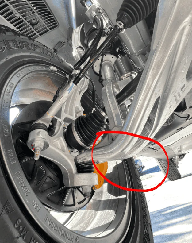

Very interesting. If you happen to have one, it would be great to see a picture of where on the lower control arm that is a good spot, just so I don't do anything stupid.

If you use the control arm you can also use jack stands (if one desires), since the port for jack pucks would be available. Put a block of wood on control arm to protect it.
Picture from another thread.
