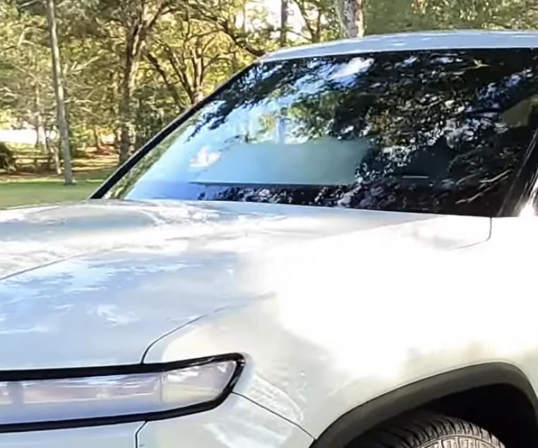

Is this what you’re talking about? I snap-shotted this off some YouTuber’s video. Looks like you’re not alone.
Yup that’s exactly it.
