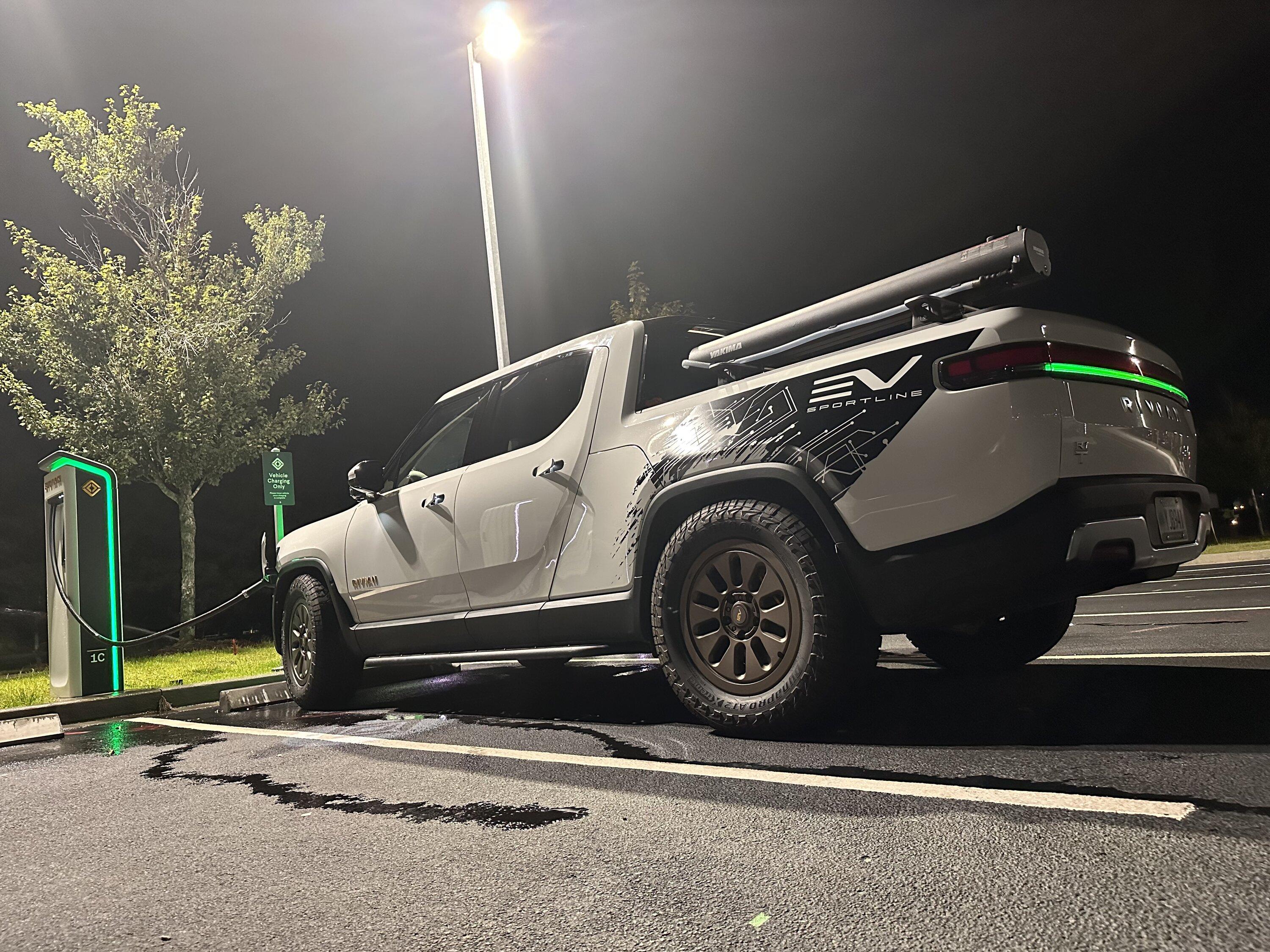

I’ve been riding around with one the original prototype sets for 9 months and no rust in Georgia. I can attest that they are not using a cheap Chinese coating as they are made in the USA.?? You probably just got a bad set, I’m certain they’ll make it right.
Agreed. Probably a bad set or two that slipped through as they rapidly ramped up production to meet pre-order demand.
