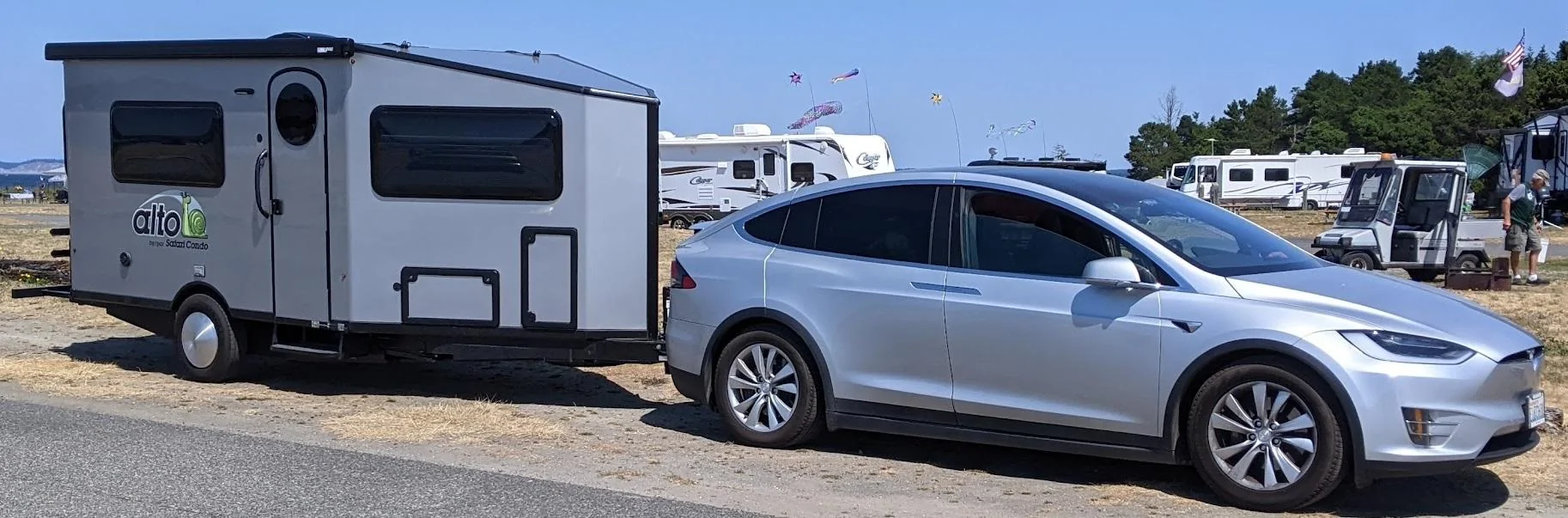

We don't have our Rivian yet, but we've successfully charged our EV from 50A outlets at Fort Flagler, Deception Pass, Seaquest, Millersylvania...and, uh, several others but I'm not good at recalling exactly where.
The 50A outlets are 240V. The 30A outlets are only 120V, so quite a bit slower, but there are places that have 30A but not 50A, so it's still a good option to have.
We tow a Safari Condo Alto A2124 that is 21' long, about 3,000lbs and pretty aerodynamic. It has a kitchen, bathroom with shower, almost king-size bed, and a separate dinette. More details in THIS thread.
At Fort Flagler:
Rivian R1T R1S Electrical hookups, WA State Parks PXL_20220728_195726433
