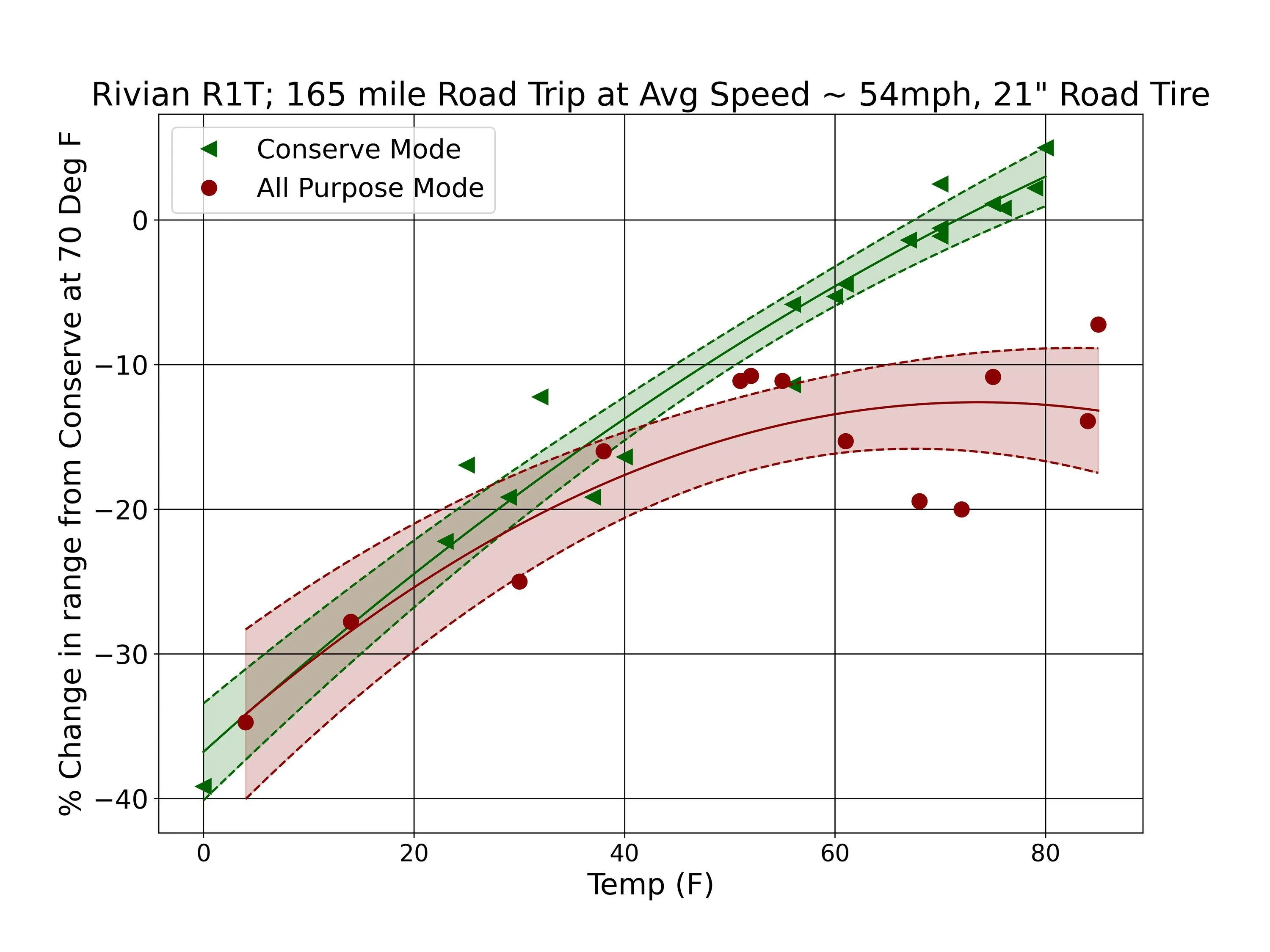

I forgot about this update!
So it diverges at 40°F. Now the question is, what are the individual impacts of conserve and ride height? I imagine conserve is the bigger difference, but you know what happens when you assume... (Spoiler alert: you get married after 9 months of dating and regret it until your divorce)
Here is an updated chart showing percent change in efficiency vs temperature. Hopefully this is representative at different traveling speeds.
Cross-posting but I'm seeing pretty good efficiencies with a warm battery! We opted for conserve/low to be safe, and it helps compare stock ATs to the Ram 2363 AT build I have now. I had to plug in 2.35mi/kWh in ABRP compared to using 2.2 with stock ATs in winter to match our first leg's consumption. Started with 100% and 94°F battery with 45°F outside before the elevation gain, now across the pass it's been 34°F.
