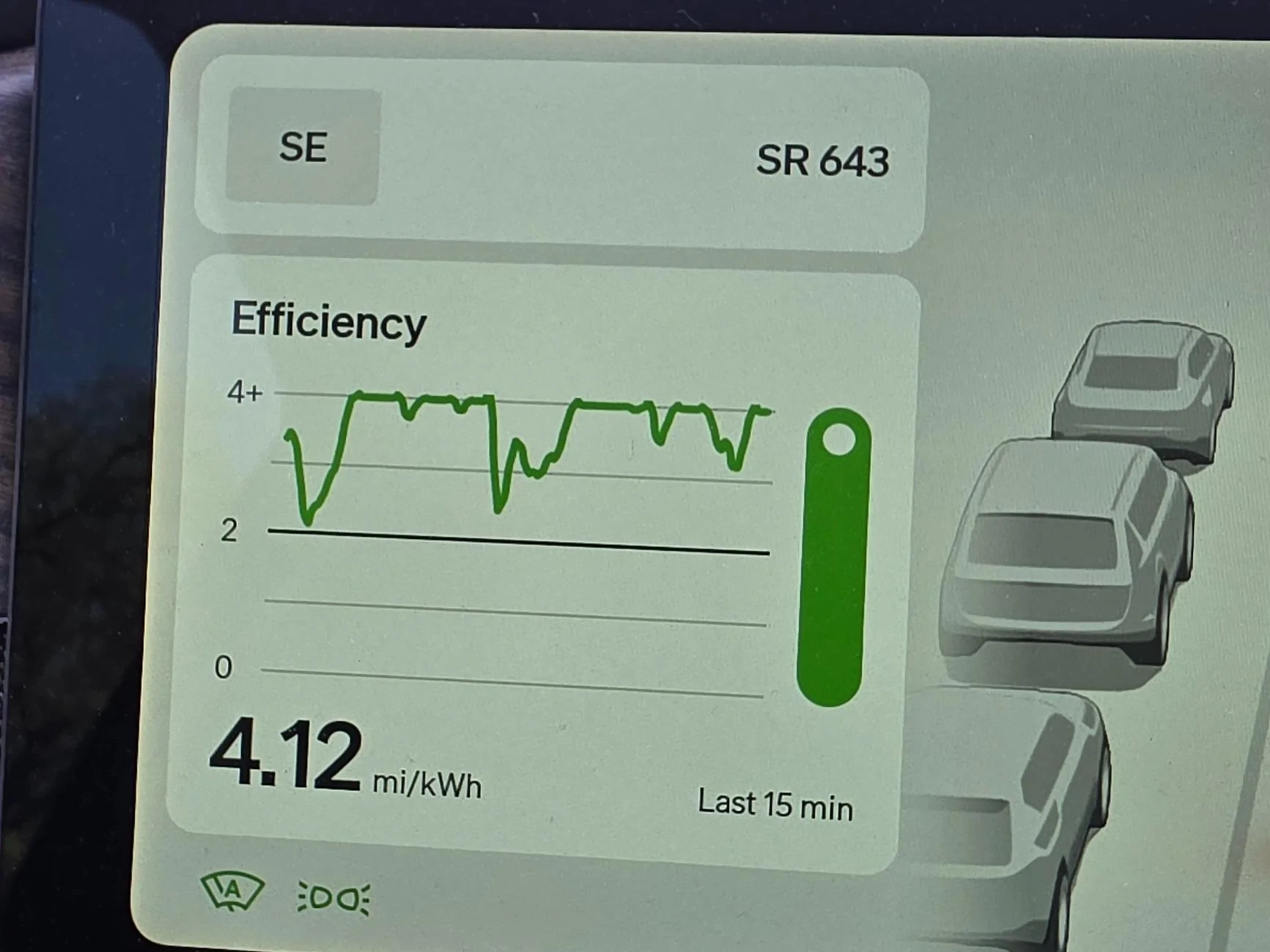

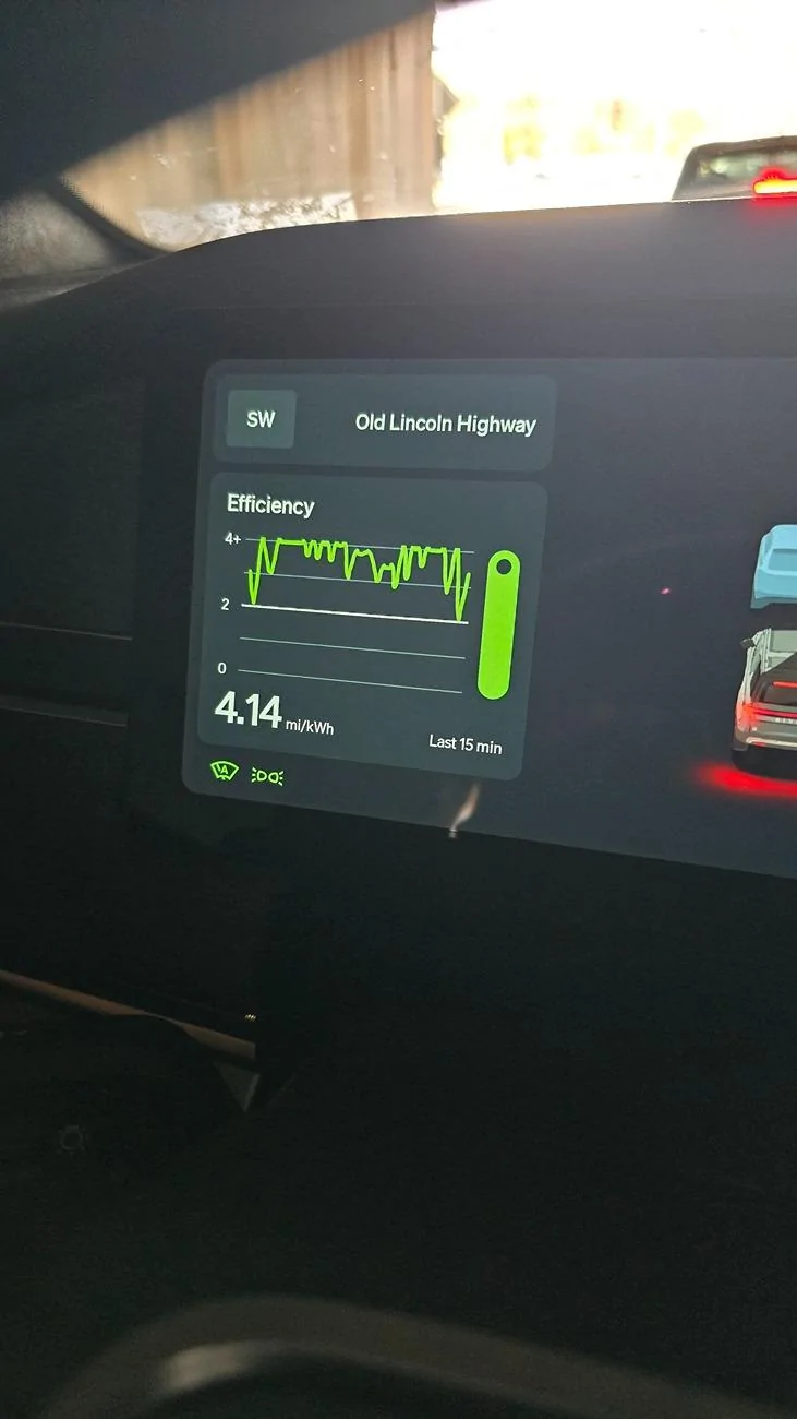

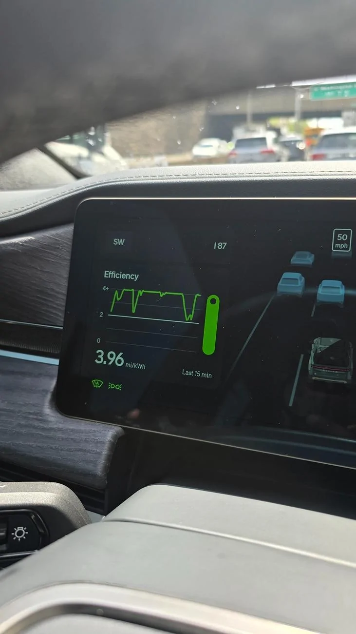

Whether the efficiency based on time (regardless of speed, distance, elevation, etc) and the efficiency based on distance (regardless of speed, time, elevation, etc) "match" is a mathematical question, the answer to which you haven't provided enough data.
I'm not a mathematician, but i respectfully disagree. how can the average efficiency based on distance be significantly lower than the lowest instantaneous efficiency based on time for the same distance/time period... that just doesn't make any sense.
my point was, they have more or less matched in the past, at least directionally. since the last update or two they have diverged significantly. I have 20" AT's and my "instantaneous" effeciency is now consistently above 2 and sometimes gets pegged at 4+ for long stretches.... although i wish it were true, that's just not real. Something changed with the way the graph calculates the instantaneous mi/kwh and it seems to be artificially high.

Not to bring up a slightly old thread, but I agree that the last update 2025.1 absolutely changed the GOM calculations. When sitting still in drive (red light, parking lot, car wash, etc) the efficiency goes up to 4.0 (and I am thinking it's actually infinity) and that's being calculated into the previous 15 minutes. It's not right and I'm hoping it's being addressed in this new update.
Driving habits... EPA Estimate... I don't care, just want it to be close to accurate.
