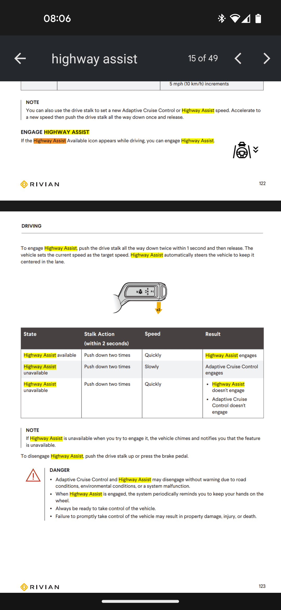

I am a new owner. I drove I-5 from Seattle to Canada yesterday and did not see Driver+ become available at all. Where should I expect to see it? Does Rivian have a map available?
Driver+ is everything. Are you talking about Adaptive Cruise Control (ACC) or Highway Assist?
This is where I have used it 75% of the time. It works on I-5 all the way from Seattle to the border without issues for me. I just pull the stalk twice to turn it on the moment I get on the freeway.
I tried it coming south yesterday and it worked. Thanks.
