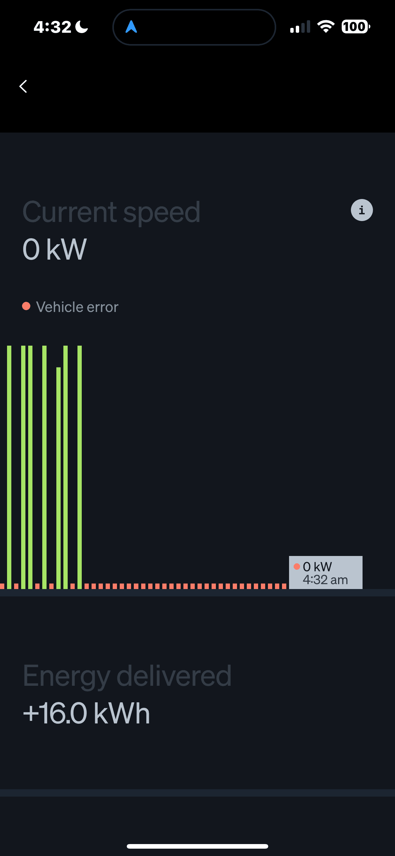

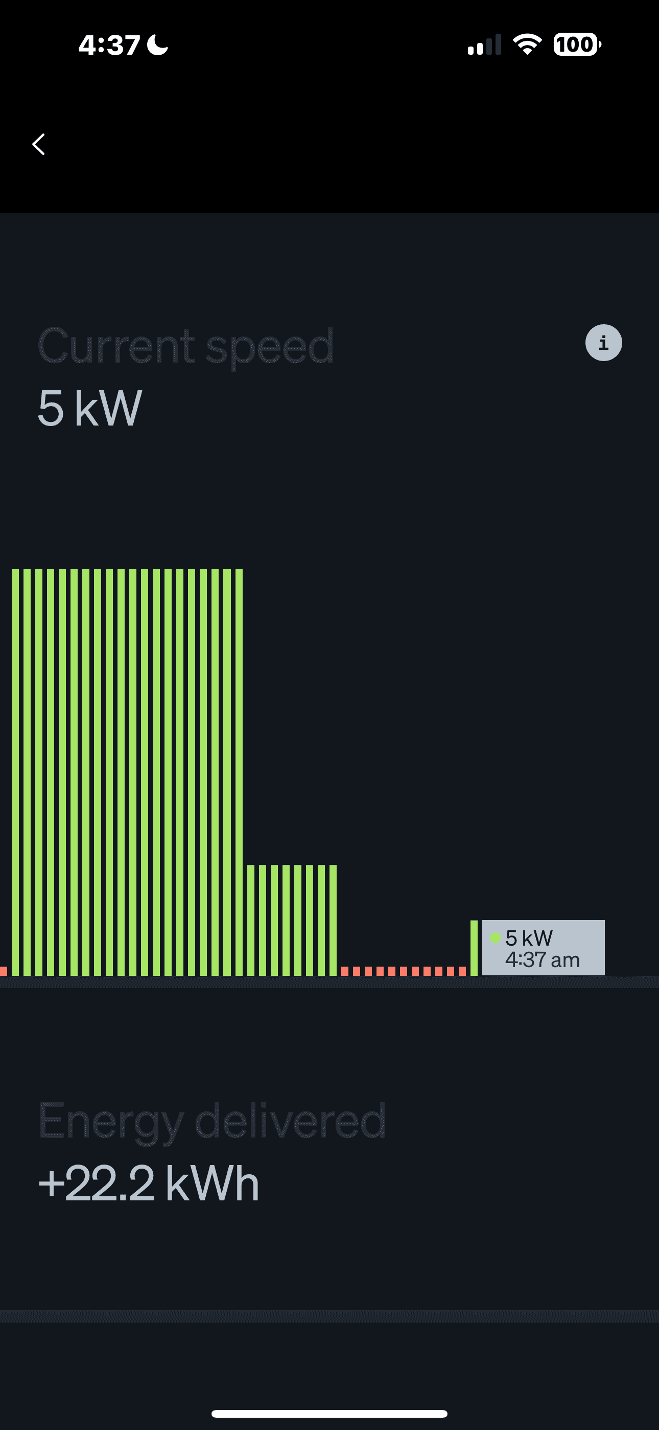

A quick update for others with this same problem. I've been having the issue where a "vehicle error" is triggered while level 2 charging at my home. The truck will charge for a while, then throw a "vehicle error" and stop charging. All I have to do is either walk by the truck or even just open the app and wake the truck and it will start charging again. I have only seen this issue with level 2 home charging - not with level 1 (plugging the Rivian charger into a regular 120 outlet in my garage), nor with DC fast charging. I've been in touch with CS several times over the last two weeks sharing details, screenshots, sending diagnostics, etc. I spoke with Rivian Customer Service yesterday, 5/21/23. This is a known issue that will be fixed in an upcoming software update. The issue has something to do with the truck throwing a vehicle error when the truck enters a sleep state (or something like that). The helpful customer service rep told me that if I turn off proximity sensing for my phone and key fob that this might help, or, alternatively, I could leave a key fob in the vehicle, or potentially buckle one of the seat belts which will make the vehicle think someone is inside. For me, I'll probably just leave a key fob in the truck while charging in my closed garage and see if that fixes the problem. Just sharing these details in case anyone else is having this issue -

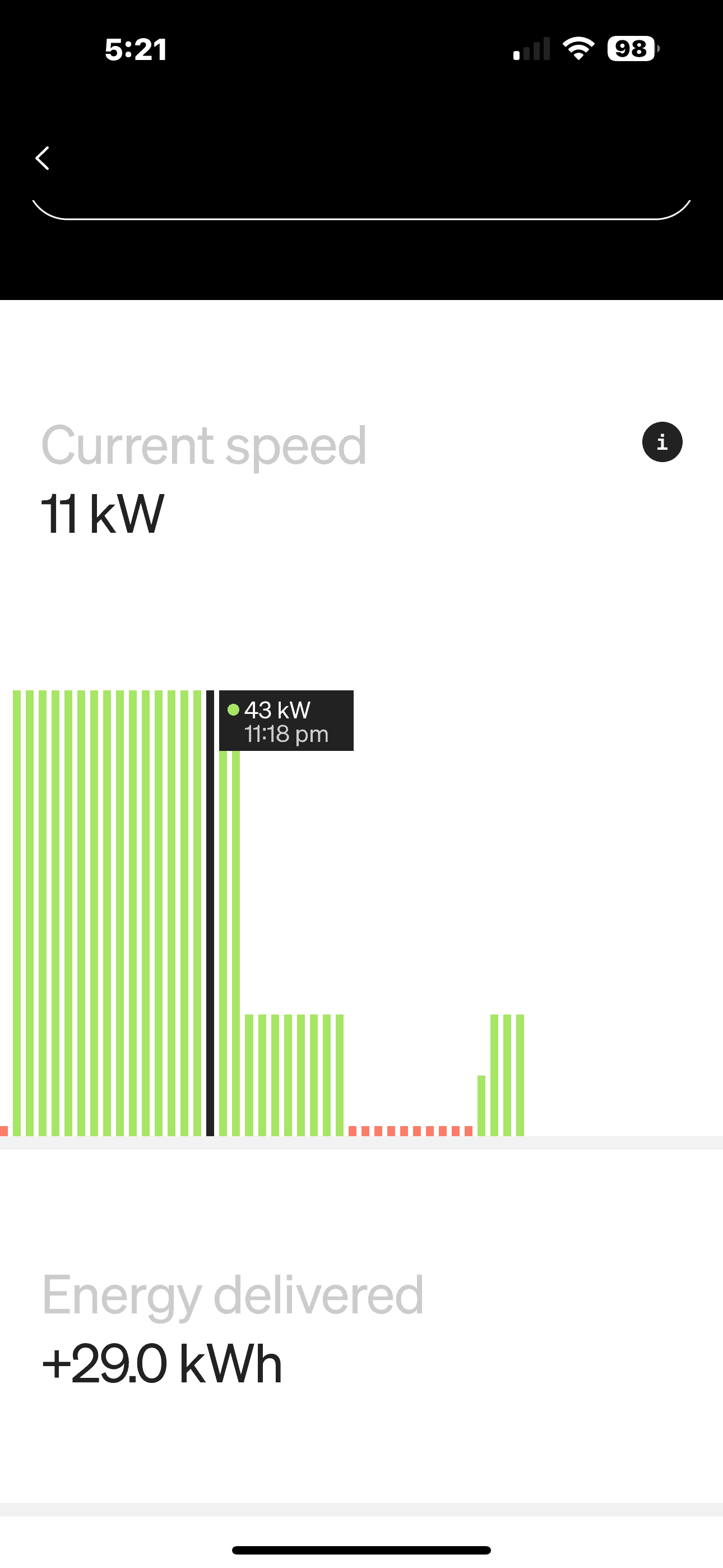

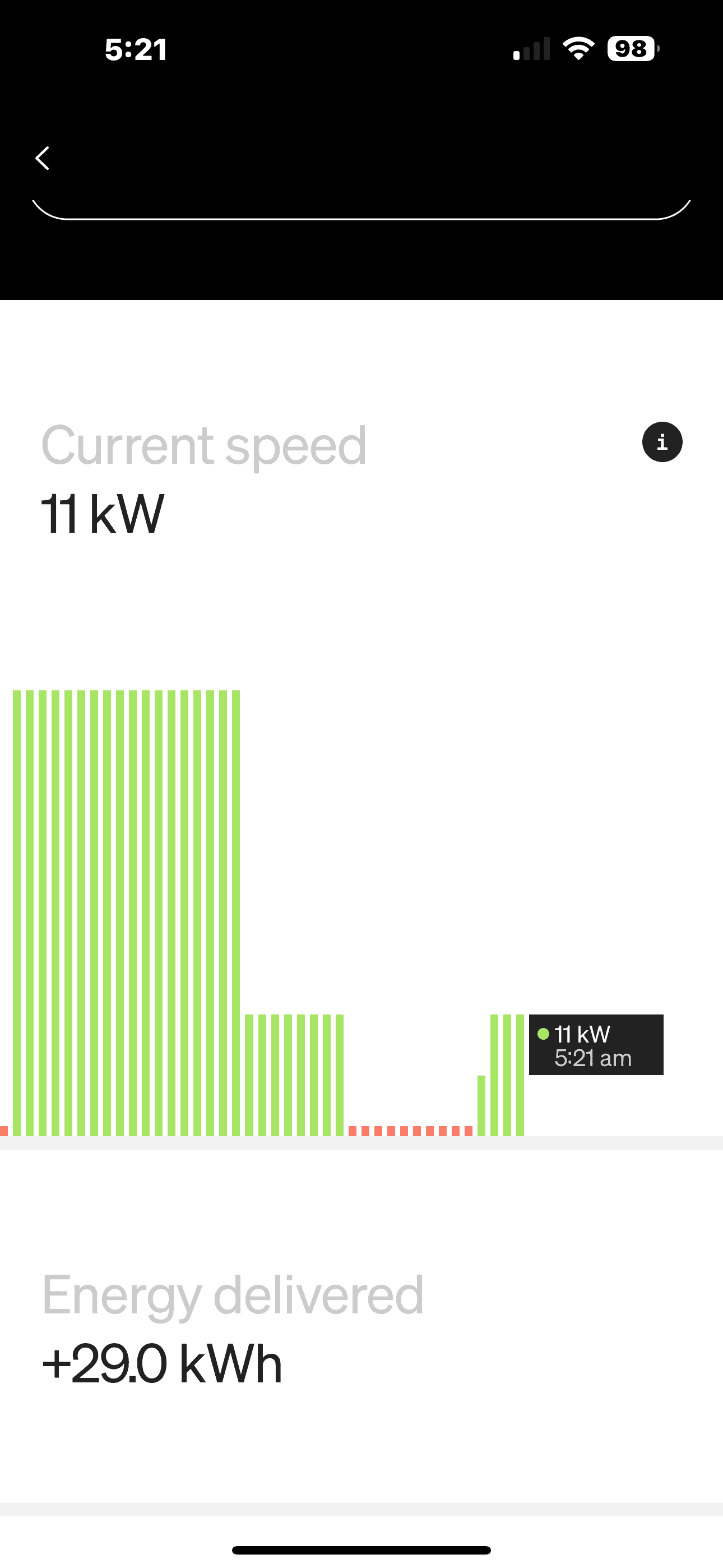

Mine has done this a couple times in the last month. It has typically occurred when I have my truck inside my garage to charge. I have my home charger where I can charge in or out of my garage. I asked Rivian when I went into service center and they said they would check on it. Did not hear back.
Also saw where it showed my home charger was delivering 43kw at one point.

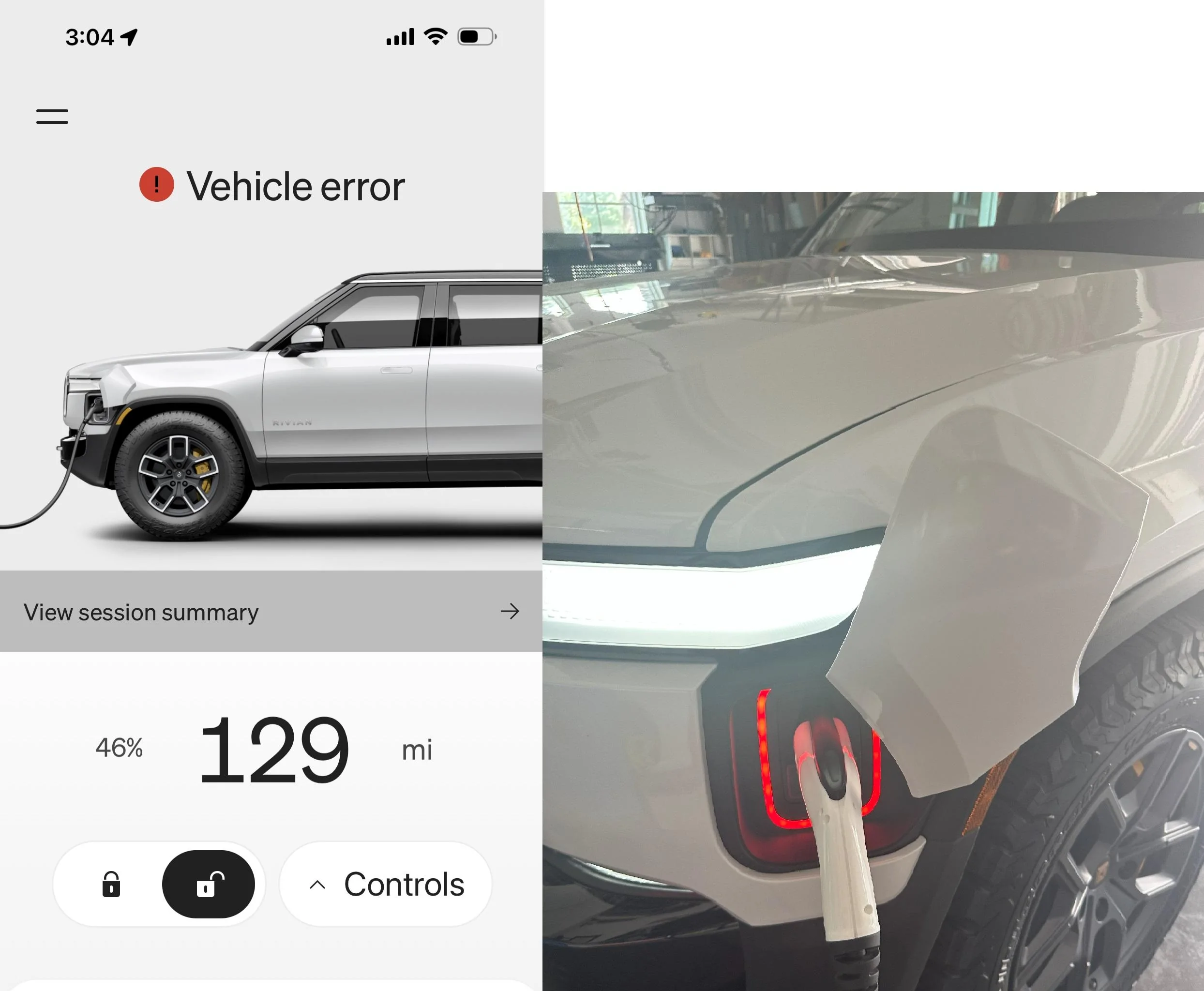

Just started getting this red ring error on my Rivian WC. Working with support to figure out what is going on. Mine is different as if you touch the handle it makes a buzz buzz electronic noise. Charges fine off a TeslaTap so not a huge problem.

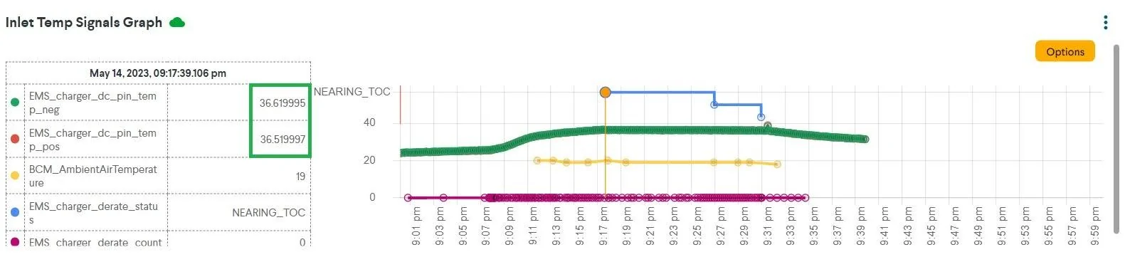

I actually had this issue yesterday at a EA fast charger near my house. I was at 40% and headed to the Costa Mesa SC for a service ticket, so I just gave up after 3 attempts. All three times it would charge for a minute or two at about 145kw and then Error out. The other chargers were being used, so I didn't try charging at a different charger.
*** Update *** I sent a text message to my Rivian Engineer neighbor who also charges at this particular set of EA chargers. I described my issue and he said he also had trouble with that particular charger. He pulled the charging logs from the Rivian and came to the conclusion that the temperature sensor in the EA charging plug is not functioning correctly and is giving a false reading to the vehicle. The Rivian software picks up this abnormality in the charging cable temperature and automatically stops charging to protect the vehicle. My neighbor says he hasn't any issues with the other chargers at the same location. He provided me the log, just to show me what he was talking about.
