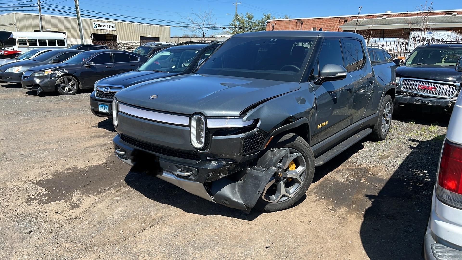

I’m sure many of us are curious as to the demise of your vehicle. Pictures? Has it been declared total?

Front suspension is destroyed and wheel is folded under when moved. Damage back through driver’s side door, under to the motor, and across the hood and frunk. The car that hit me was a terrible mess and totaled, so the Rivian performed brilliantly. As for being totaled, it is still being assessed by insurance, so I’m in limbo.

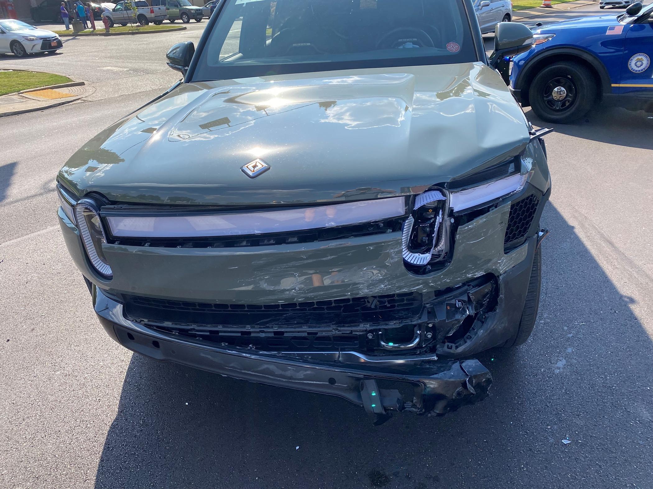

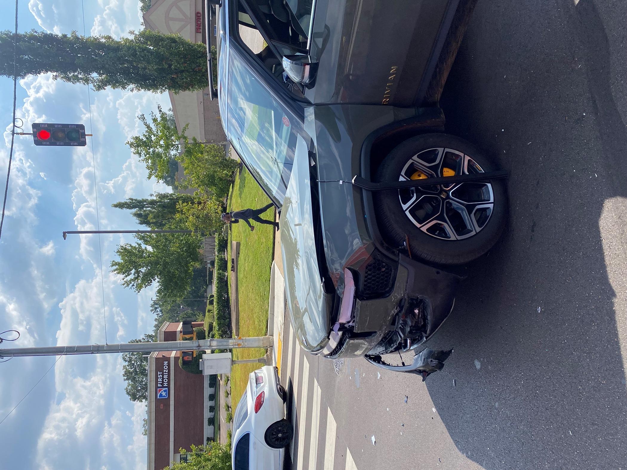

Was pulling out of a Walgreens parking lot heading north. This particular exit is perpendicular to a very busy east/west street, so cars exiting the parking lot must adhere to a traffic light. As I began to approach the intersection, the traffic light was red. As I continued my approach, however, it eventually turned green, so I continued through the intersection. A driver heading east (perpendicular to my R1S) ran a red light and hit me on the driver's side front quarter (similar to LittonLad) going about 35-40 mph. Insurance totaled the vehicle. A few photos here show the damage.
Also similar to LittonLad, the drive cam stopped working a few seconds before I was hit. Fortunately, the drive cam caught just enough--as you can see from the video included, the light changes from red to green just before the video stops. That was enough for me prove to both the police and my insurance that I was not at fault.
