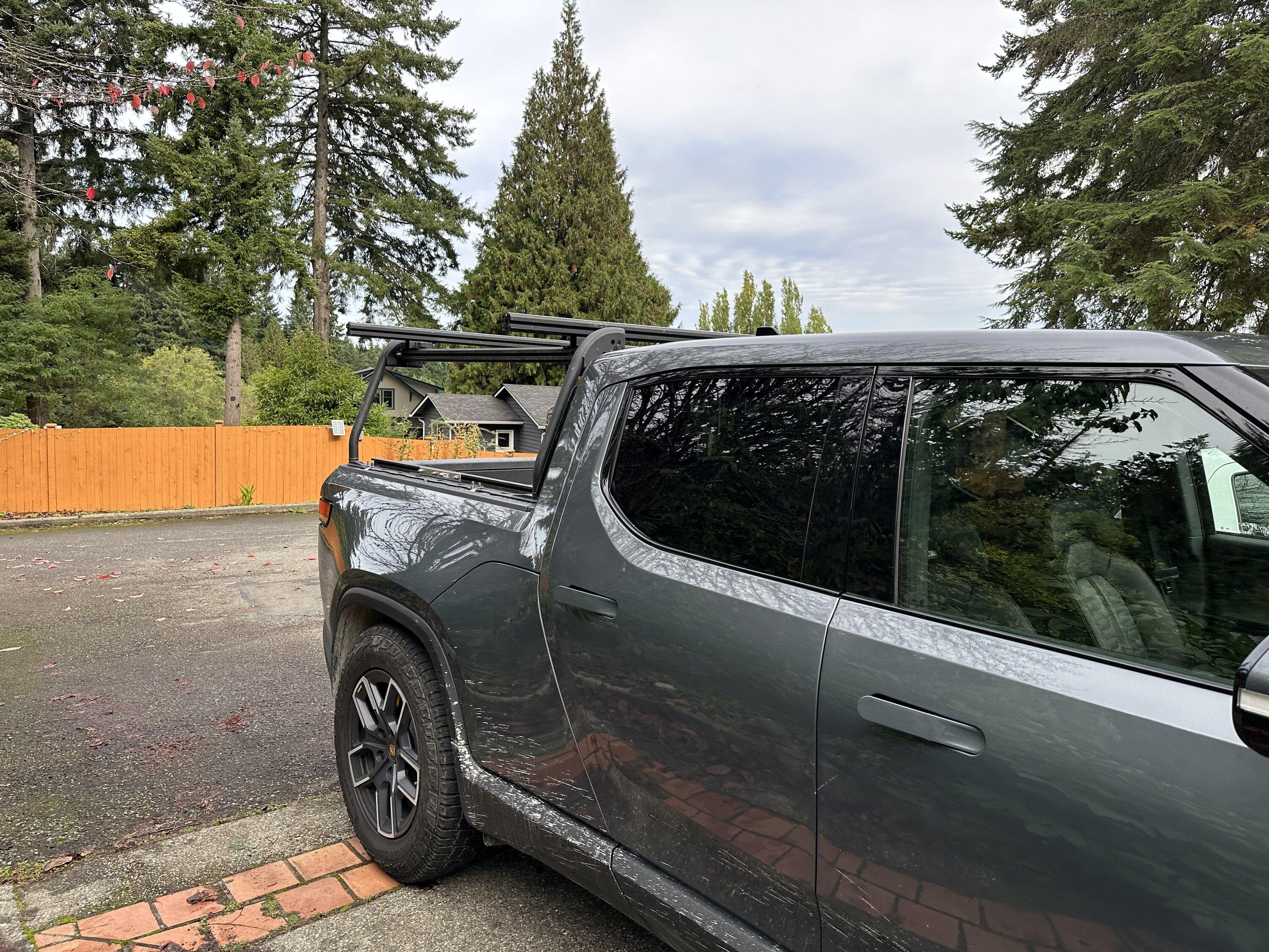

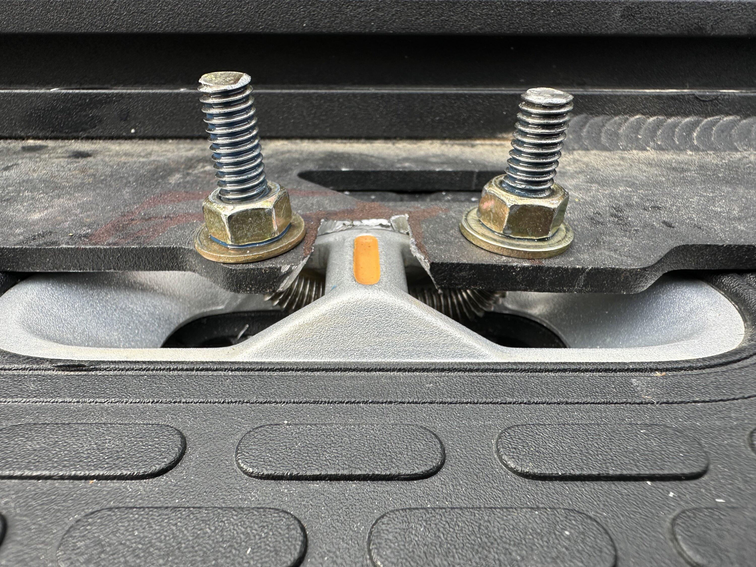

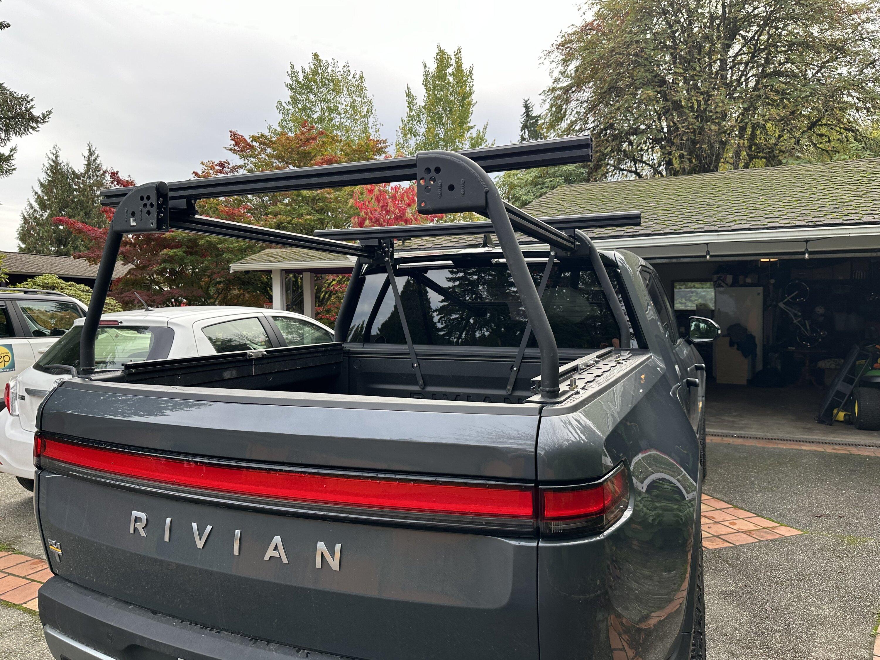

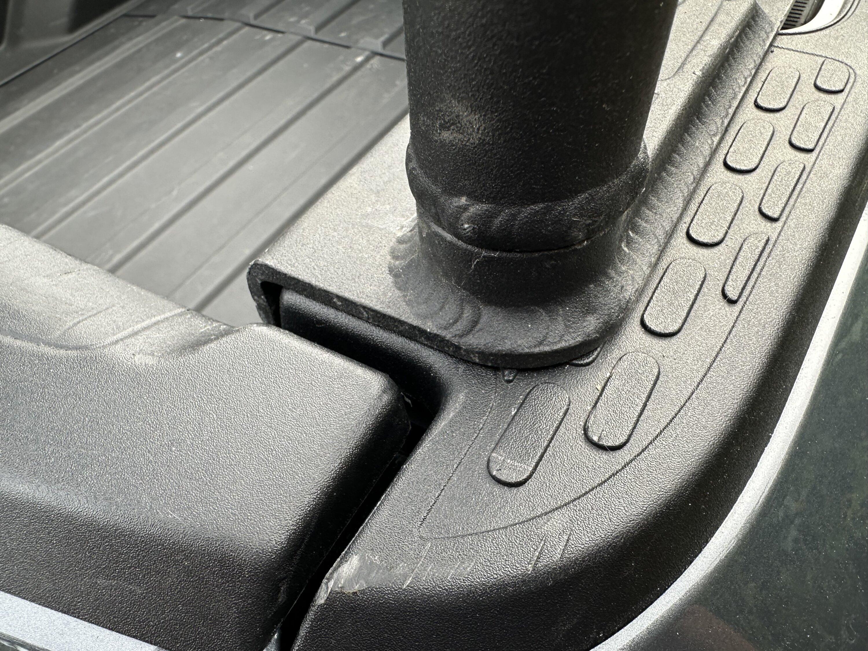

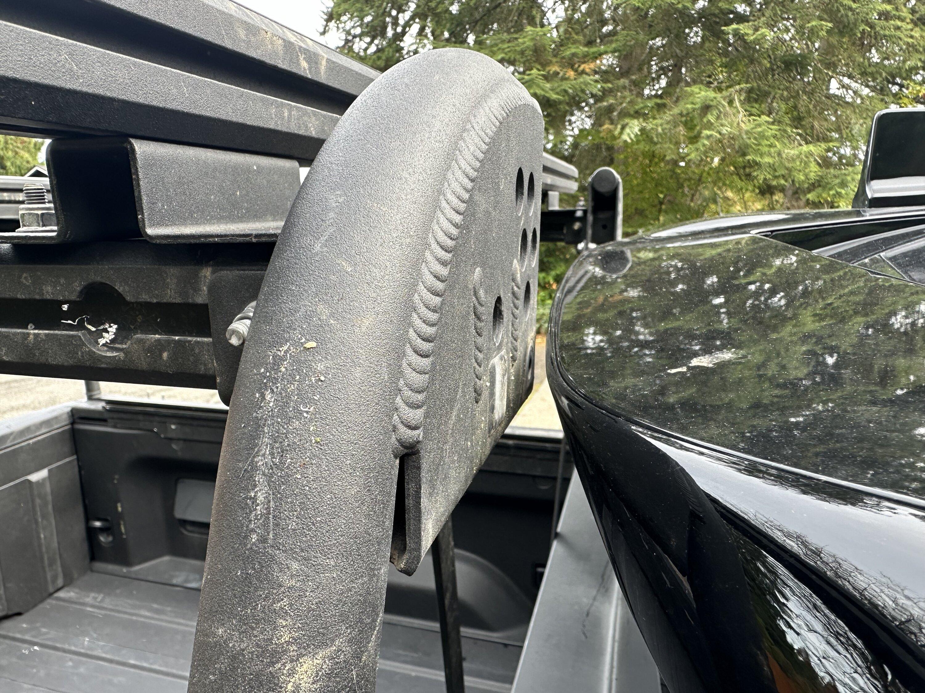

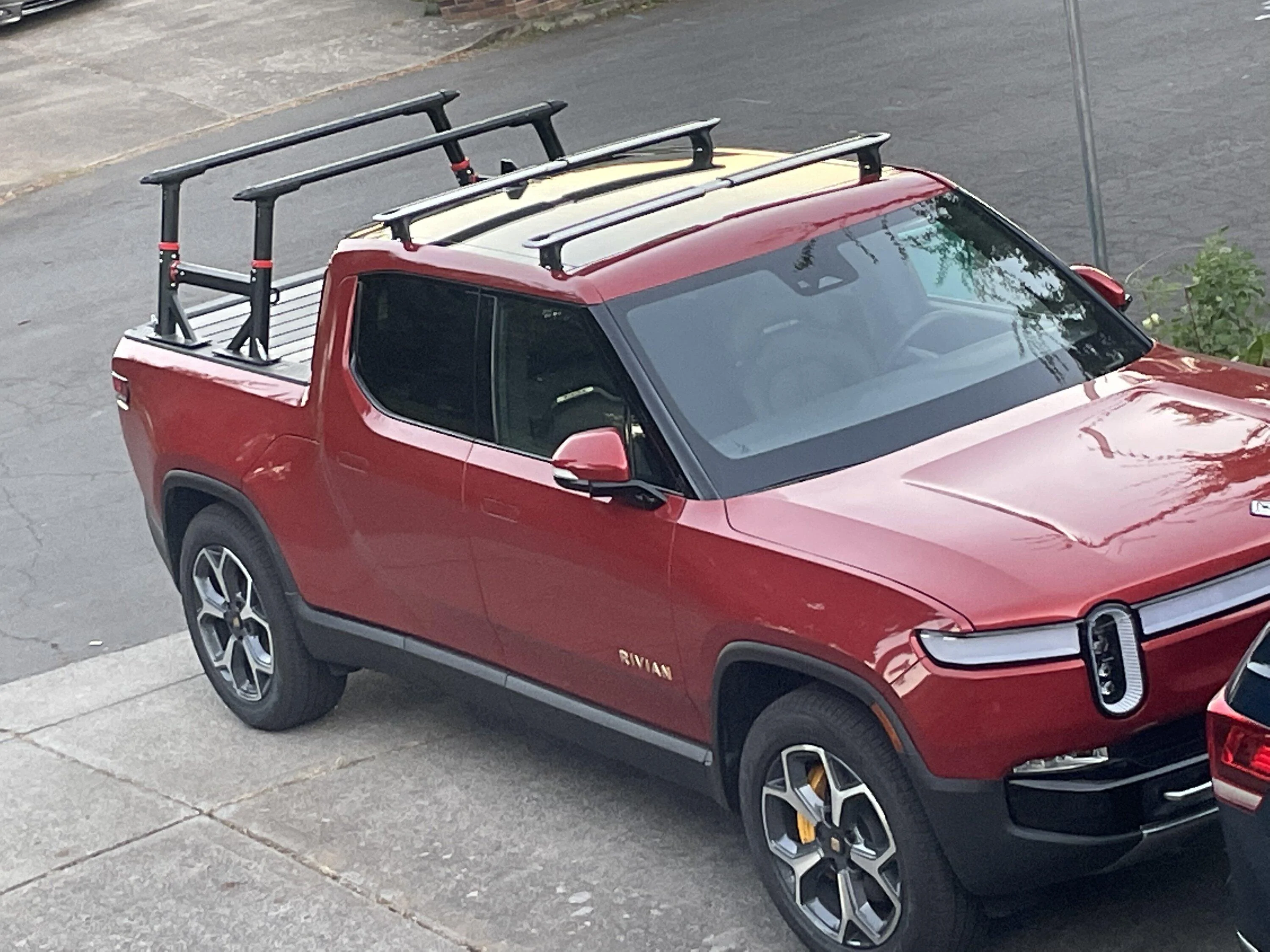

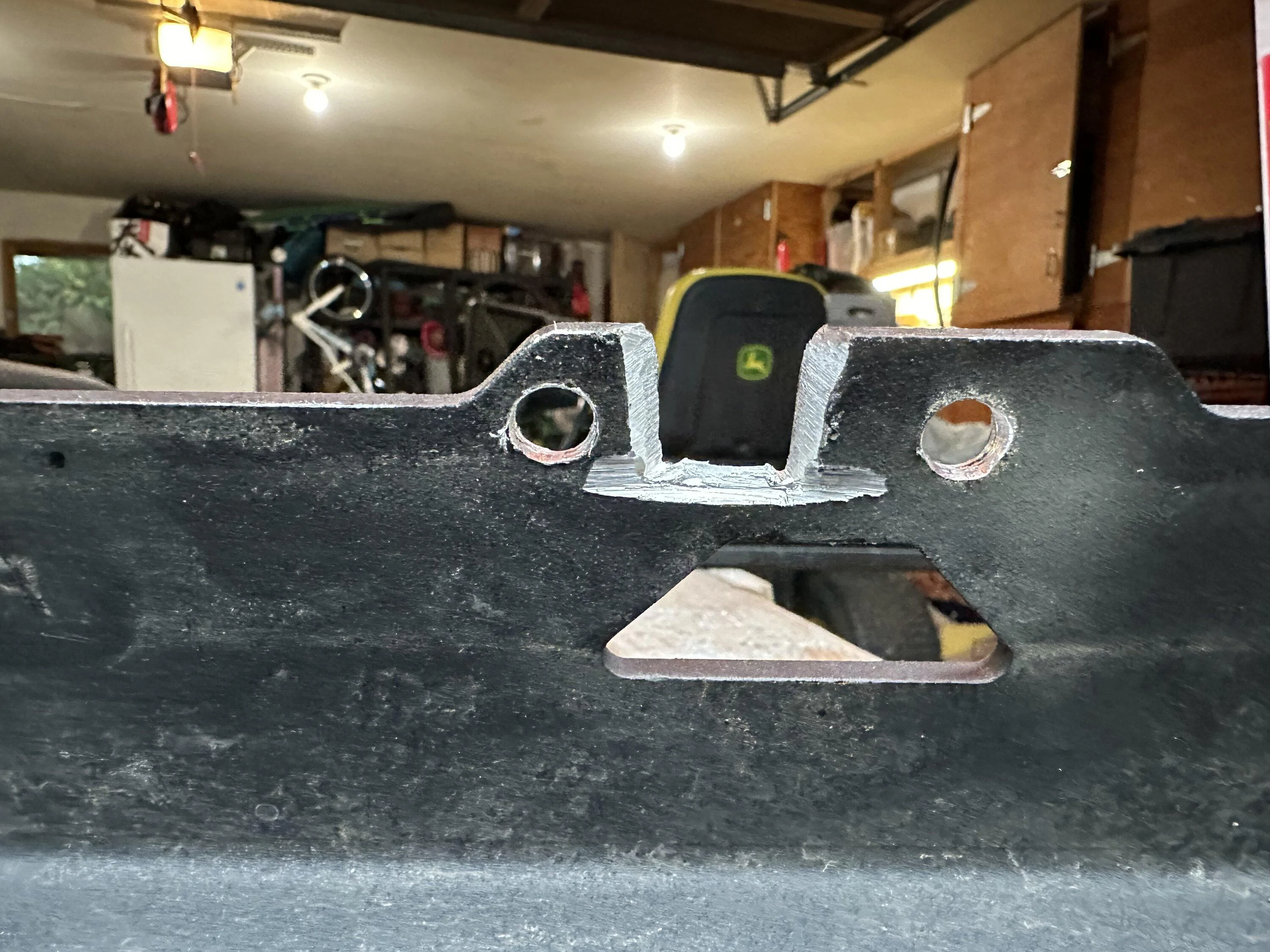

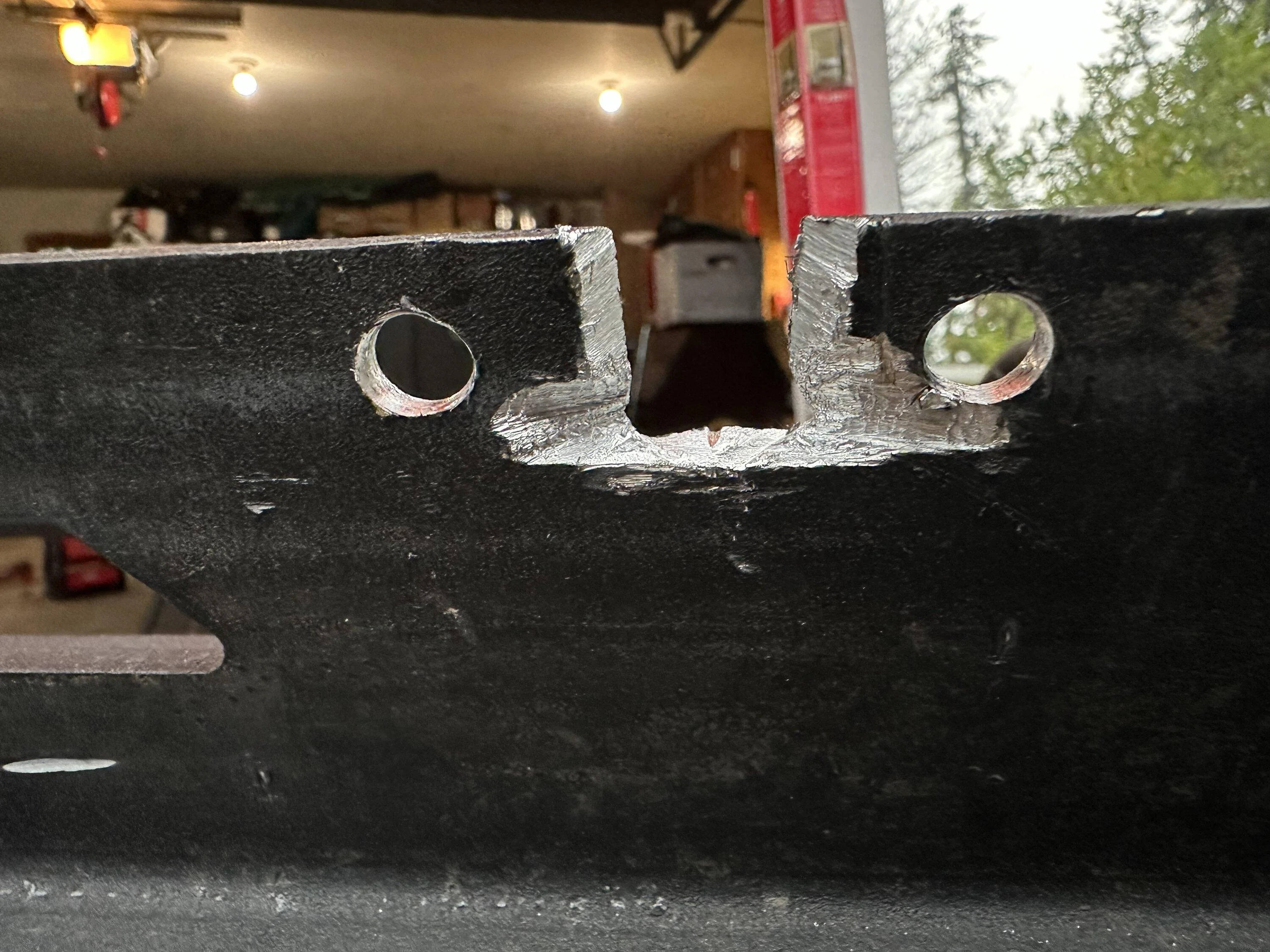

I had a 6.5 feet classic Leitner bed rack, and I spent a few hours this weekend to adapt it to the R1T.
I had to cut the bed mounts in the center, and shave starts and ends to fit the inner shape of the bed. I used the original mount points by cutting a slot in the aluminum if the bed mount and using threaded stainless steel bar I curved in a U shape.
I used existing bolt mounts for the diagonal bars near the cab, and skipped the other rear brackets.
Overall it feels pretty sturdy and will help me mount my awning and maybe a RTT.
I need to spend some time in fit and finish cutting extra bolt space and paining everything a flat black, but the structure is in place.

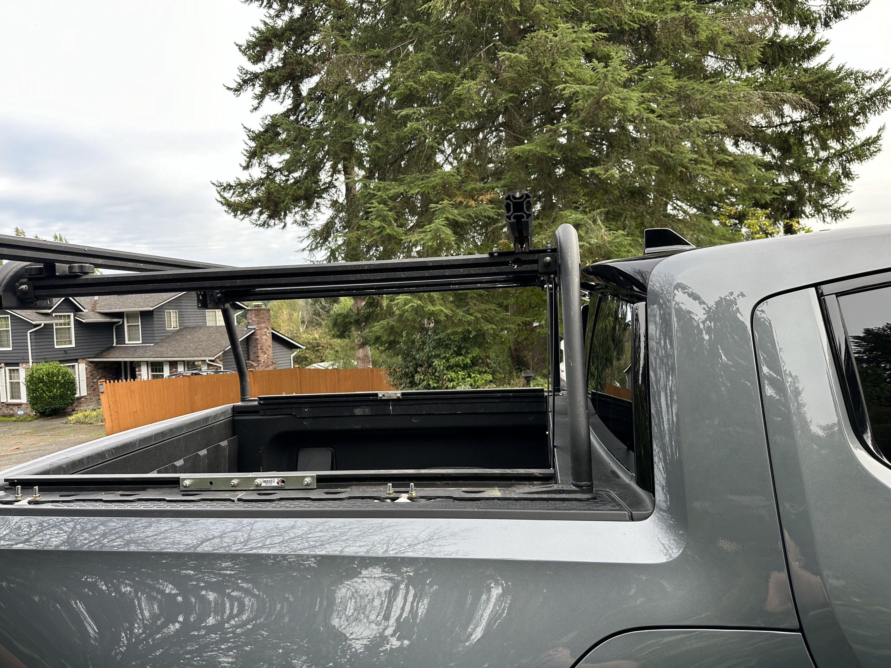

I like your threaded bolt idea. I have a working power tonneau so I don’t this rack would work. I have been doing a different set up for the last 15 months
here is my thread
Bed rack

I’m not familiar with Leitner, but gotta give them props for those nice looking dime welds. Looks sturdy.
Nicely done on the conversion fitment. There may be an alternative whereby you remove the four cast pieces from the topsides and use those mounting bolds directly into the bed rails, not sure.
here is my thread
Bed rack
I envy your power tonneau.. your rack looks great as well. For me was mostly a reuse of what I had, it served me super well heavily loaded off-roading with it.

Yes the build quality is very very good, unfortunately my Pod XL is like an inch too long (I could have tried to go over the tailgate but didn’t felt right).
The vertical poles and top curve is a single piece bolted underneath the bed-touching horizontals, not sure I follow your suggestion.
I looked at the mounts and seemed that reusing their cast structure (and huge bolt) was much sturdier than any alternative I could have made myself.
I have a mig welder but too lazy (and low skills) to attempt aluminum welding ;)

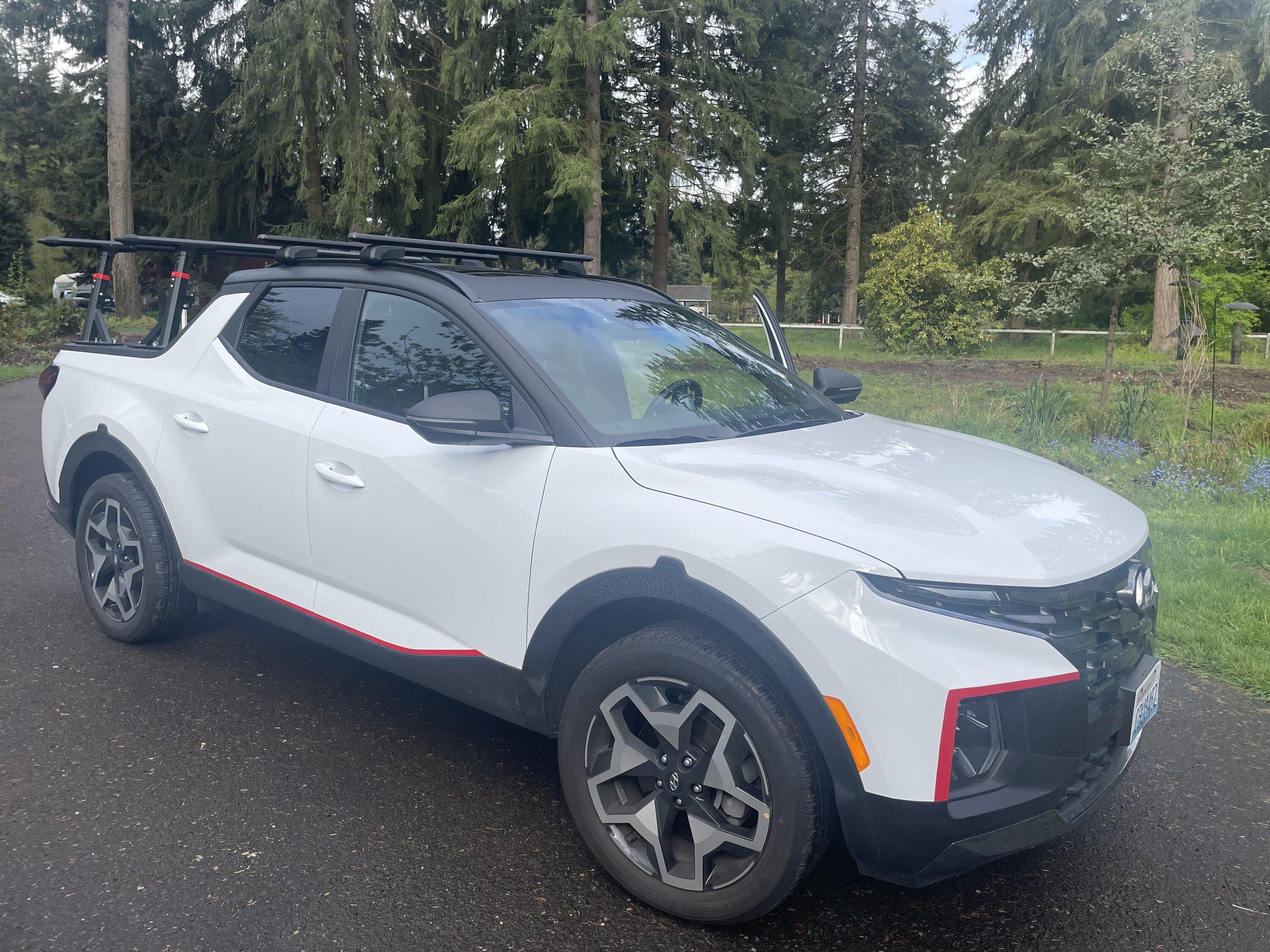

I’m very tempted to get their ACS rack for the Maverick. Someone has already modified this to work on their he Rivian.
Carloc
Carlo
Jun 10, 2023
Woodinville,wa
it is very good. For a vehicle with canopy options I would opt for that (but none available for Rivian yet and I had this available). A Sturdy canopy will give you similar load space but the stuff stays dry :)
