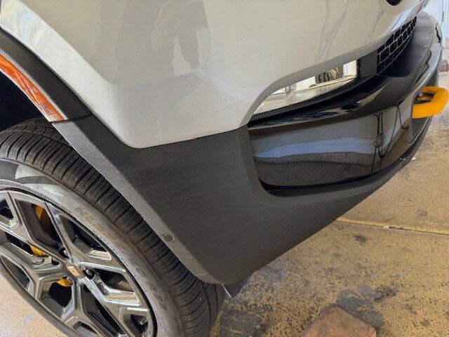

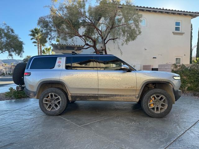

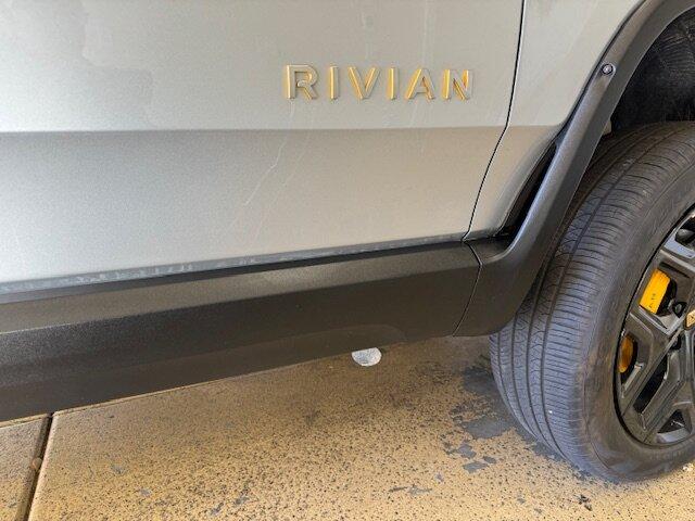

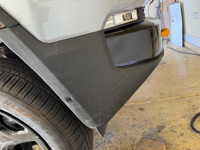

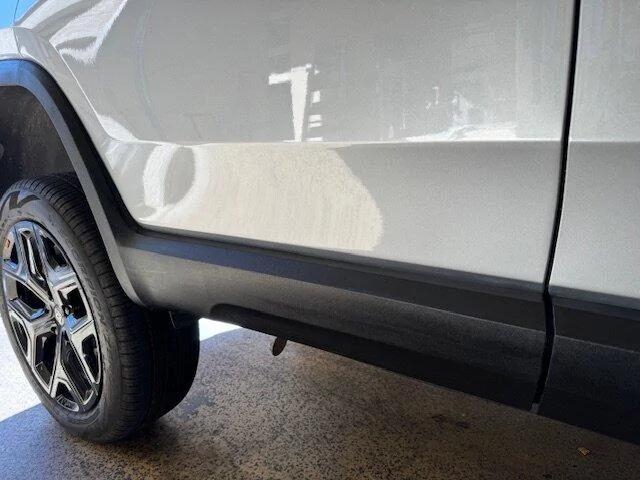

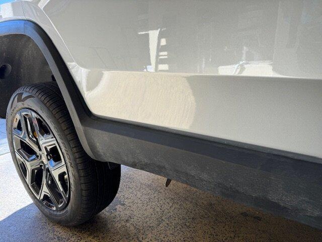

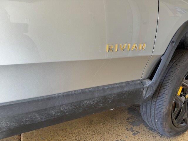

I do off-reading in Vegas and the gravel and fine dust gets everywhere. It also has a clay consistency when it gets wet. This gunk has been building up for months despite some elbow grease.
I had great results with this:
CERAKOTEĀ® Ceramic Trim Coat Kit -... https://www.amazon.com/dp/B07SHJVK4G?ref=ppx_pop_mob_ap_share
Attached are before and after pics. I used 3 sheets to do the entire plastic trim including the fender flares and rear number fascia. I did take some care not to coat the sensors/cameras.
Rivian R1T R1S Cleaning Mud off of plastic trim IMG_5992
Rivian R1T R1S Cleaning Mud off of plastic trim IMG_5995
Rivian R1T R1S Cleaning Mud off of plastic trim IMG_5990
Rivian R1T R1S Cleaning Mud off of plastic trim IMG_5993
Rivian R1T R1S Cleaning Mud off of plastic trim IMG_5991
Rivian R1T R1S Cleaning Mud off of plastic trim IMG_5994

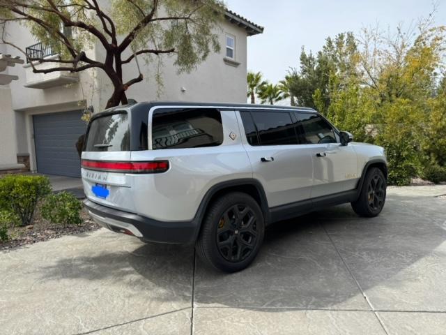

As a follow up after the application, here are some before and after pics after a snow run (yes in Vegas!). The mud came off completely.
Rivian R1T R1S Cleaning Mud off of plastic trim IMG_6062
Rivian R1T R1S Cleaning Mud off of plastic trim IMG_6257
Hope this helps!

THose before and after are impressive. Thanks for sharing that. I have some detailing background as a hobbyist, so i am familiar with plastics fading. Did you do anything particualr to prep the plastics besides just washing them?

Nothing special. Just a wash. Iā€™m new to detailing - I tried the Cerakote after I read about it on some off road forums. still happy after a few (touchless) washes.

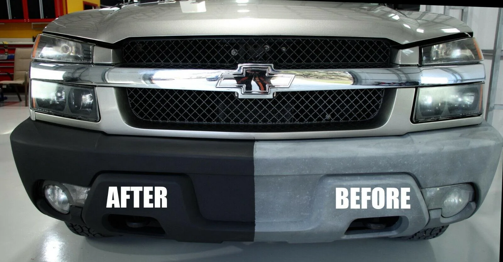

can anyone confirm whether the plastic trim lightens over time?
Midnight Rivians look fantastic brand new, on the website, or in the right lighting, but I don't know how good it's going to look when it becomes a black & gray two-tone vehicle
kinda like what happened to all those old Chevy Avalanches back in the day- people would have to put baby oil on the plastic trim before they took the photos to sell them.
Rivian R1T R1S Cleaning Mud off of plastic trim s-l1600
(maybe a solid reason to put the matte stealth PPF on my truck when I get it)
fireroasted
Jan 27, 2024
RMV, CA 92694
I am not an expert, but a lot of what you see in that pic and plastics is actually UV damage, so if the truck is outside, then PPF is needed. I
f most of the time its in the garage, then it shoudn't get that way. Sun is the killer of all plastics.
