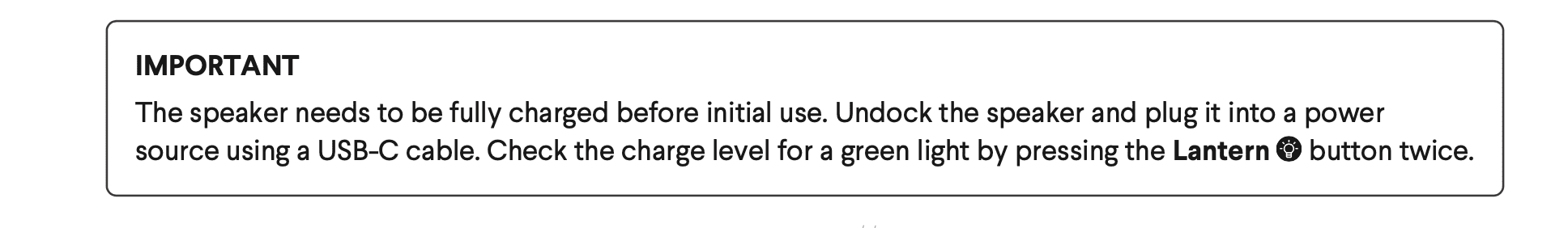

I don’t have a usb c to usb c to charge it externally. What a piece of crap. It’s supposed to charge in the dock. Is it not?
srnyoung
Nate
Apr 23, 2022
424
487
Portland, Oregon
Teacher
Try pulling it out and pushing it back in to seat it fully.
It charges fine in the dock.
You can ALSO charge it with a cord if the R1 isn't available or you want to keep on rockin' in the free world.
Or, complain louder.
