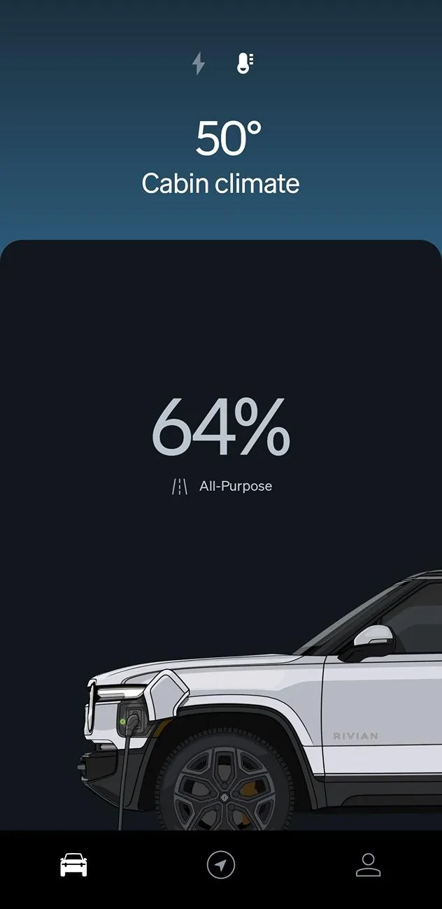

This is something I don't understand at all. Is that what this means:
Rivian R1T R1S Cabin heats without me asking it to 1000014190
It's VERY inconsistent when I've seen it. Sometimes it's at 50 degrees. Sometimes at 30 degrees. Is it based on battery temp?
