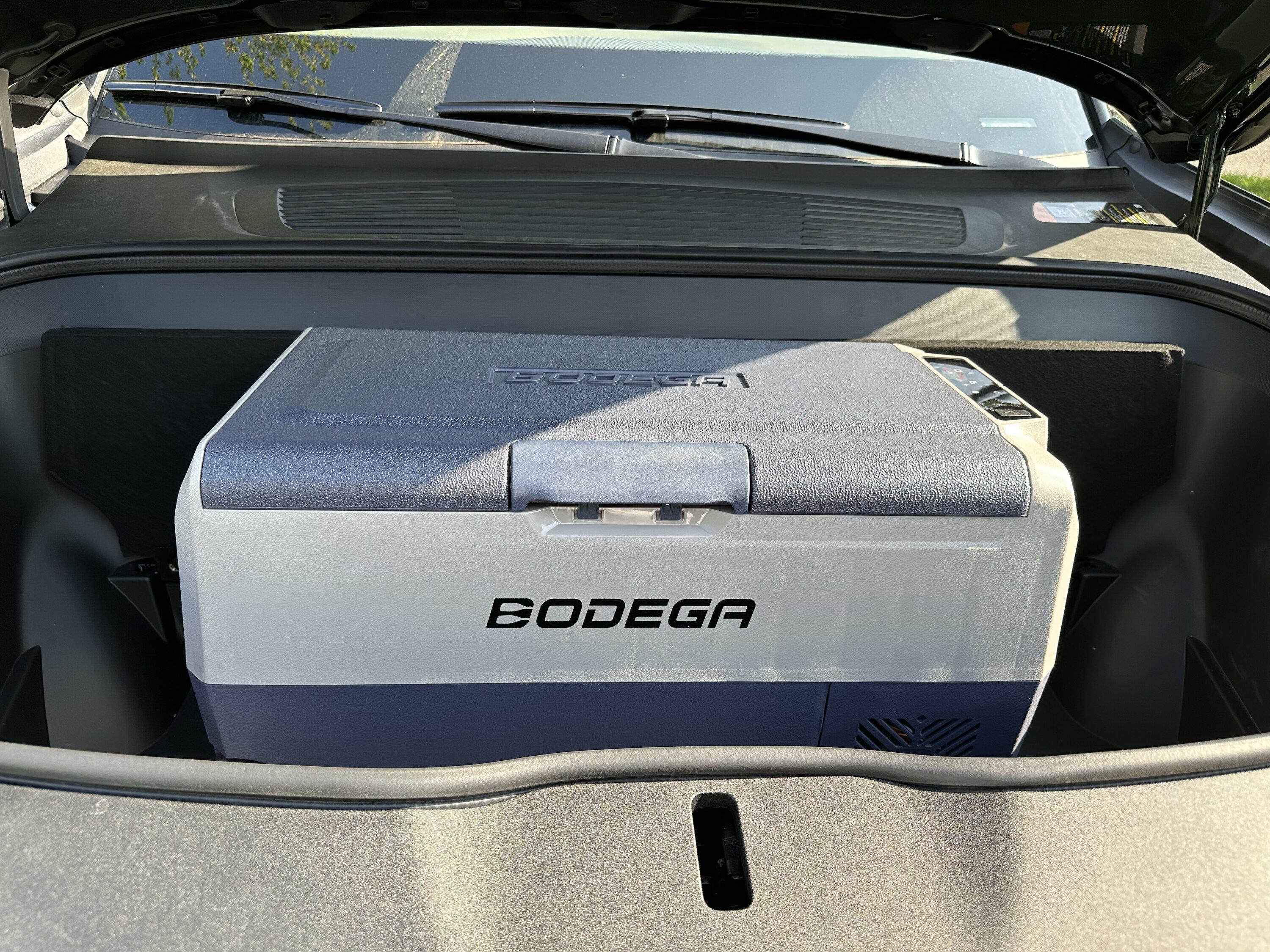

Just curious if you put a 12 V refrigerator in the Frank is there enough ventilation for it to operate efficiently?
I coincidentally ran a 12v to my frunk today. So far, it seems that the fridge has been much slower to cool. I can’t check on it now to see how cold it’s gotten, but I plan to in about an hour or two. I’ll provide an update when I do.

Update on the efficiency in the frunk. I have the BougeRV 21 qt. It usually cools quickly and to whatever temperature setting I select. However, after running it for hours today, set to 32, it never got there. The best it did was 39 degrees. And the frunk seemed hotter than it otherwise would have been. Kind of sucks to get such mediocre results after going through with this.

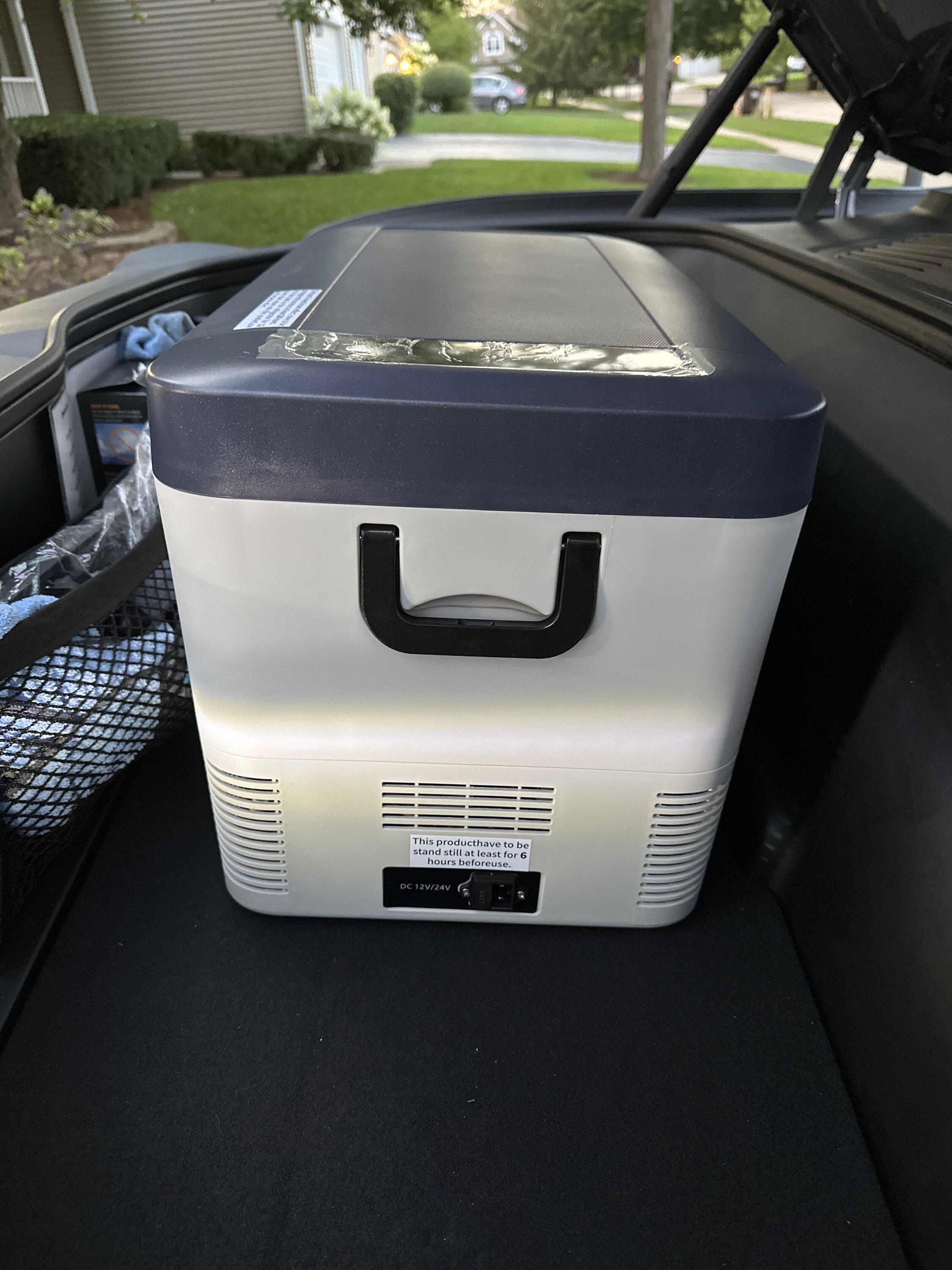

I wonder if anyone has figured out a good way to vent the tub.

I tested my fridge again today after realizing the four water bottles that were in there yesterday could have played a role in keeping it from cooling quickly. Additionally, today was not as hot as it has been in my area, so I figured I would give the experiment another shot. My results were drastically different. The fridge cooled from 81 to about 37 within 30 minutes. I had it set to 30, which it eventually reached. I also noticed that, when opening the frunk lid for only a minute or two, the temperature plummets. I knew it would over an extended period, but the results are almost instantaneous.

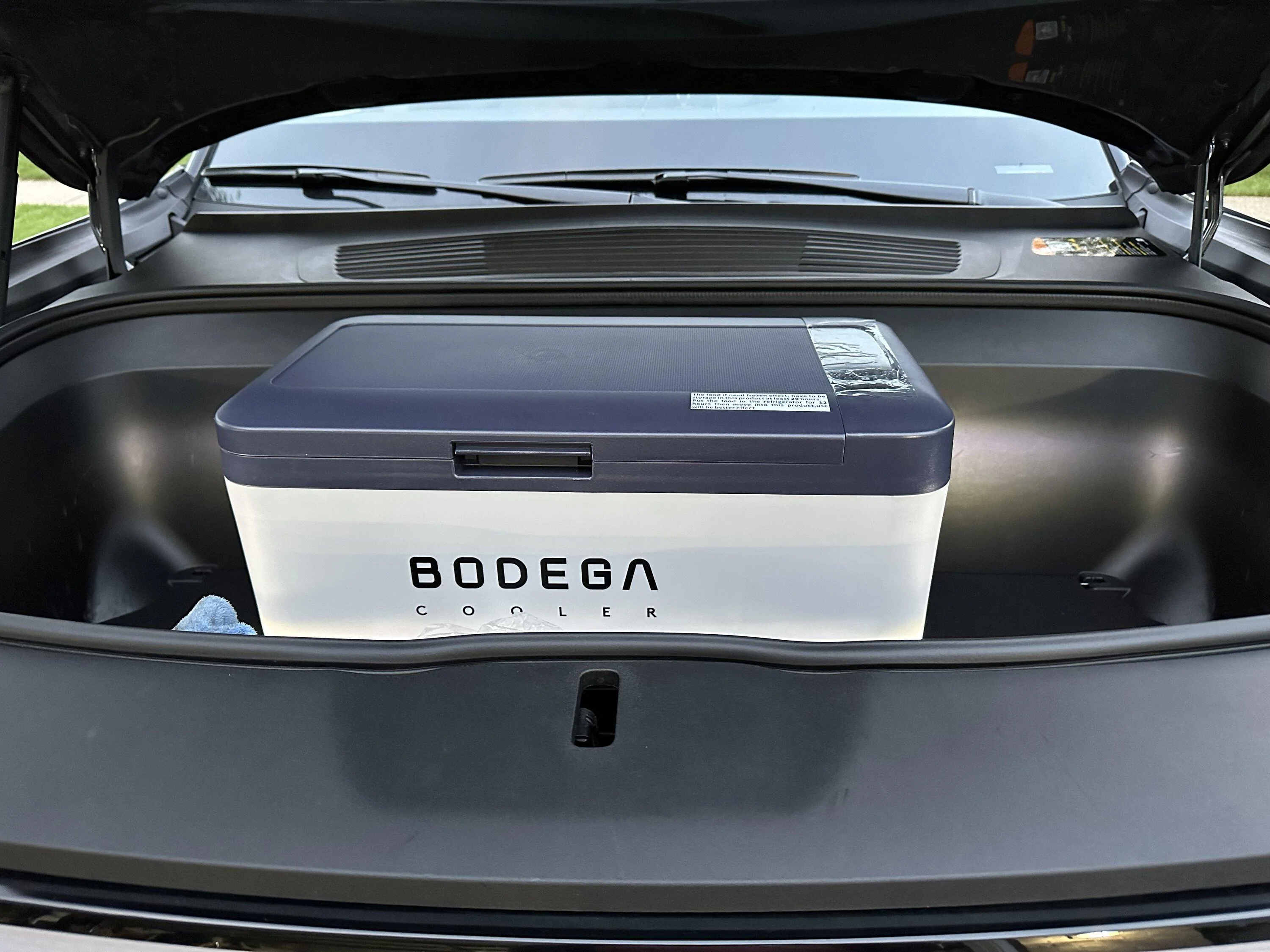

Just want to make sure that this model (36L Bodega) fits in R1S frunk when closed. Thank you.
Sorry, I have the R1T. I can’t speak to wether it fits in the R1S. If it’s the same dimensions, then you’re good.

This is one of those times when you figure out that cooling is removal of heat. Therefore keeping the frunk closed does simply makes the surrounding air hotter as the cooling coils attempt to exchange heat.
Some kind of vent would be crucial to proper functioning of 12V fridge.

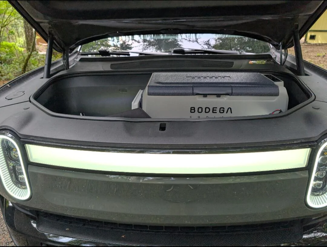

I have the 38 qt / 36 liter Bodega and can confirm it fits as well.
https://a.co/d/ic7PSdd
Here’s a picture:
I finally pulled the trigger and upgraded to the big boiii 38 quart fridge/freezer combo! I'm so glad I did it. I was concerned about the fit, but even pushed to the right and on top of my water tank and mat it fits fine.
Rivian R1T R1S Biggest electric fridge/freezer for frunk? 1000004077
There's a new link for the same product, and it's down to $180 now.
https://a.co/d/88yc5jA
