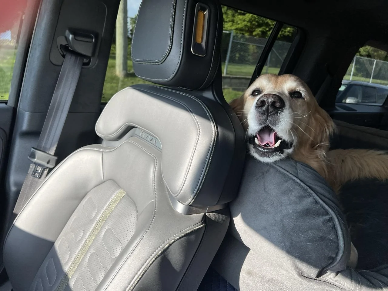

I've got different preferences for traveling with my dog. I keep both 2nd row and 3rd row down. I use a 5-step aluminum pet loader at the tailgate. https://www.petloader.com/ 5-step is great for tailgate entry (ideal in parking lots) or side entry with seats down. I got a very cushy ORVIS dog bed for him that he loves and never leaves when traveling. I personally like having him closer to me while I'm driving and I think he does too. I'm looking into the KURGO impact harness now. Questionable if it will work well with the seats down. Alternative untested option--attach current harness and leash to the cargo tie down to at least improve the front crash forward motion risk.

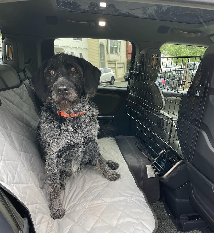

Yes, your approach is not dissimilar to my setup in the R1T.
I used Orvis foam rear seat extenders (just one shown below) to fill out the back seat area.​
I had a cheap Amazon barrier to keep both dogs from exploring. (It rattled when we were moving, so it worked but wasn't ideal.)​
I purchased, and later returned, some Pet Loader steps because the angle would not work for side entry into the R1T, as the doors simply wouldn't open wide enough to position the steps perpendicularly to entry. Might consider again for rear entry.​
My only word of caution is that using a leash and a dog-walking harness might give you some peace of mind, but that's akin to making your own DIY seatbelts... Not recommended. It might help keep a dog in its place under normal conditions, but it's not going to hold up in a crash.
If you do end up buying a safety harness, I'd look at the Sleepypod brand because at least they crash test their harnesses via reputable third-party. That's likely where I'm headed.
I might also try to reach out to Sleepypod to see if the harness will still work properly when connected to an unbuckled seat belt. That seems to be the only way I could use the harness in the cargo area with the seats folded flat.
(Sadly, the dog pictured below passed away this summer. And, no, her passing was not related to a crash. And, of course, she was a good girl.)
Rivian R1T R1S Anyone using the third-row (R1S) for dog transport 1727191191394-us

Sorry for your loss. Was she a German wirehaired pointer? We had a 13-year old Spinone Italiano who we lost in January.
To keep my post on topic: We used a harness from a company I don't even remember the name of and don't think they still exist. It was not crash tested to anywhere near the standards of SleepyPod, Kurgo, Ruffwear, etc. but at the time it was one of the best options out there. The thing I preferred about it was that it used a super heavy duty oval ring to attach to a robust ballistic nylon webbing strap. The ring was threaded and could be attached to either a seatbelt or the LATCH pin on the back of the seat, which is where we had it clipped so it was easy to flip over the back of the seat out of the way when a human passenger got in. The other side of the strap clipped into two pretty beefy D rings on the harness that kept the quick release buckle from being a failure point. It worked well for what it was. She was comfortable with it and could move around on the back seat a reasonable amount but would have been restrained decently in an accident. She likely would have had some sort of injury in a really bad collision, but not life threatening.
If/when we get another dog, we'll get a harness from one of the three companies I named above and will follow the instructions exactly, using the seatbelt itself for the restraint. I think those offer a little less flexibility in how the dog sits or lays, but I think the additional safety is worth it, especially when you're starting out with a puppy that will only ever really know that that's how they're supposed to sit and lay in a car.
Yes she was a GWP. Had complications from a splenectomy... Sorry for your loss.

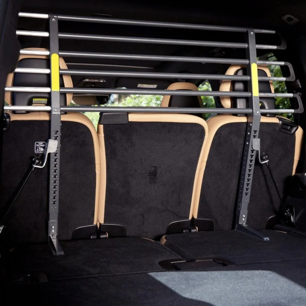

Posted on reddit (I know most of us read both) but bringing back here to close the loop:
I dropped $400 on a crash tested dog barrier. (It's the "medium" size on this site.) In my R1T, I had used a cheap/janky amazon barrier and (a) it rattled when I drove and (b) would have provided zero protection in the event of a crash.
If you don't know this brand, I think they make barriers to police cars / K9 units...
Note: It did not go exactly as planned. I probably should have ordered a small (as crazy as that sounds) but even the small wouldn't have worked exactly as intended. More on that below.
The contraption has feet that are supposed to sit flat on the floor. (The medium was a smidge too tall, hitting the roof and impeding its ability to slide all the way up against the middle row seats.) It needs to sit against the seats for actual crash protection.
It's also supposed to anchor on the vehicle's cargo holds. See the hooks in the photo below:
Rivian R1T R1S Anyone using the third-row (R1S) for dog transport expensive-r1s-dog-barrier-v0-pgoc1o7urkwd1
Those tie down hooks will never reach back far enough to anchor...
This won't work in the Rivian R1S because the cargo holds don't slide far enough forward to engage... They stop at the rear of the third row seats.

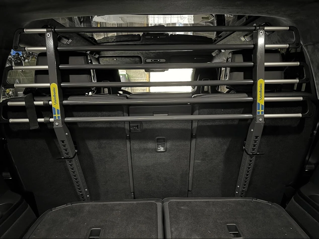

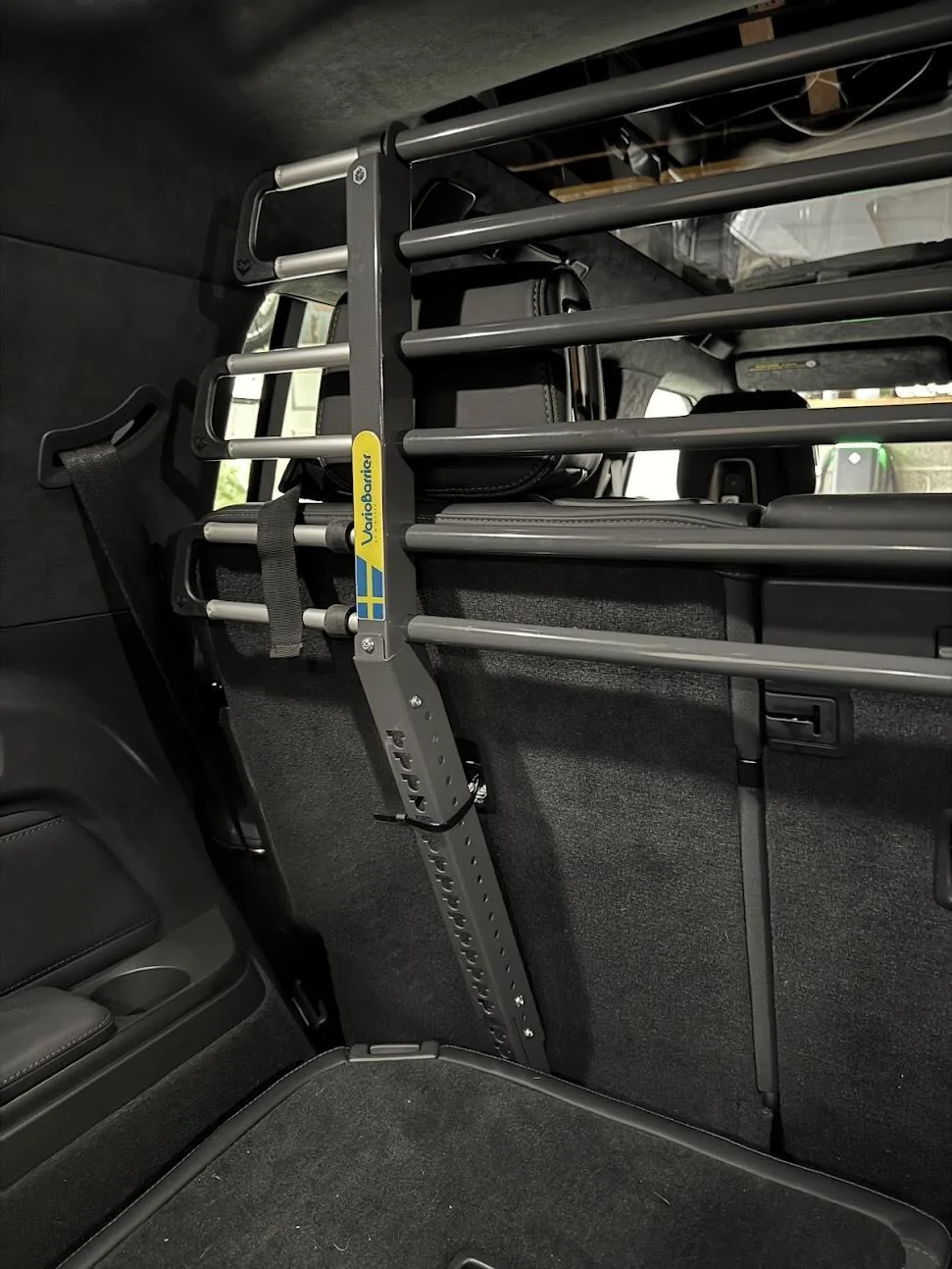

So I called an audible and got it to work. (That's a good thing because it's non-returnable and non-refundable. Please take note before ordering one for yourself.)
If you remove the "feet", the "legs" will slide right down in between the middle row seats and the (folded down) third row, resting on the floorboards.
This actually works pretty well and the angle is pretty good. See below.
To keep it all from rattling, I zip-tied the barrier to the child seat anchors with heavy duty zip ties. You could maybe use velcro or also zip-tie to the headrests to secure it.
It's really not going to move very much wedged in between the seats but I don't want those steel legs to mess up the fake leather on the top of the third-row seats, so securing to the middle row seems prudent.
This think is built like a tank and because of the angle, you still get maximum storage capacity behind the barrier: Dog, dog bed, water, bones, etc. all fit behind there. She's very comfy.

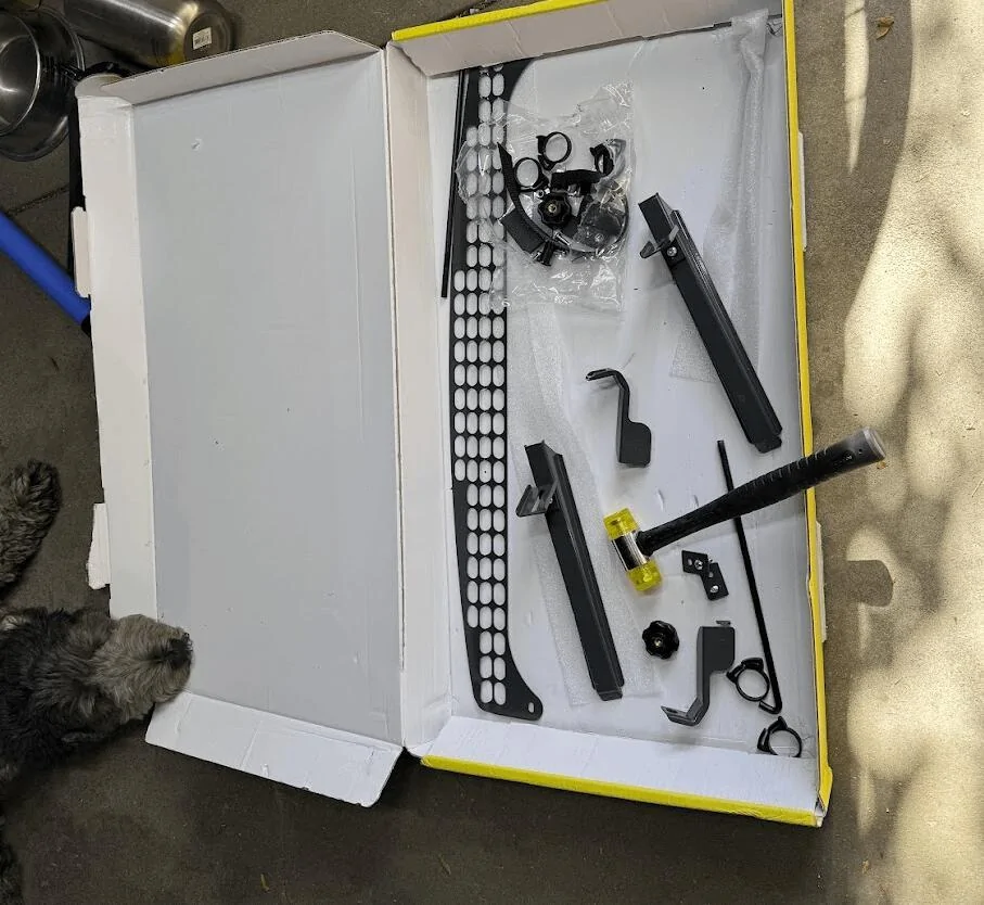

Photos:
Rivian R1T R1S Anyone using the third-row (R1S) for dog transport expensive-r1s-dog-barrier-v0-h6fb8vkirkwd1
Rivian R1T R1S Anyone using the third-row (R1S) for dog transport expensive-r1s-dog-barrier-v0-gfn6ef4xskwd1
Rivian R1T R1S Anyone using the third-row (R1S) for dog transport expensive-r1s-dog-barrier-v0-iazsiu39vkwd1
My helper and a lot of unused hardware.
