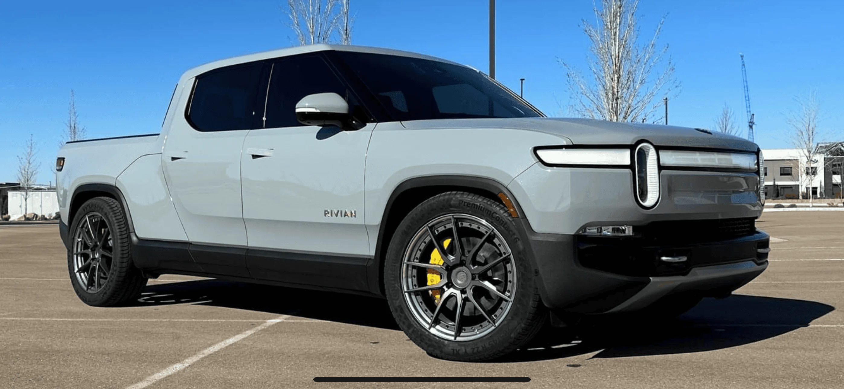

Those are 285/45’s and loved them.
Rivian R1T R1S Anyone running 285/45/22's? IMG_3969

They are continental premium contact 6. Basically race tires so I tried to use them sparingly. I sold the truck but they handled amazingly and we’re almost 20# less per corner so range improved even with factoring in the smaller circumference
