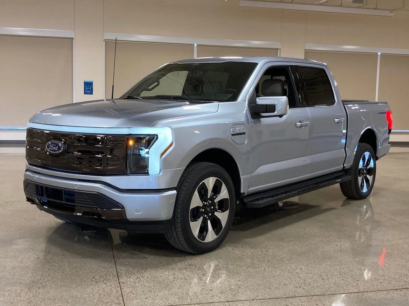

My biggest concern with the both models is that they used a single piece for the entire side. Meaning if you mess up the rear quarter panel you may have to replace the entire side of the car.
This is in contrast to say a normal truck that keeps that a separate panel
