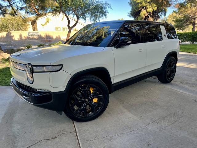

Good afternoon!
Recently purchased an R1S which has a Satin PPF wrap. They removed all badges when doing the wrap, and the previous owner decided to leave it de-badged (aside from the hood and c-pillar).
I have decided to re-badge the R1S (at least some of it), and have an issue. Since the old lettering and any remnants of the old lettering is no longer present, I don't know exactly where to place the lettering / emblems. Specifically, how high / away from the body lines should the letters go on the doors, for the rear R1S emblem, etc?
I reached out to Abstract Ocean and they are checking, but claimed they aren't sure either. They messaged me saying they don't have an R1S to check, and typically installation of their emblems happens at the same time as removal. @AO_Pete tagging you to make sure this is correct.
Can anybody give me some guidance by taking a few quick measurements? Picture for reference. Thanks!

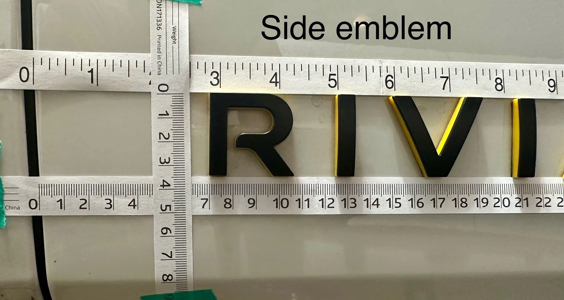

yeah. Based on the install video at around 8:30 in, the side emblems are about an inch off the panel fold, and 2" from the leading edge of the door. I think as long as they're in about the right spot, and the same spot on both side, it would look great. We don't have our R1T at the moment, otherwise I'd at least measure that (not the best guide though, we've gone through a lot of emblems with all the testing).

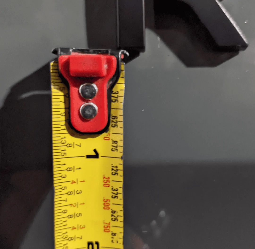

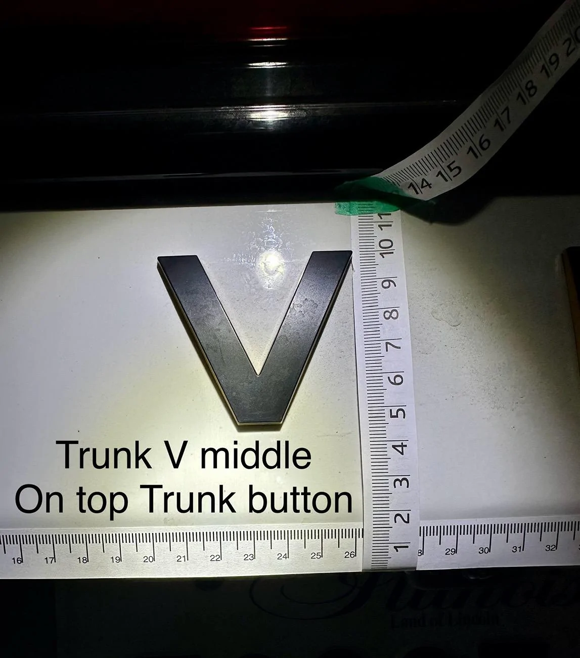

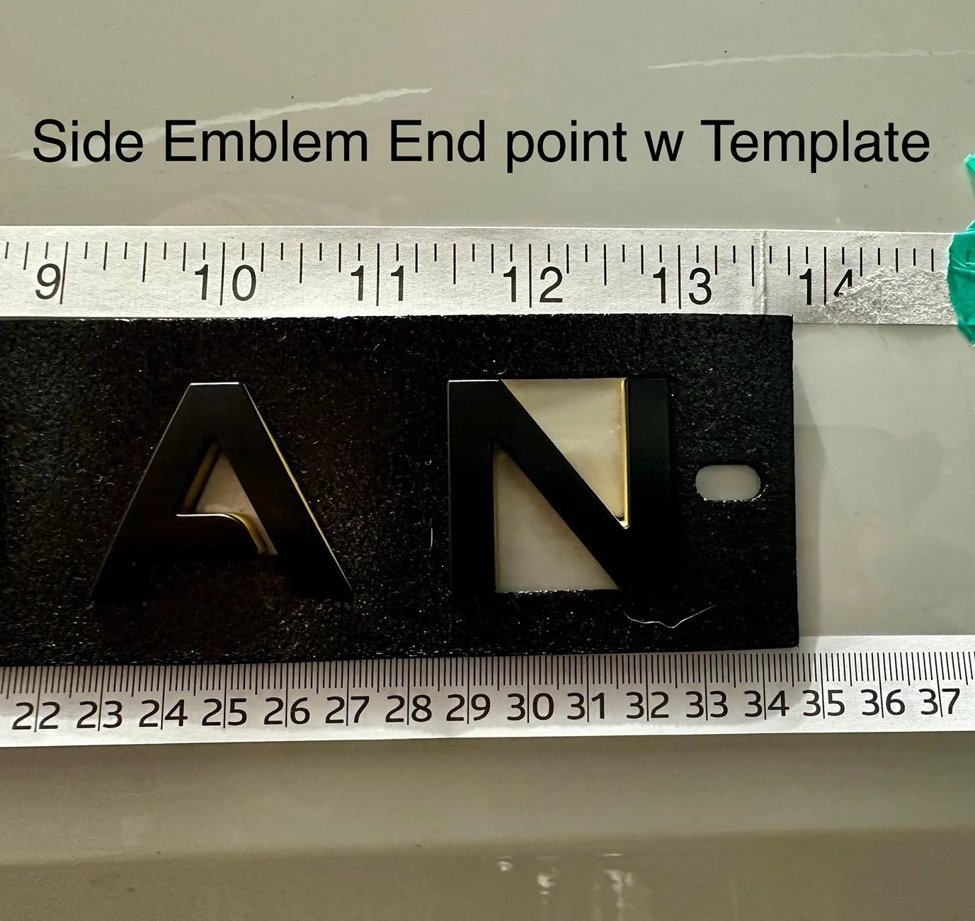

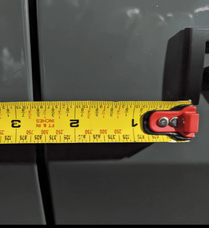

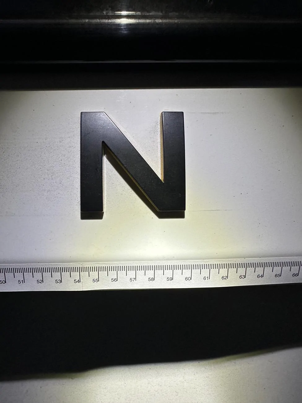

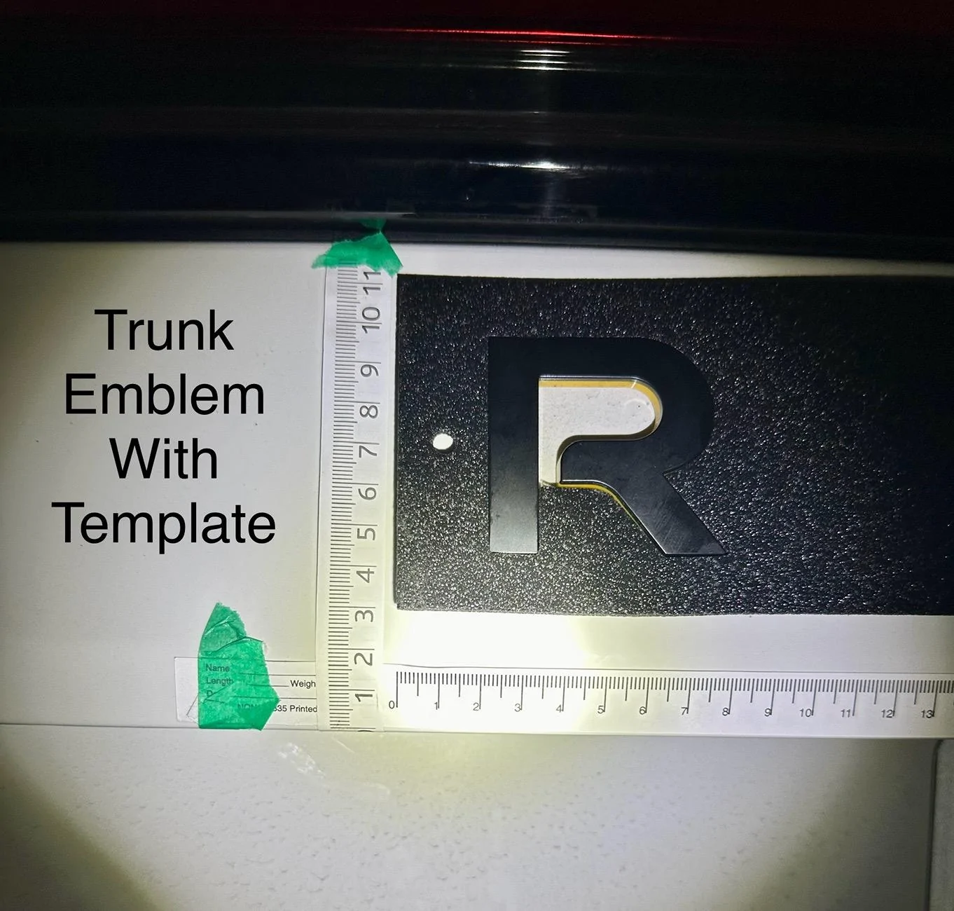

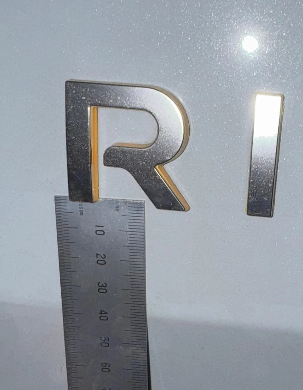

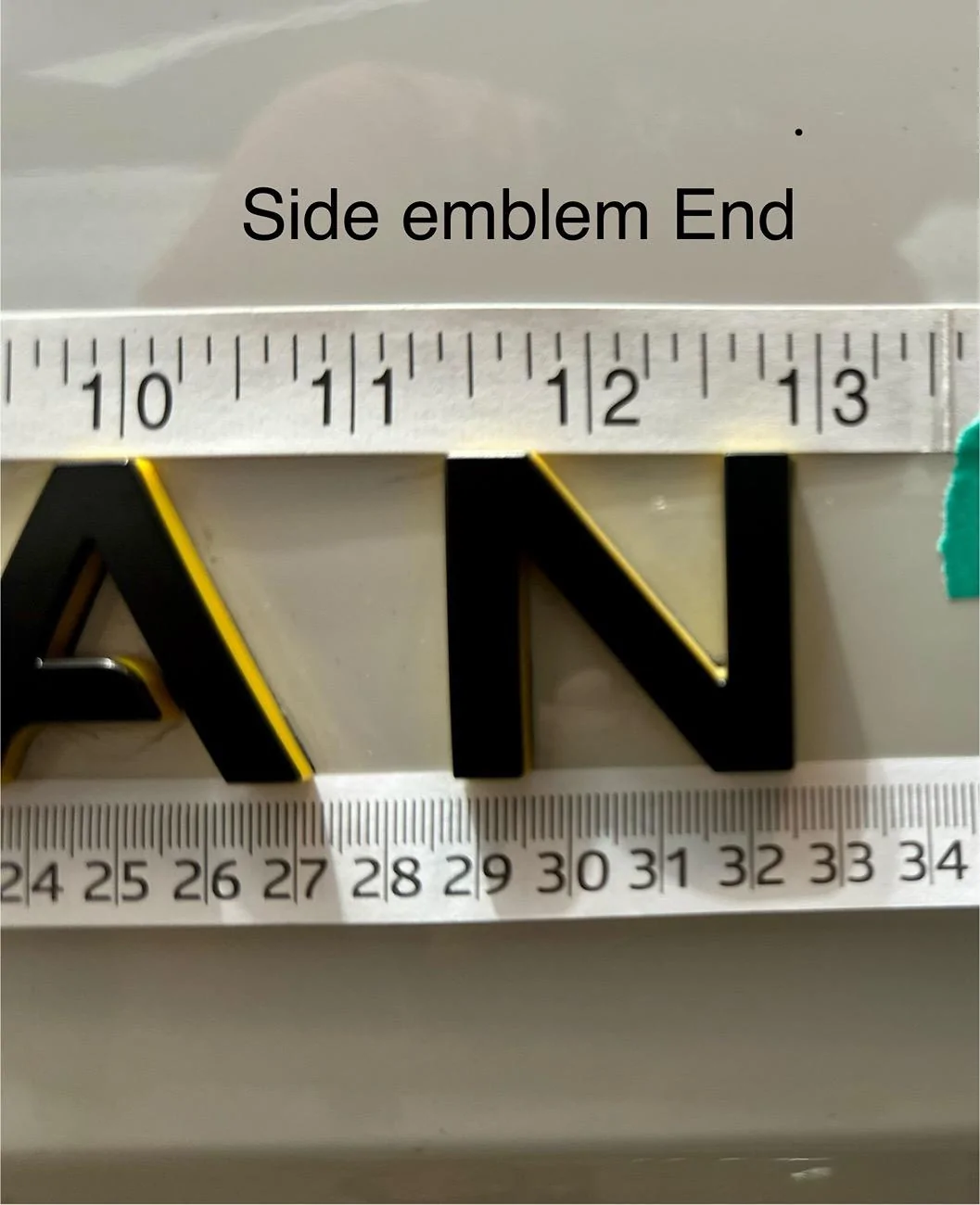

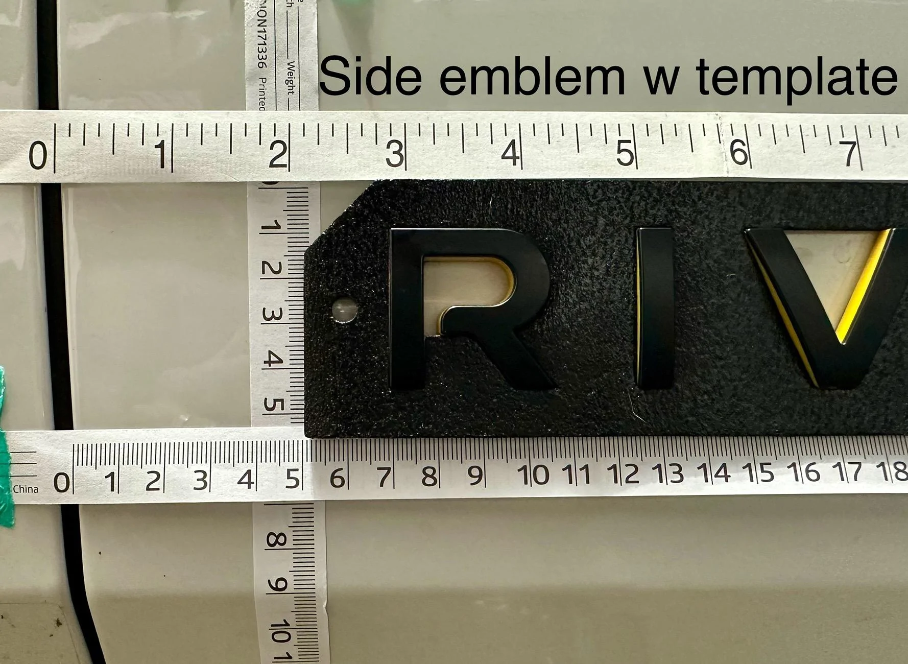

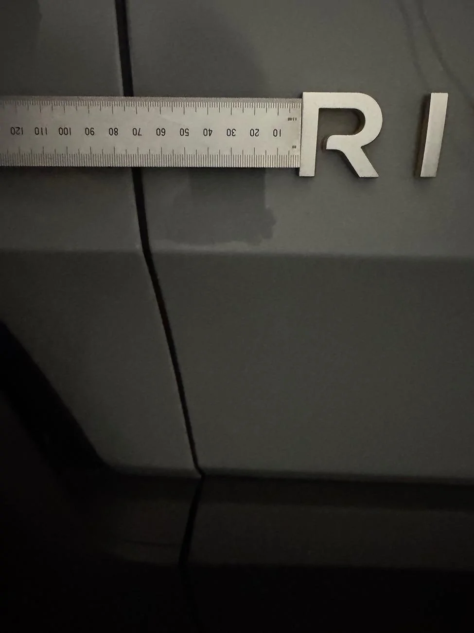

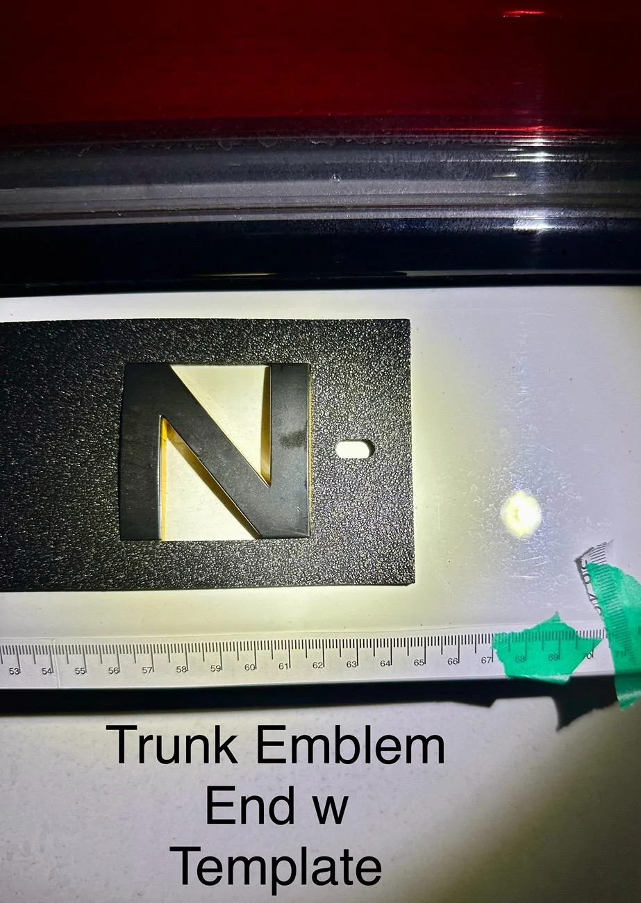

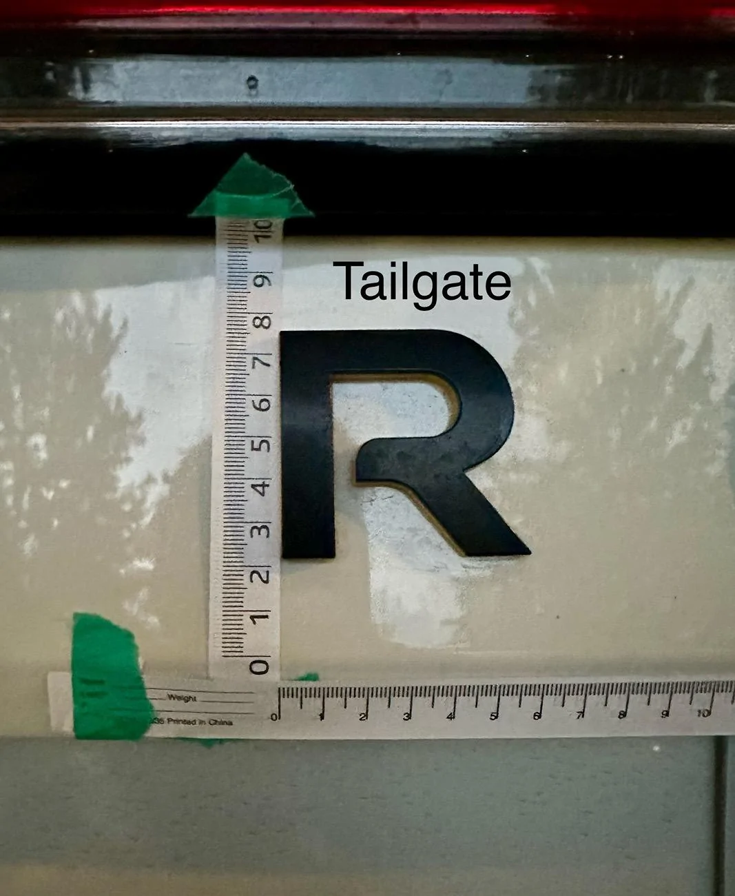

Little late to party hope this helps. Took some photos, adjust for some margin of error - used reference point (side emblem door front trim and bottom ridge, rear bottom ridge)
Also added with the Template that comes from AbstractOcean for better measurements.
Quick shoutout for AO team they were fantastic and definitely recommend for anyone considering mods for your Rivian.

Just came across this. Super helpful! Any chance someone could hook me up with the rear R1S location measurements?
