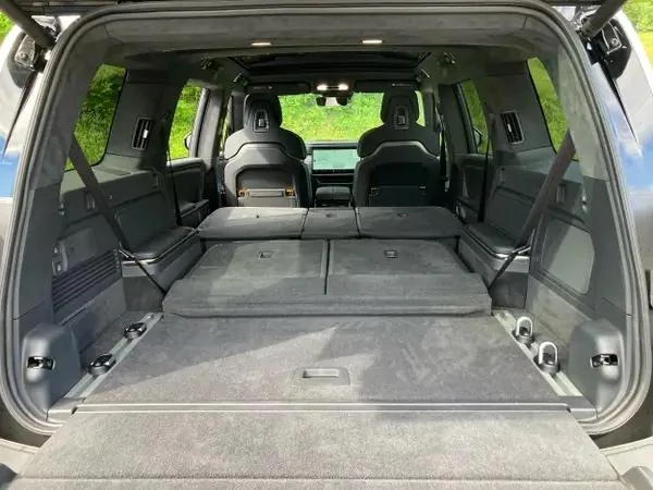

Great writeup of your observations. A couple questions:
1. Do you think the Canadian chargers wouldn’t connect for some software related issue? I thought L3 chargers were generic and independent of OEM relationships. Or maybe it’s some cross-border payment or tariff issue of some sort.
2. How many tie downs did you receive in the back? I only got one per side and I’m thinking we should have gotten two per side for them to be functional.
Note the number of tie downs in the photo.
I only received 1 per side as well.
