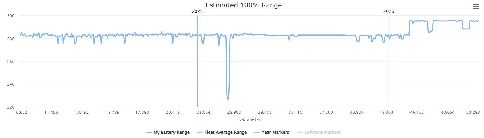

Nothing has happened for us in the last year or two - had some initial teething problems with the displays - so I haven't been around much.
I was wondering what the long term reliability was like...did some thread searching...and saw battery degradation mentioned. Hadn't even thought of that, but here's what electraFi shows for me. The jump around February is when I changed the tires (pitched the old ATs and went with Michelin LTX MS/2). Hard for me to see any change.

So the Michelin's improved your range by about 5%? Interesting.

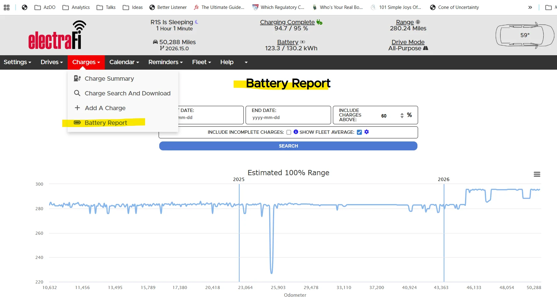

Very cool! Mind sharing how you got ElectraFi to assemble that graph?
Here you go - sadly the "Fleet Average" doesn't display and the "Software Markers" generates an error - c'es la vie.

google says the EPA range is 315miles, but you don't even break 300. Any idea what's going on here? Do you have the lower efficiency tires installed? I am solidly getting the EPA rating out of my Lightning except on the highway, which I almost never use (drafting at 3 car lengths behind 18 wheelers works really well for extending my range on road trips). Do you just always drive at highway speeds? I'm trying to get a feel for how truthful Rivian's EPA rating is.

It’s pretty truthful… …if you know how to cut through their marketing.
OP looks to be seeing around EPA rated range for their config - 20” AT‘s on a quad gen1 large pack.
Rivian get funny by blending drive modes for their ‘headline’ figures - eg the 371 mile ‘rating’ for a gen2 tri with 22” sport is actually made up of the EPA rating of 346 miles in AP mode and the estimate of ~405 miles in conserve.
Also these reports of battery ‘health’ don’t really tell us much other than Rivian were awesome enough to bake in enough headroom to the batteries to accommodate whatever degradation has actually occurred behind the scenes. Eg a gen1 large pack is marketed at 131kWh, but actually is 141kWh gross - Rivian do some cool stuff to keep the addressable capacity as high as possible within the envelope they have marketed the pack at - they really deserve some kudos for that.

Switching from AT tires to AS (or summer) tires will always give you better range, as OP's data shows. AT tires are the worst for those concerned with range.

How did you get this report?
I'm at 105K and shows about 7% degradation.
