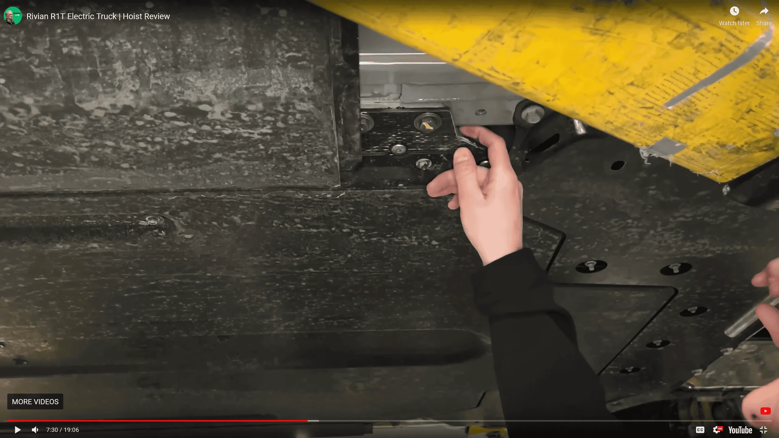

Thanks for this. I’m still confused though.
When Sandy Munro did his suspension overview and review of the bottom of the truck, he clearly talks about the truck having the off-road package. That truck also clearly has the grooves that are shown in your second, non offroad photo.?.?
https://www.rivianforums.com/forum/...eview-by-sandy-munro-amazing-suspension.4339/
I would have to watch his video truly comment but from what I can see in the title screenshot maybe he had already taken the shielding off? I’ll watch the video and see if I can clarify.
update: that truck in Sandy’s video definitely does not have the reinforced shield. That plastic plate is the regular on-road underbody, for sure.
I actually just rewatched it, and he doesn’t explicitly state it has the package. I though it was the truck he bought and it had the package, but I could be wrong.
Your photos seem to make it pretty clear that there’s a visivble difference. Intriguing!

In sandys video they have the Carbon Fiber Layer right here. You can see its carbon fiber.
That has to be part of the battery pack build. Not the additional shielding. The carbon fiber I was shown would be off frame to the right as a panel. They must have removed something to show that piece. The pieces I saw do not require any removal. They are very visible by just getting under the truck.

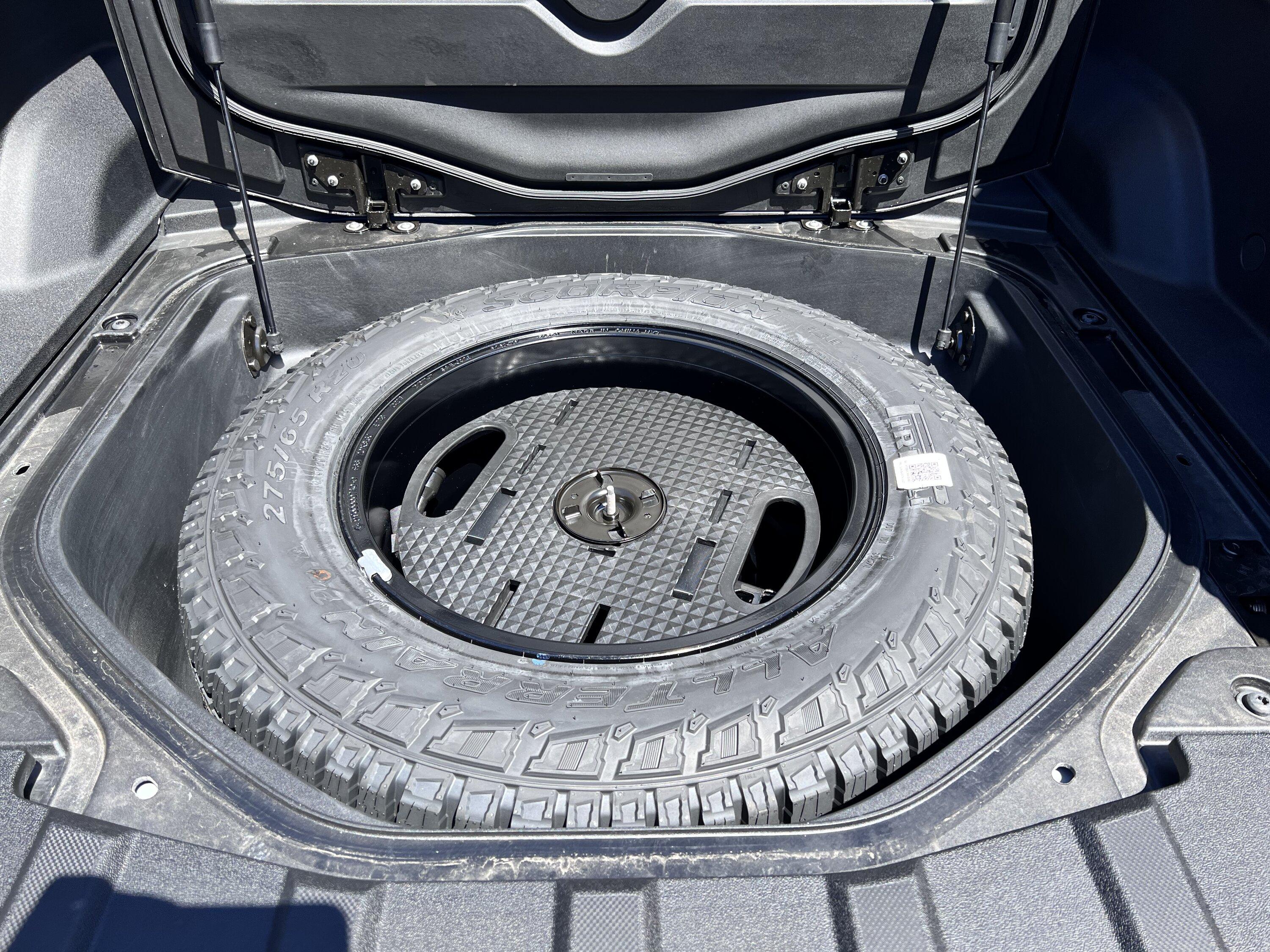

Also one other tip, get the fullsized spare if you are thinking about it. I have the 20 inch darks and I now have a replacement wheel and tire, also in the 20 inch dark. I’m concerned about messing up the wheels off road, but if I do I have an exact spare. I didn’t expect the spare To also be the matching dark wheel. I’m super glad it is. I was told by my guide it’s the only way currently to order a spare wheel like that. Supposedly They aren’t selling them outside of deliveries yet. So I’m super glad to have the full set spare.
Awesome report. Follow up question: Do you feel like the premium was worth it over an aftermarket solution? Even huge plates cost less than half on bigger trucks. My only fear is that there won't be any good off the shelf aftermarket solutions because of the factory option and an ultimately low volume model.
If Rivian won’t sell an individual wheel then that means R1S buyers who need a full size spare to go off road cannot go off road. Much worse, however, is that an R1T without a full size spare and all R1S owners cannot drive their vehicle if they damage a wheel to the point that it is unusable until Rivian changes their policy or there is an aftermarket wheel available.
Either the statement made by @Alex D ’s guide was incorrect or this seems like a significant problem for anyone who could damage a wheel off road, damage a wheel in an area with bad potholes, or end up in a crash that damages one or more wheels. That is potentially everyone so I’m hoping the guide didn’t explain this policy quite right.
