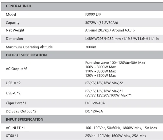

I thought I was on to something when I found the Pecron F3000LFP (currently $799 on Amazon), which allows up to 3600W of output with a maximum of 1800W AC input that you can limit the AC by percentage to, for example 80% (1440W). I emailed their technical support (they were very responsive) and learned to my dismay that, like the others, it jumps to "UPS Mode" as soon as you plug it into AC input and you're limited to 1800W, or half of what it can output when it's not plugged into AC. Don't plug it into AC and you can draw up to 3600W until the 3270Wh battery is depleted. So I'm basically looking at the same solution you came up with as option #2: Using the Solar Input and a DC charger to add juice to the battery while it's being used.

My advise is to go as high as possible for DC voltage. If your unit can take 100-110v,aim for that voltage. I was about to pull the plug in another DC PSU but it wasn't adjustable (110v DC and. 1500w) and good thing I didn't since depending the load, above 1000w it gets twitchy.
Thanks for the advice...Love the technical term "twitchy" :) The Pecron will take DC input up to 25-120Vdc, 1600W max, 25A max:
I've bookmarked this thread - as I go to improve my energy game for camping and tailgating this year I'll definitely make use of your efforts!
I would then run anything between 100-110v DC to have some marging and you should be great.
