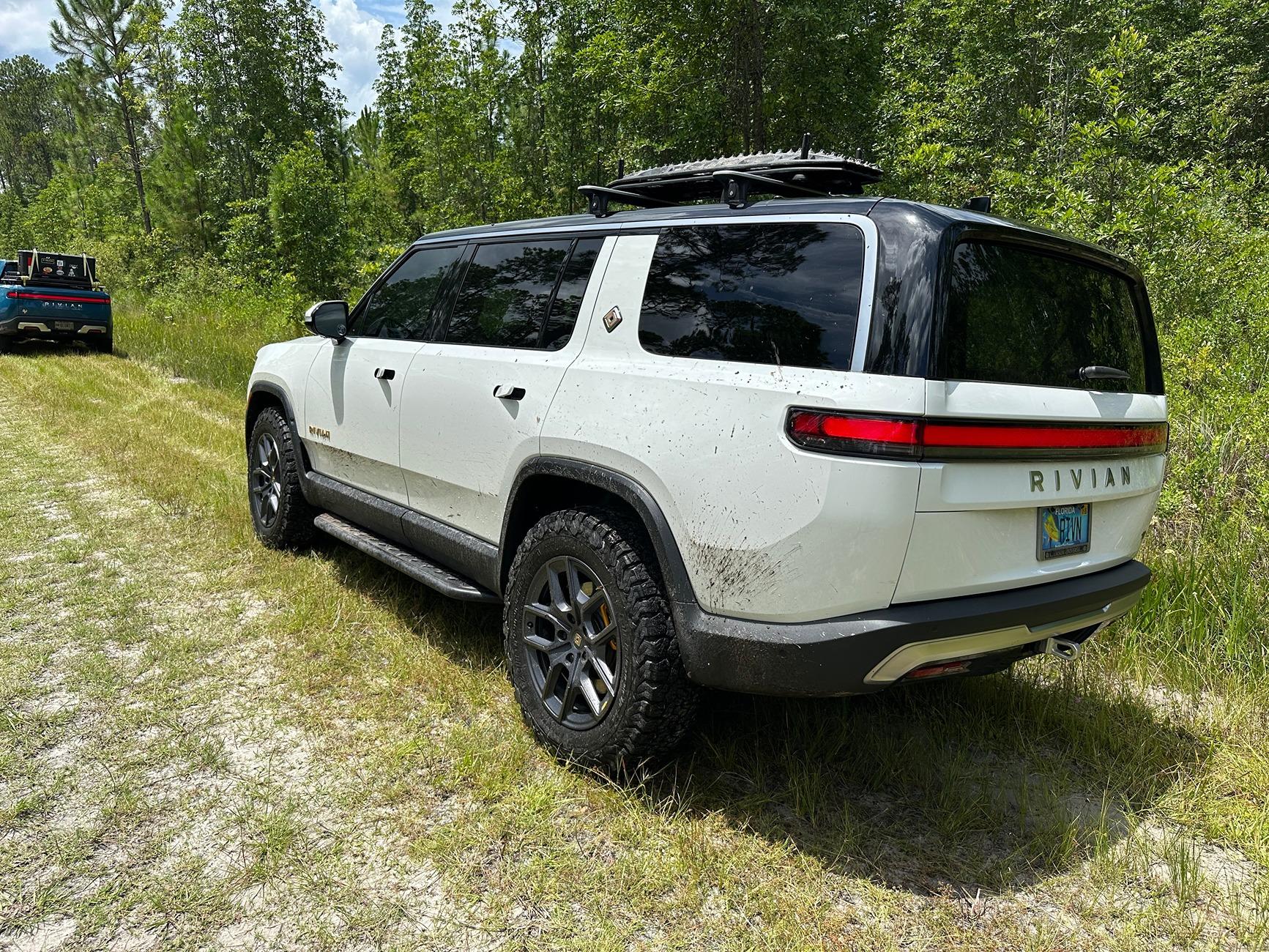

I have 27k miles on my KO2s and I keep them at 60 PSI cold and rotate every 5k miles.
I suggest doing a chalk test with any non-OEM tire. Check youtube for instructions. I did the chalk test a couple of times and found that 60 psi was the sweet spot for these tires for my R1S. Chalk tests are fun to do with your kids.
I've been super happy with the performance and treadlife with smooth even wear. I don't take tread measurements myself, but at each 5k mile rotation I've walked around as the Discount Tire guys do the inspection and they've always been impressed with the even wear and good tread life. I make a point not to launch with these tires, but I otherwise drive relatively aggressively and I've been very happy with the performance.
