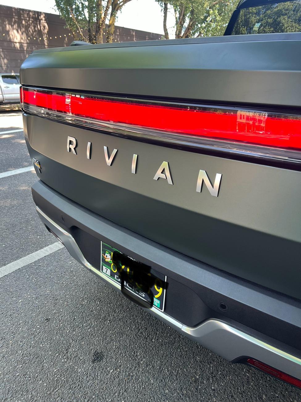

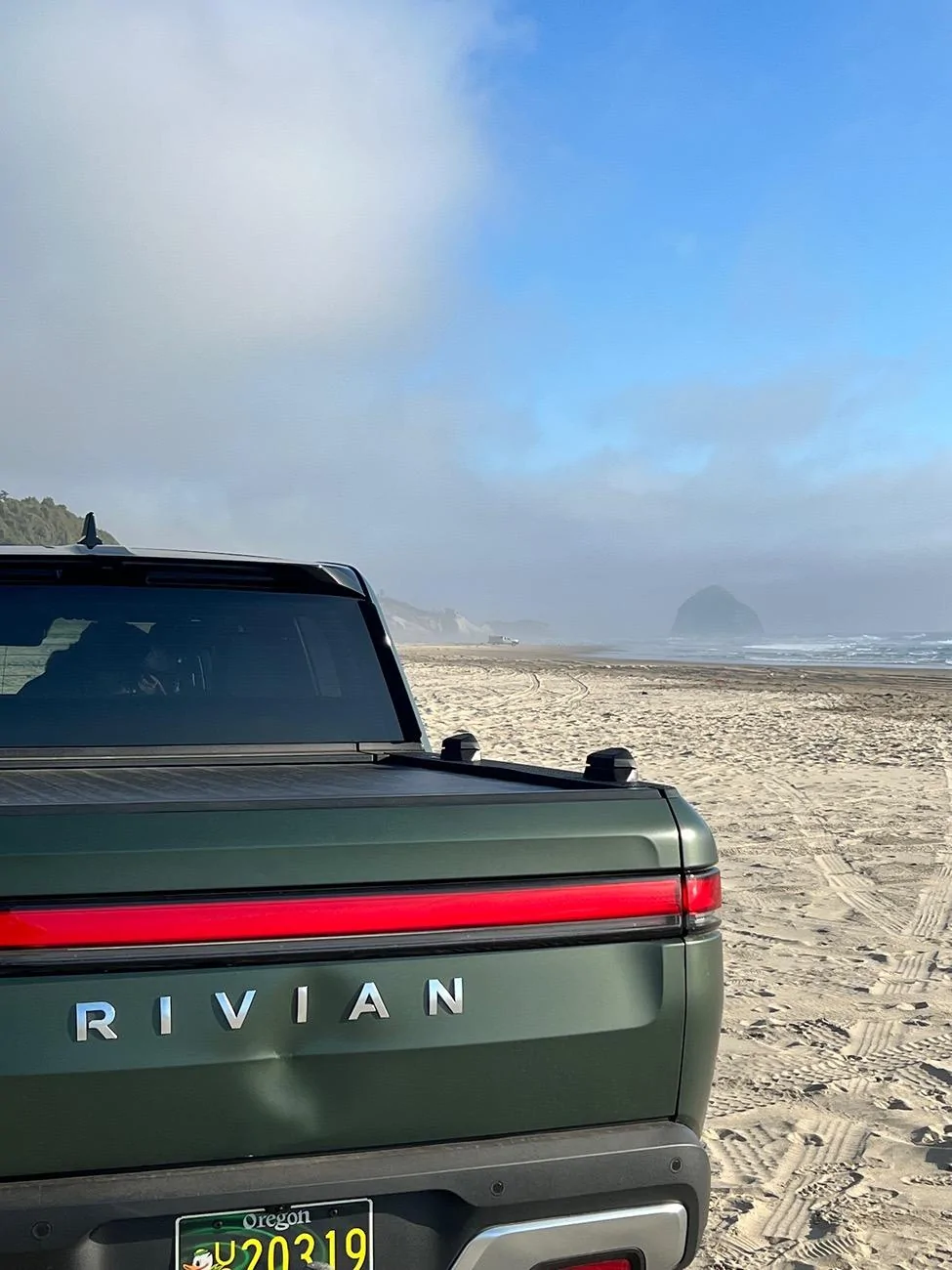

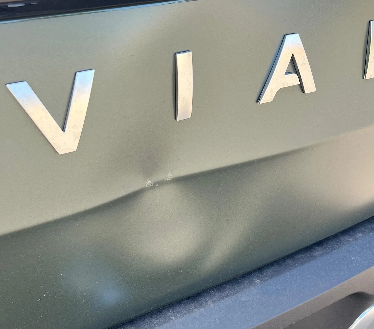

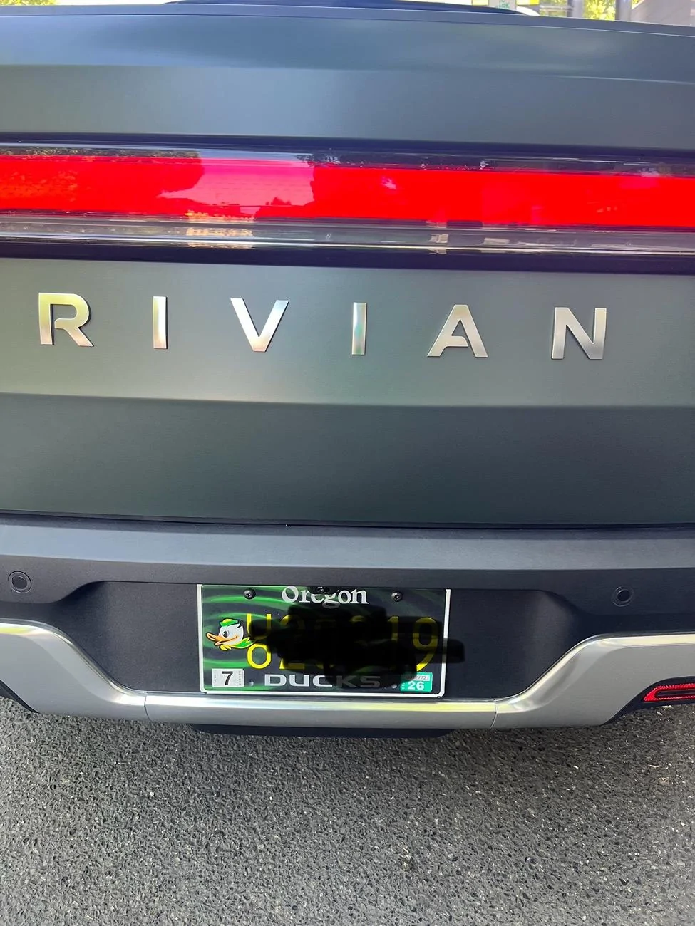

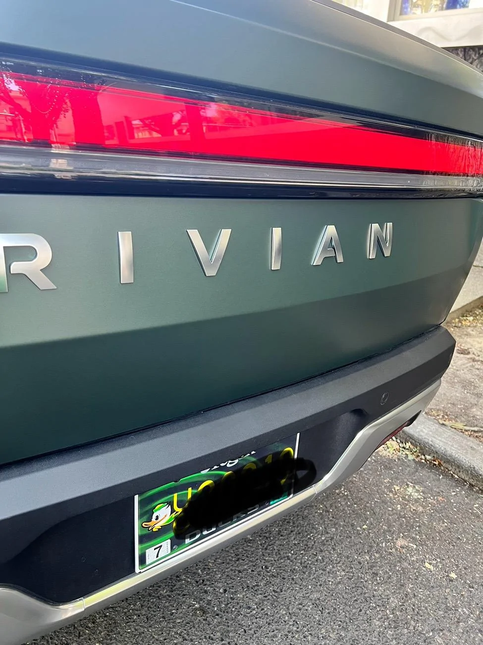

PDR is amazing! 3 weeks into owning my R1T I dented the center of my tailgate when I did not pay attention to the height of my new hitches ball. I had 2 PDR guys in Portland say it couldn’t be done. My insurance sent me to one of their certified body shops and the estimate was around 10K. A member of the Oregon Rivian FB page suggested a PDR guy who had done several Rivian. He said it would be no problem. Overall it was just under 2K, half of that was the removal and re-application of my PPF wrap. Still amazed that there was no evidence of the dent when done.

You’re lucky. A lot of PDR folks won’t guarantee working on aluminum panels (like Rivian’s) as they don’t have “memory“ like steel. A lot more work. Also the metal is thinner and can easily crack, especially if there is a crease. That guy was a real artist. As an aside, the same goes for actual body shops. Most won’t even try to straighten/fix but will want to replace a whole component. This happened to me in my eTron with a dent and small 1/4 in tear at the edge of the liftgate. Searched around and found ONE body shop that was willing to weld aluminum and they fixed it at a much lower cost.

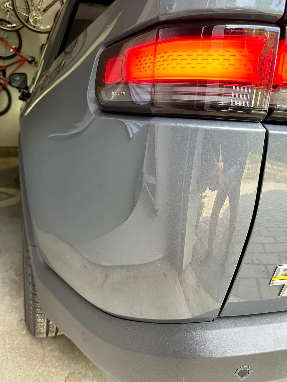

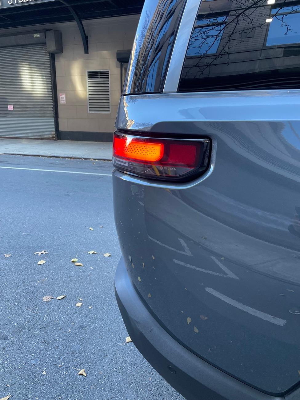

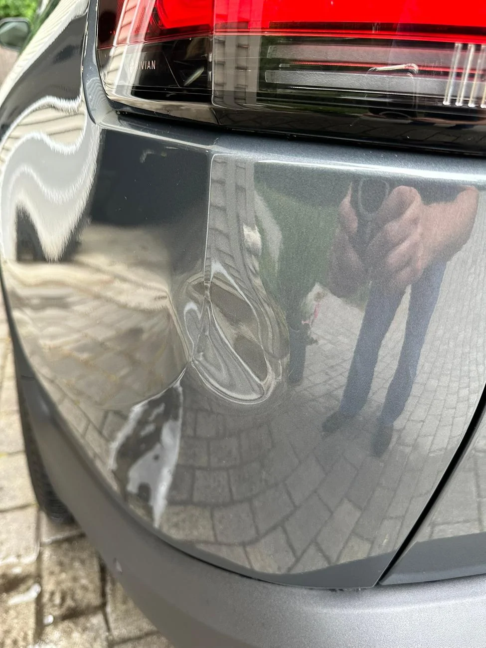

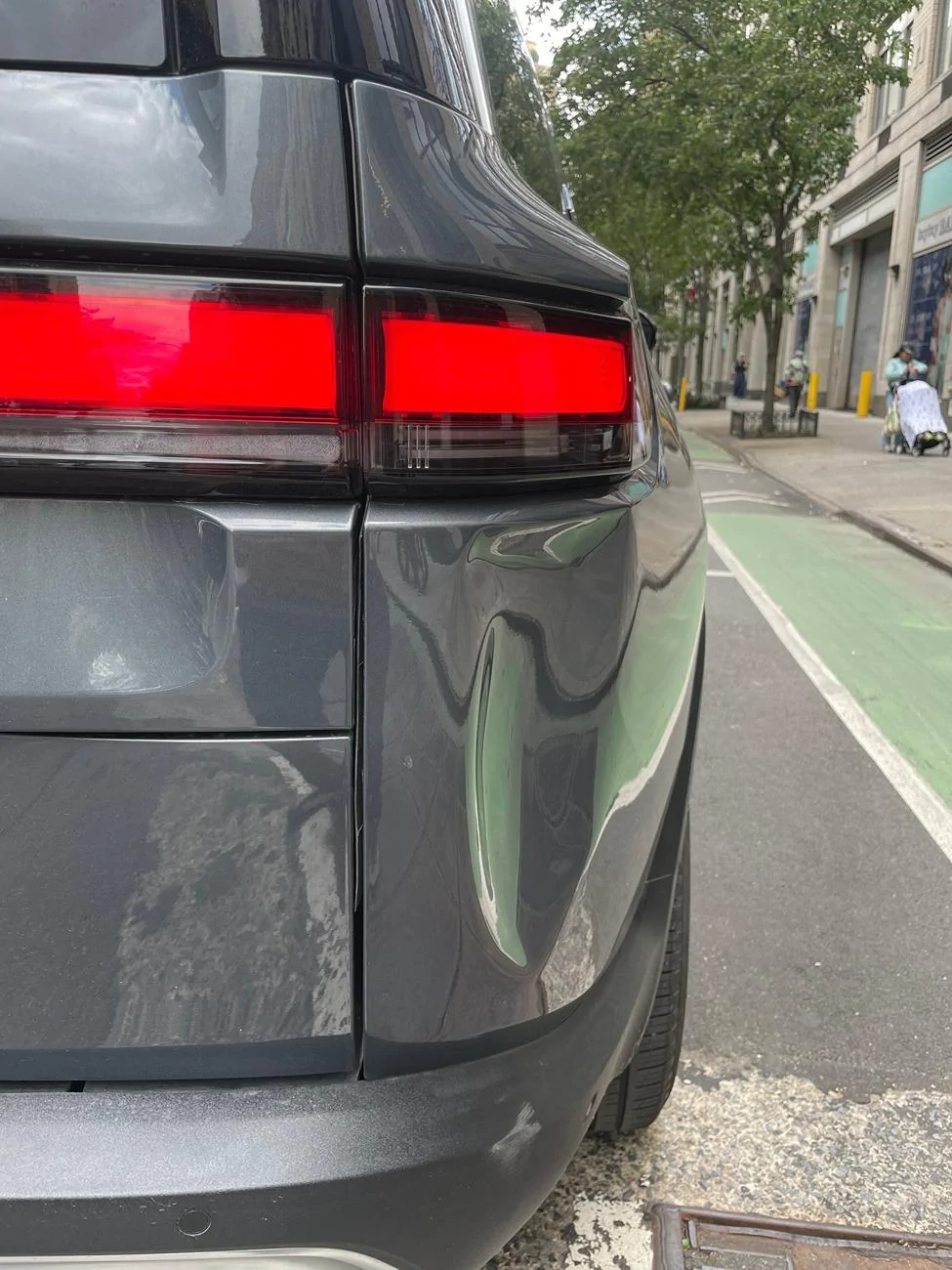

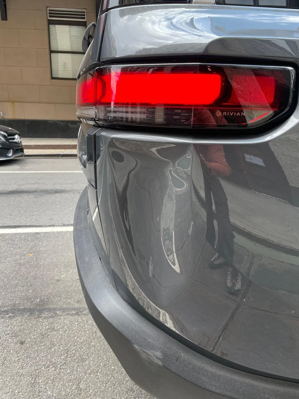

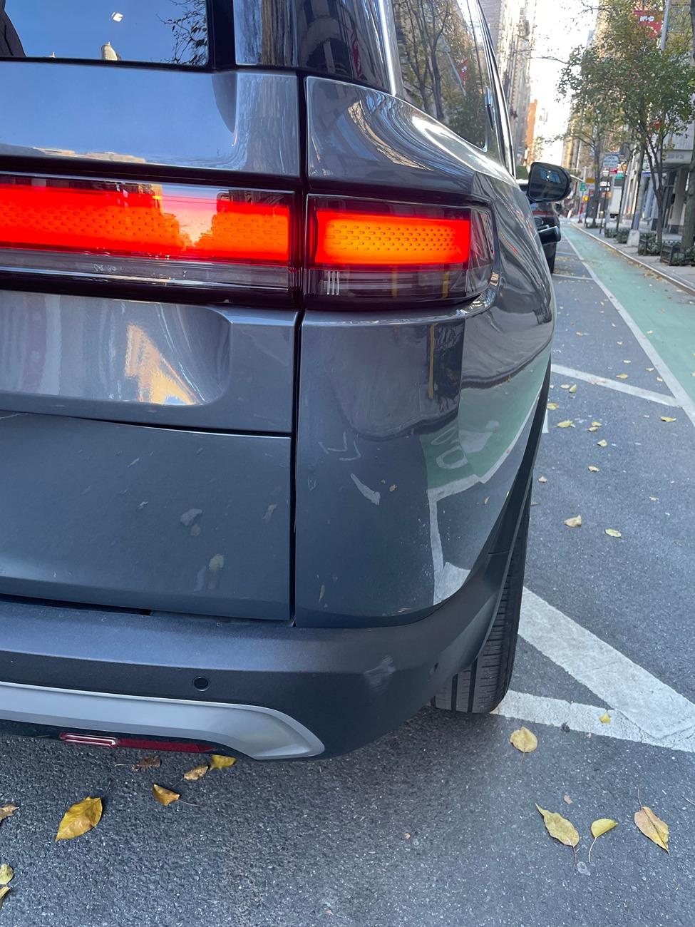

Thank you for sharing Mike's information. He was a very nice guy. My dent was a little too large for him and he referred me to a shop in NJ that did a great job. For those living near the New York tri-state area, I had a similar experience. Our parking garage put a dent in the back right corner of our R1S. The Rivian-approved body shop in NYC said it would cost at least $13,000 after seeing the photos. They said they needed to order the entire right-side panel of the car from Rivian. Cut off the back quarter and replace the back quarter of the car, then bondo and paint. After some research, I managed to find a PDR shop in New Jersey that could handle the task. They held our car for 5 days and did a fantastic job. See before and after photos. The company name is DentCo Paintless Dent Removal, 973 903-0826. The owner's name is Anthony.
By the way, the job cost just around $3,000. At least a $10,000 saving.
