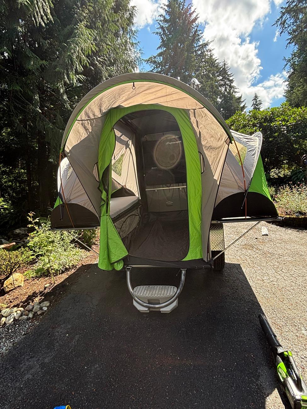

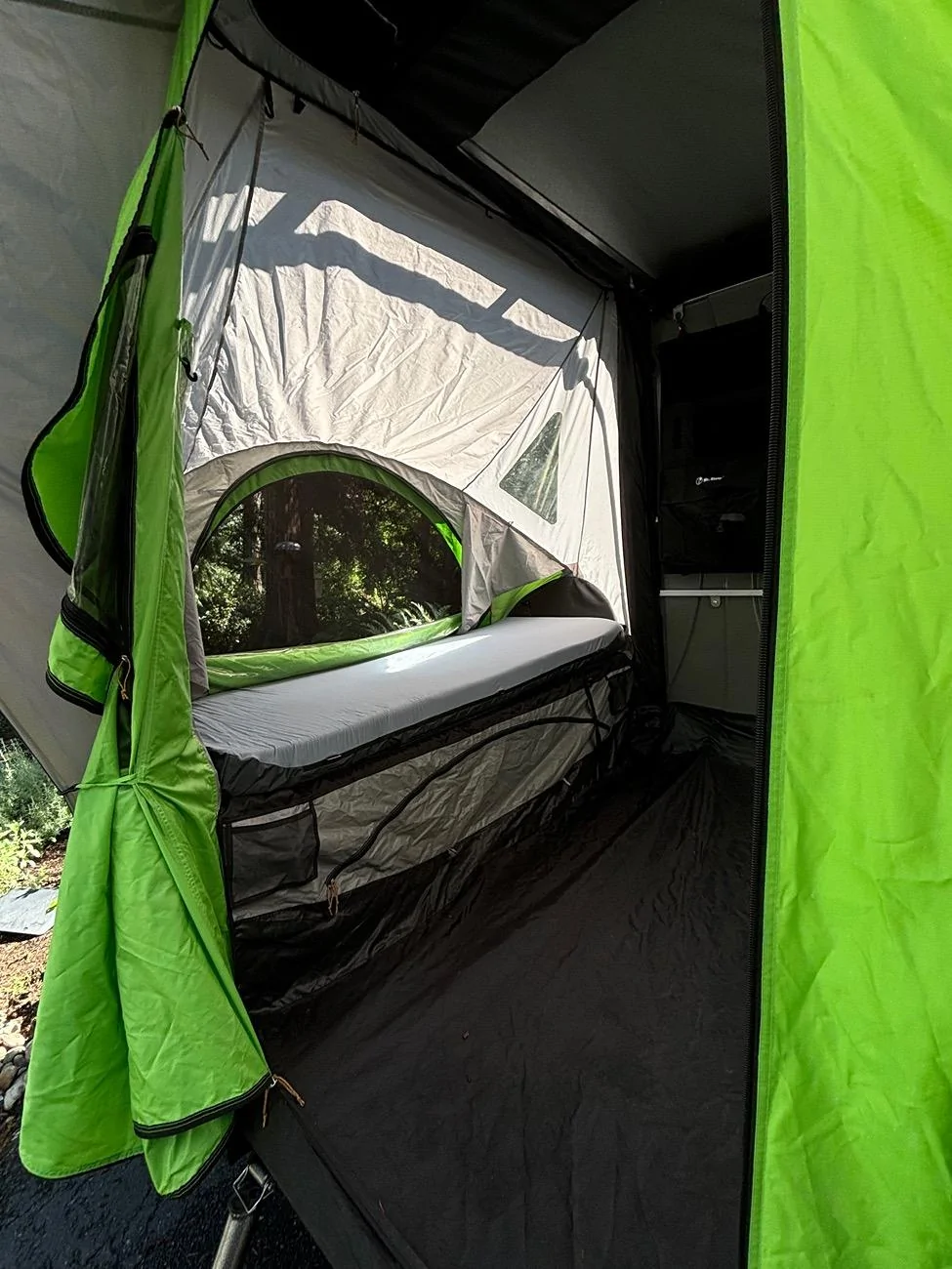

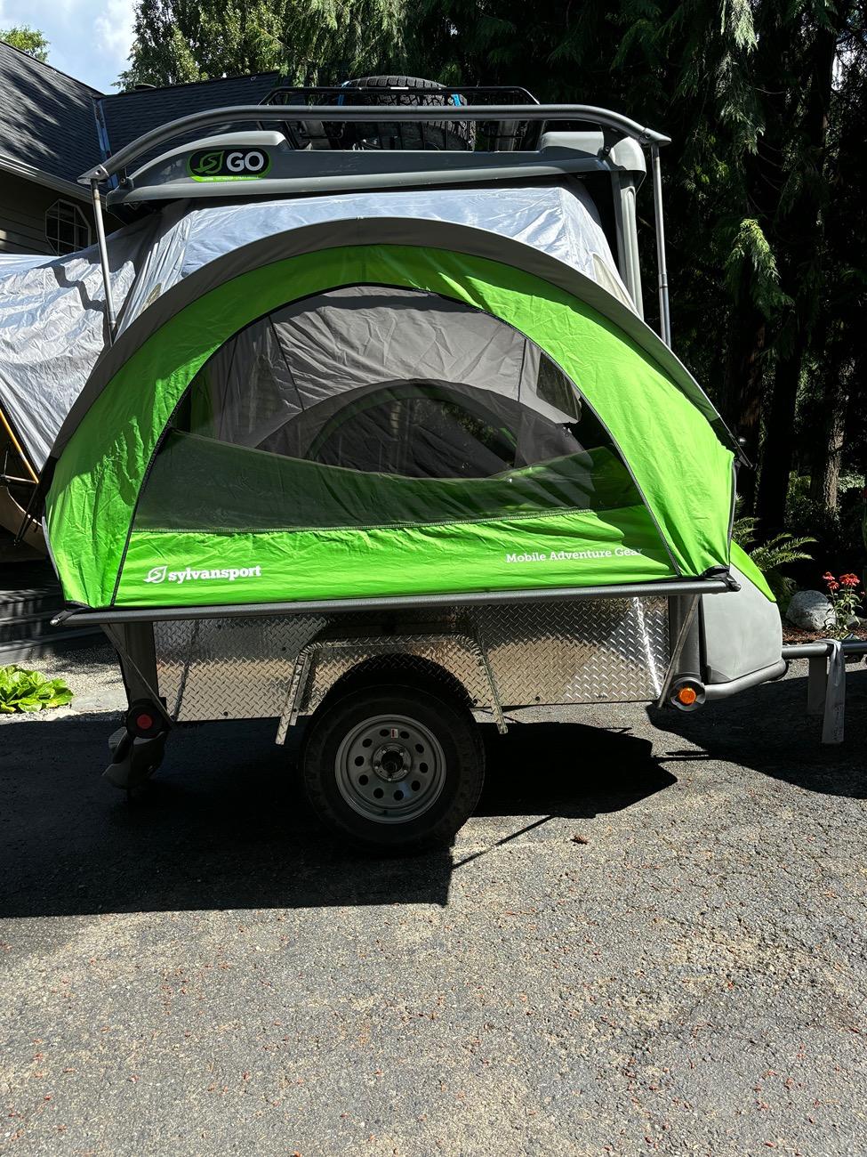

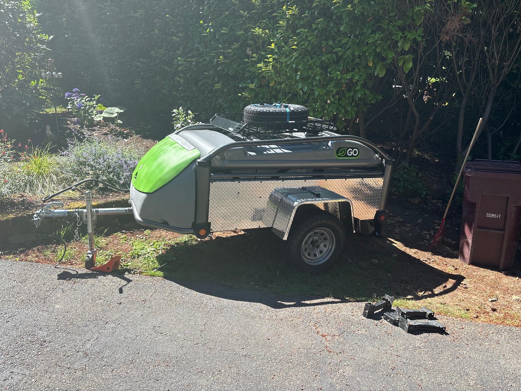

Not sure how many folks have tried a RTT- but fo my wife and I the main problem was having to set up and tear down every night as we go exploring during the day.
We found a great condition used Sylvan GO camper and love the space, but it had a couple of minor problems as well.
1. It is not set up for off road
2. Unless packed well small items could (and did) fall out of the trailer (user error)
3. Items in the trailer were visible and others could be tempted to help them selves.
I just finished upgrading mine To address these issues.
Inspired by the new Sylvan GOAT (GO Anywhere Trailer) I figured that I could retro fit mine for about $2k and not have to invest in a new one.
Upgrades:
1. All terrain wheels and tires
2. Diamond plate sides
3. Diamond plate fenders
4. Fender side marker lights
5. Cargo Rack & spare tire
6. 24” stabilizers to make up for the increased clearance
7. Back diamond plate “door” to keep stuff secure
8. Extensions for rear step (to make up for the increased height)
Still looking for my first chance to take it out and get it dirty.
