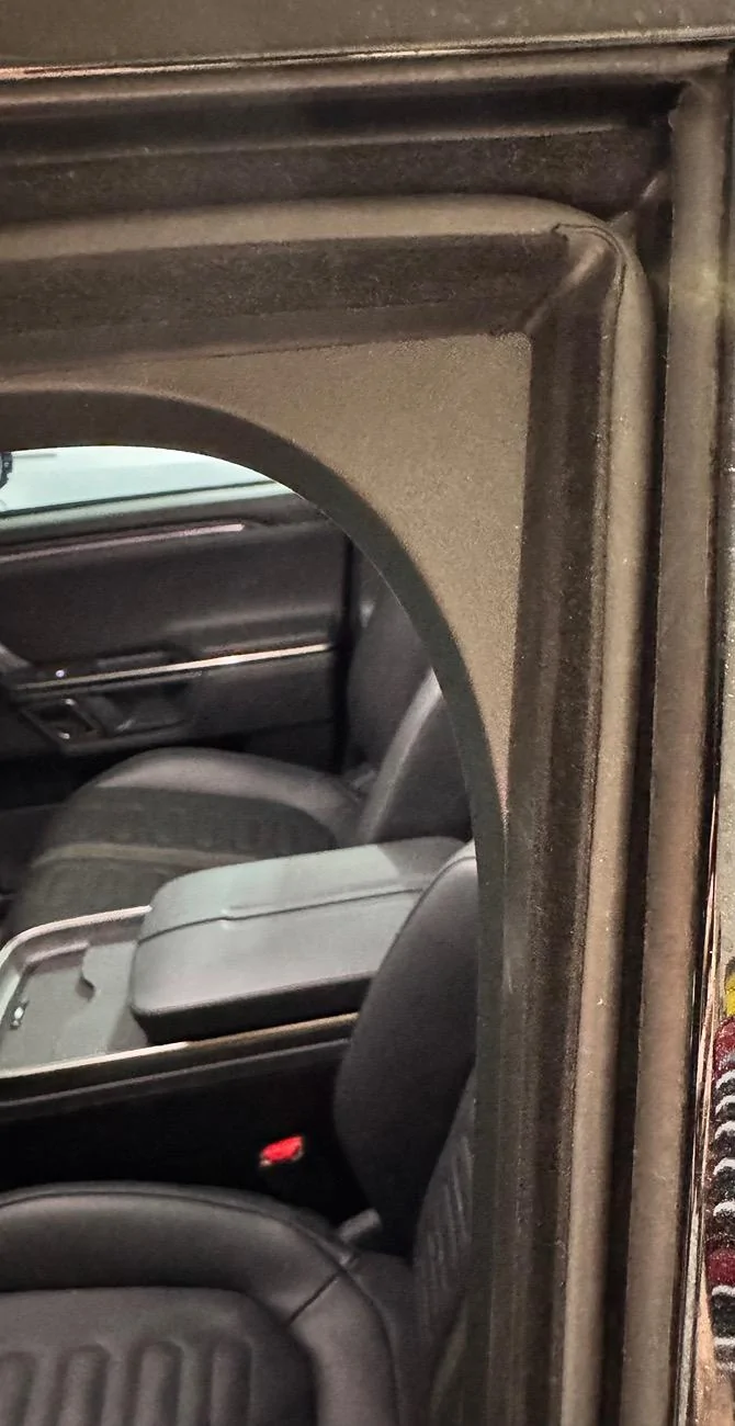

This worked for me, but obviously you mileage may vary. I have been having an issue with pretty significant wind noise from driver's window at highway speed most noticeable when going above 60 MPH, and being I am Texas where most highways are 70 mph and above that is a lot of the time. My R1T is a 7000 VIN, and about six months ago mobile service replaced my triangular window with the improved gaskets which helped, and changed where the wind noise was most noticeable. Initially you could almost seem to feel it coming from the triangular front small windows, afterwards after that was fixed, the most noticeable wind noise seems to be coming from the top of the driver's window. At Rivian's advice I tried recalibrating the window a bunch of times, and looking at the window and door gaskets they all seemed to be in place, and fine. Rivian had my R1T in service for about 2 weeks waiting on the roof appliqué above the driver's door which unfortunately did not help. One of the issues to showing the issue to Rivian is that my closest service center is in Austin and there is so much traffic during business hours that it is really challenging to get on the highway and not have a lot of traffic to get up to speed to demonstrate the wind noise.
After reading through a bunch of posts I tried buttressing the gasket that pushes against the driver's side window. I placed the gasket in one piece from the right below the level of where the window comes out, counter clockwise behind the gasket as far forward as I could. On the recommendation on another thread I tried 0.25" solid rubber seal, which for me disappointingly did not make a difference. On a hunch thinking that my gasket might just need even more support to create a seal I moved up from the 0.25" to 0.35" and that has done the trick. I have had no problems opening and closing the window, and weirdly it was better, but wind noise was slightly there, but after a few days of usage has gotten better to where my wind noise is now gone. This gives me hope that Rivian could come out with a more robust window gasket in the future that could fix this issue.
https://www.amazon.com/gp/product/B00NL4D6SK/ref=ppx_yo_dt_b_search_asin_title?ie=UTF8&th=1

Hello,
Do you happen to have a Pic of just the gasket by itself and where to buy it would help me allot.
Thanks in advance...

Can you send different angles and point out where you installed?

I bought the linked item and tried it on my driver door window. The window would slow down to a complete stop a little under midway from what I assume to be too much pressure coming from the new seal. I pushed it in as much as possible. Maybe I'll try the smaller diameter or the rubber tubing and see if those work.

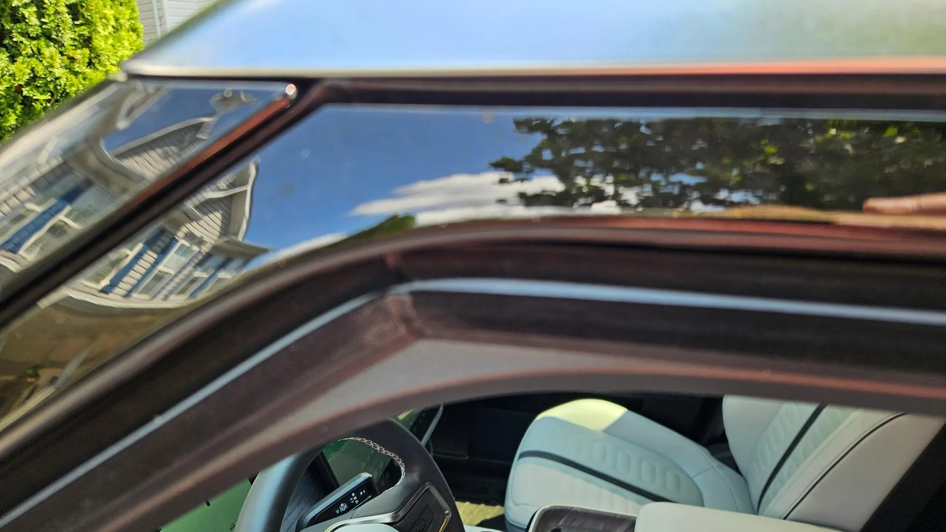

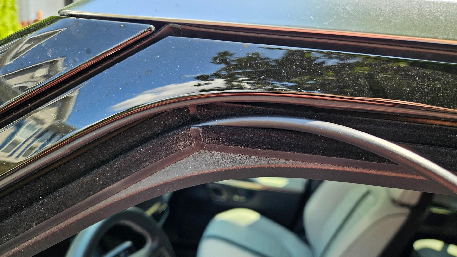

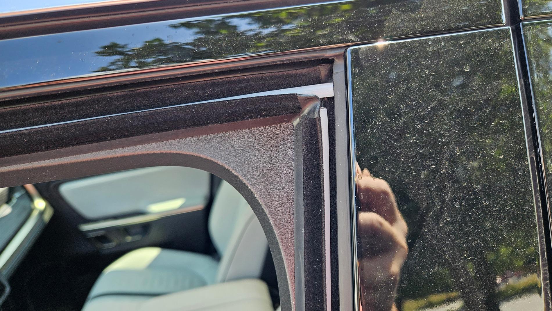

I have had the triangle window rebedded by the SC and it helped a lot but still had some noise from seemingly the a frame. I saw this, but didn't want to order the $25 weatherstripping so I thought I would try Ridgid .25 ice maker line. It worked great.
I was almost ready to buy the weatherstripping, but wondered if I would need the larger diameter because it wasn't going to be rigid. Then I thought I really just want to keep the rigid stuff at .25 but I didn't like the color of the clear / white. Then I remembered I am big into drip watering systems for all of our plants on our deck and porch and have big rolls of .25 Ridgid tubing in black. I got that out and put it in and it works great and looks great. There are no issues opening or closing the window. I did both driver and passenger side.
I consider doing the second seal that is higher up on the door but it's not quite as deep and so the tubing doesn't want to stick in there as well and I don't think it would make it any quieter as it is near silent now.
If I ever need to I might put some 3M automotive door seal adhesive on it to make sure it sticks in place. You can see a thread I put about that in the forms here for sticking the rear tailgate adhesive back up if it comes off.
