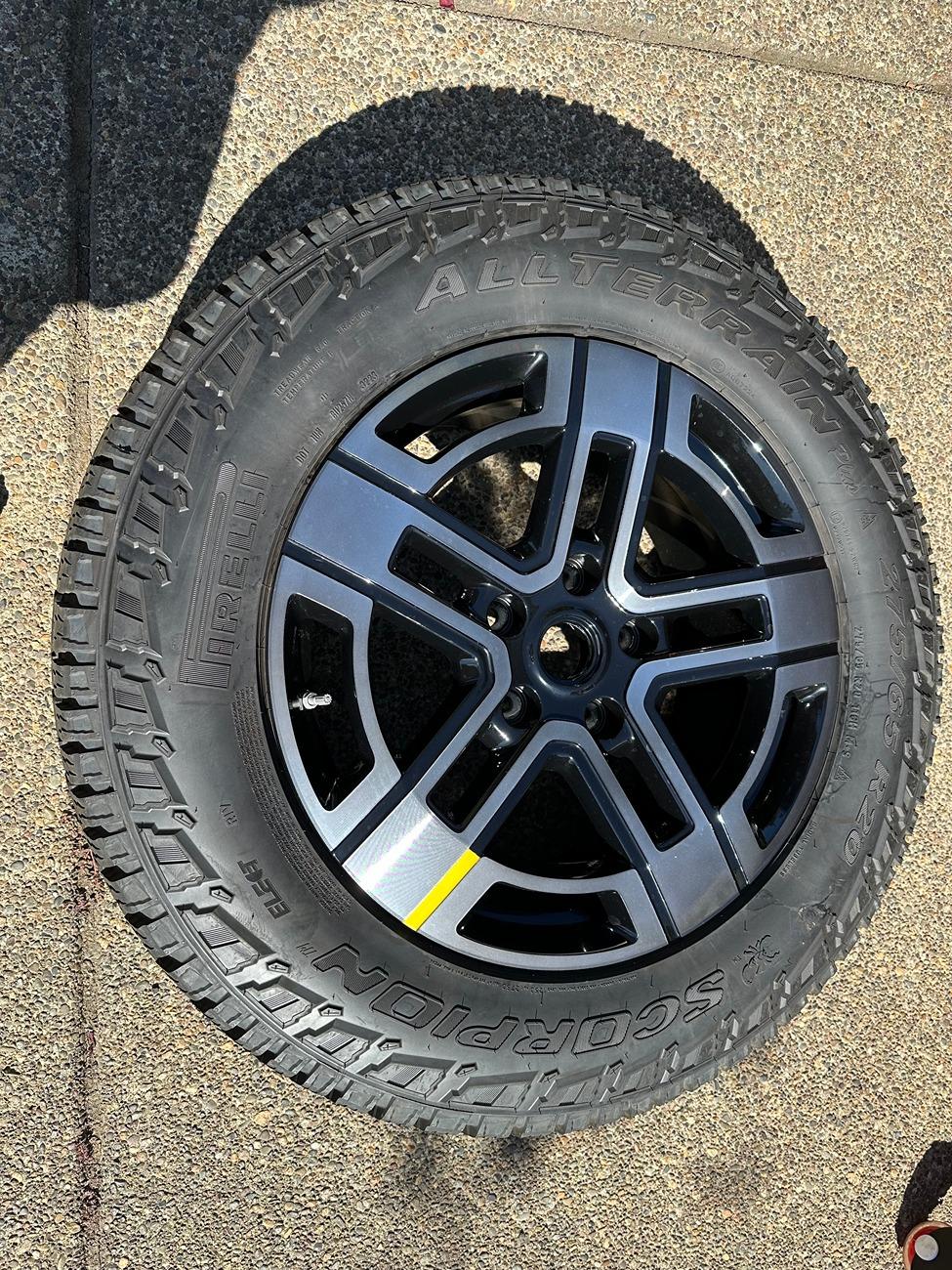

Sharing my $520 build of a full size spare. ebay special. Looks new, tire wear matches tires on truck. No damage to either. Not 100% perfect but not bad for spare!
10/32 OEM tire. $150
Used OEM Wheel. $280
Compatible TPMS $45
Mount and balance $45
Rivian R1T R1S Low cost full size spare solution IMG_4370

Nice! I need to get off my ass and do this myself - good to see with a bit of effort it’s achievable though!

I wanted a fully working spare. And for $45, why not.

both good points.....thanks for sharing.....now i just have to find a single used R1T wheel someone wants to sell....

Great find! I did the same but ended up paying a fair bit more for the wheel. Still cheaper and easier than trying to get one out of service.

Ditto and we can also now do 5 tire rotations.

The dirt-cheap option, and kind of the only option if you have dark wheels, is a GM wheel. The ones from the Hummer and some trucks fit directly. Obviously it won't match. This is what I have and I'm trying to find a deal on a dark wheel so I can do five-tire rotations.

No, both T and S are on same wheels.

Tire Rack has several wheels that will fit the T or S and are under $300. Their MSW Type 52 is about $280 and looks very much like the stock black wheels. It also has the same offset and hub size as the stock wheels, and of course the same bolt pattern.
