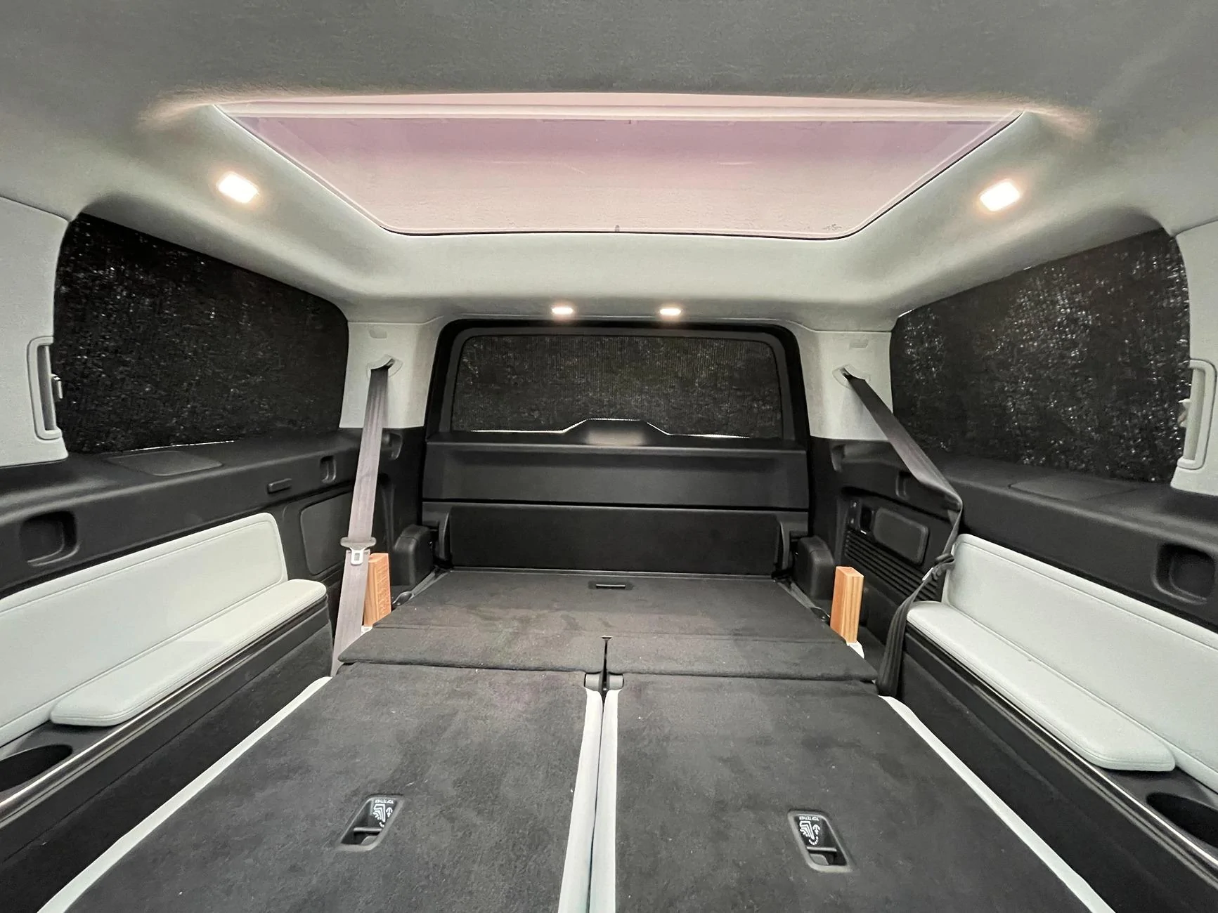

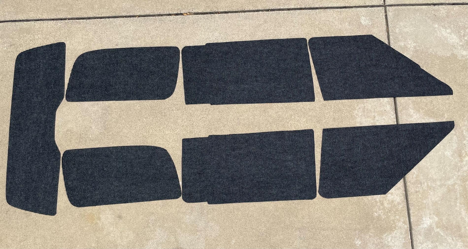

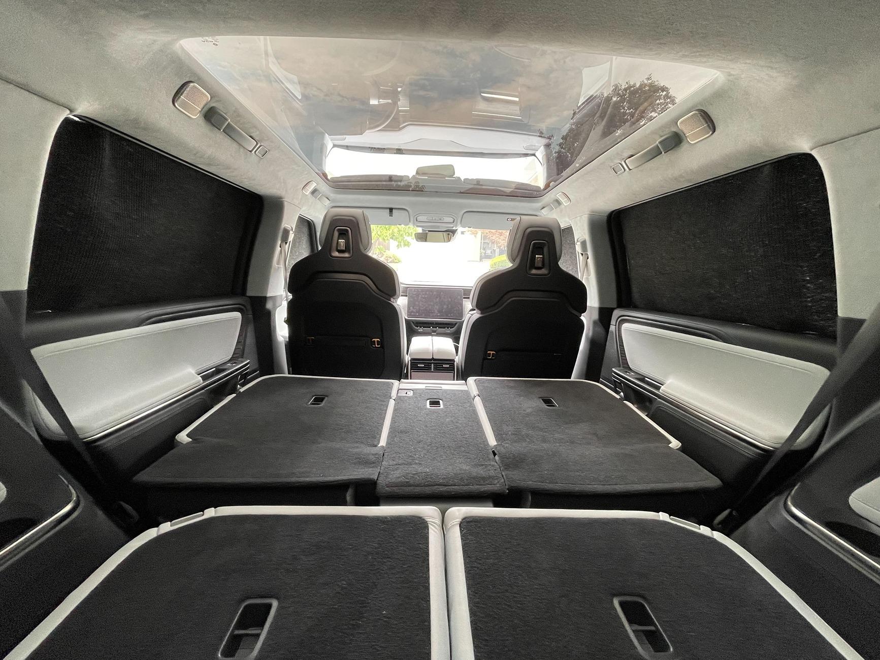

I've wanted some black-out shades I could use while camping but didn't want to spend $100s on something like this. I've been thinking about making my own for a while and finally got around to it when I ran across a 6'x9' roll of indoor/outdoor carpet at Costco for all of $18. I figured it would be perfect to seal out the bright sun to be able to sleep in longer.
These pictures can sorta give you an idea of how well they block out the sun. They're taken mid-day today. I plan to buy shades for the windshield and roof unless I can find better material to make those out of. This carpet I used is fine when sitting vertically, but horizontal on the roof and they'd just fall out, I'm sure. I might experiment with doing the roof ones, though, just to see how it goes... maybe install a suction cup in the middle to hold it up and clips along the edges...
Anyway, I drew up templates for all of these and then created printable PDF files so anyone can just tape all the pages together and cut out your own, if you feel like it. You can find all of that here: https://www.printables.com/model/940141-rivian-r1s-window-templates
This feels a little premature given that I haven't even tried them yet, but wanted to share anyway!

How many of those clips did you 3D print/use?
I think I only ended up using 4 of them for the trunk window. The clips are actually pretty small.. probably too small. I wanted them low profile but I remember having them fall out a few times. You should try for yourself though and maybe scale them up to 150 or 200%.
If I remember right, all the side windows stay in place pretty well in their own so I didn’t need clips for those (I haven’t used them since last summer).
I did end up cutting one for my windshield too and just roll it up and keep it in the spare wheel storage in the trunk. If you do the same I suggest making it a little extra wide because after a few uses, my bubble wrap has creases and doesn’t sit perfectly flat anymore on the window. As a result, it’s slightly too short and some light gets in in the edges. So just give yourself a bit extra.
I also tried cutting sunroof ones out of the bubble wrap, which kinda worked. Because of the weight of them they would eventually droop and then fall down. I ended up just ordering the BestEvMod shades for those and they work pretty well.
I hope it all goes well!
