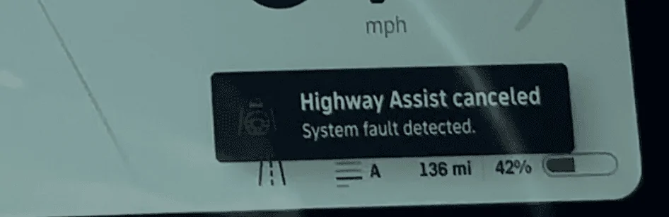

Not sure what the problem was for the commodore but I had about four visits, including mobile, until my Highway Assist was fixed. This process spanned about 9 months and two spoiler replacements. The engineering team was engaged on two of the visits. It’s my belief that on the first two attempts, they genuinely didn’t have a solution. The issue boiled down to interference to the GPS signal caused by faulty connection but also compounded by EMI from the bed-camera system in some of the older trucks.
Edited for clarity.
So I spoke to service briefly today and they said my antenna was replaced… does this sound like what was replaced on your truck as well ?
Marchin_MTB
Marcin
Jun 25, 2022
1,512
1,979
2015 i3, 2011 Honda CRV.
Yes. Except they just replaced the entire spoiler assembly, which includes the antenna.
