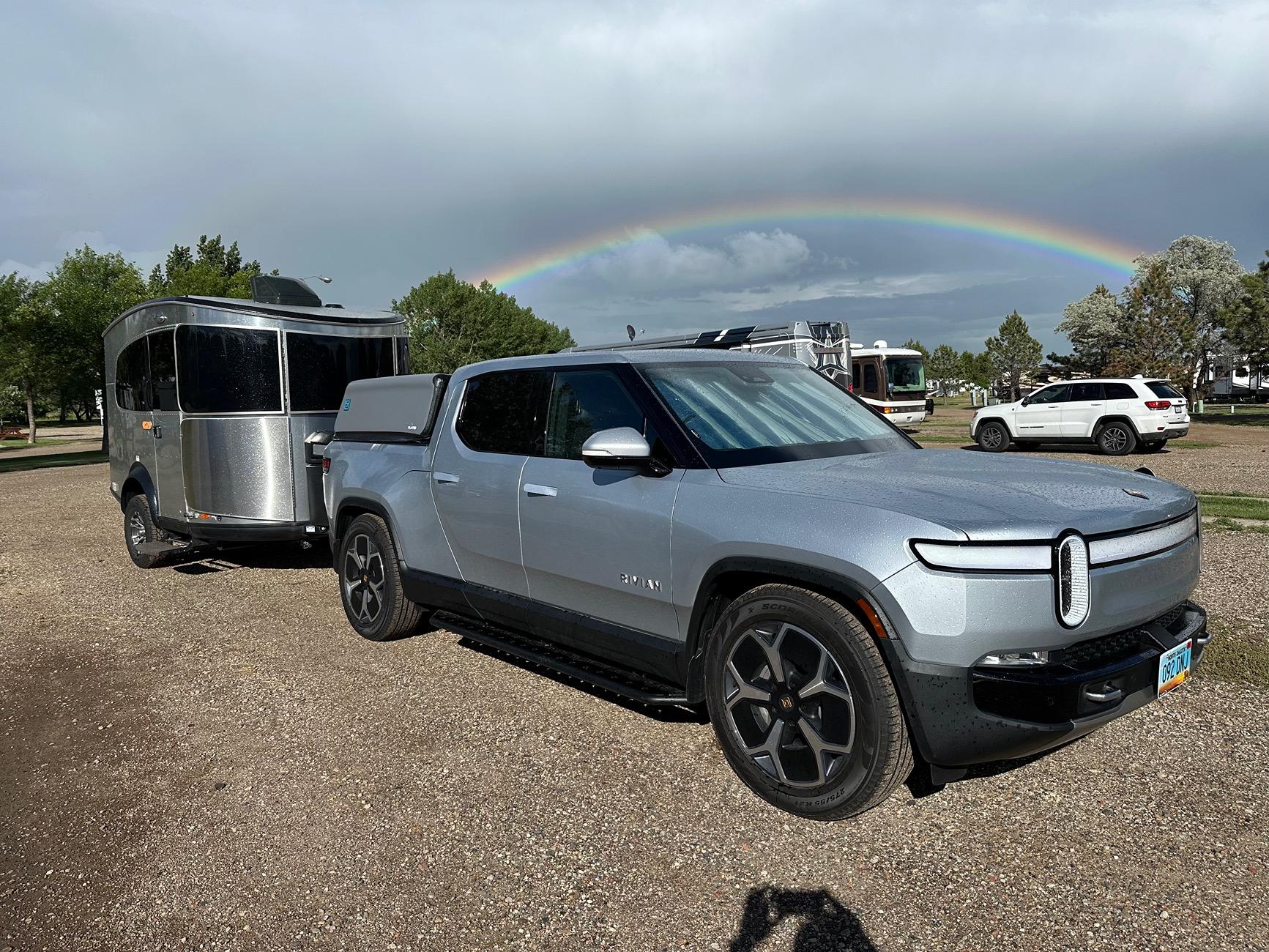

2023 R1T Dual Motor Max Pack.
2020 Airstream Basecamp 16X, Flated topper, bed loaded with two recumbent trikes.
Total miles: 3150
Speed: 63mph
Average miles per day: 330 (5 days out, 4 days back)
Average charging sessions per day: 2
Average time spent charging per session: 35 minutes, total of 18 sessions.
(Would have been shorter, but one session had to charge to over 95% as I did not charge at campground)
1.49 miles/kWh (lowest 1.05, highest 1.76, both due to wind)
2133kWh used (733 kWh added at campgrounds, only one charged ($10/day))
Cost $491.66 all Tesla SC except 2 free RAN and one EA. Have Tesla charging membership ($12.99 included in total cost) $0.30 - $0.36/kWh with membership. EA was $0.48.
Did not have to unhook trailer at any charger.
Same trip two years ago using F150 Powerboost hybrid cost over $1500 in gas. Over $1000 today at 11 mpg (generous) and $3.59/gallon.

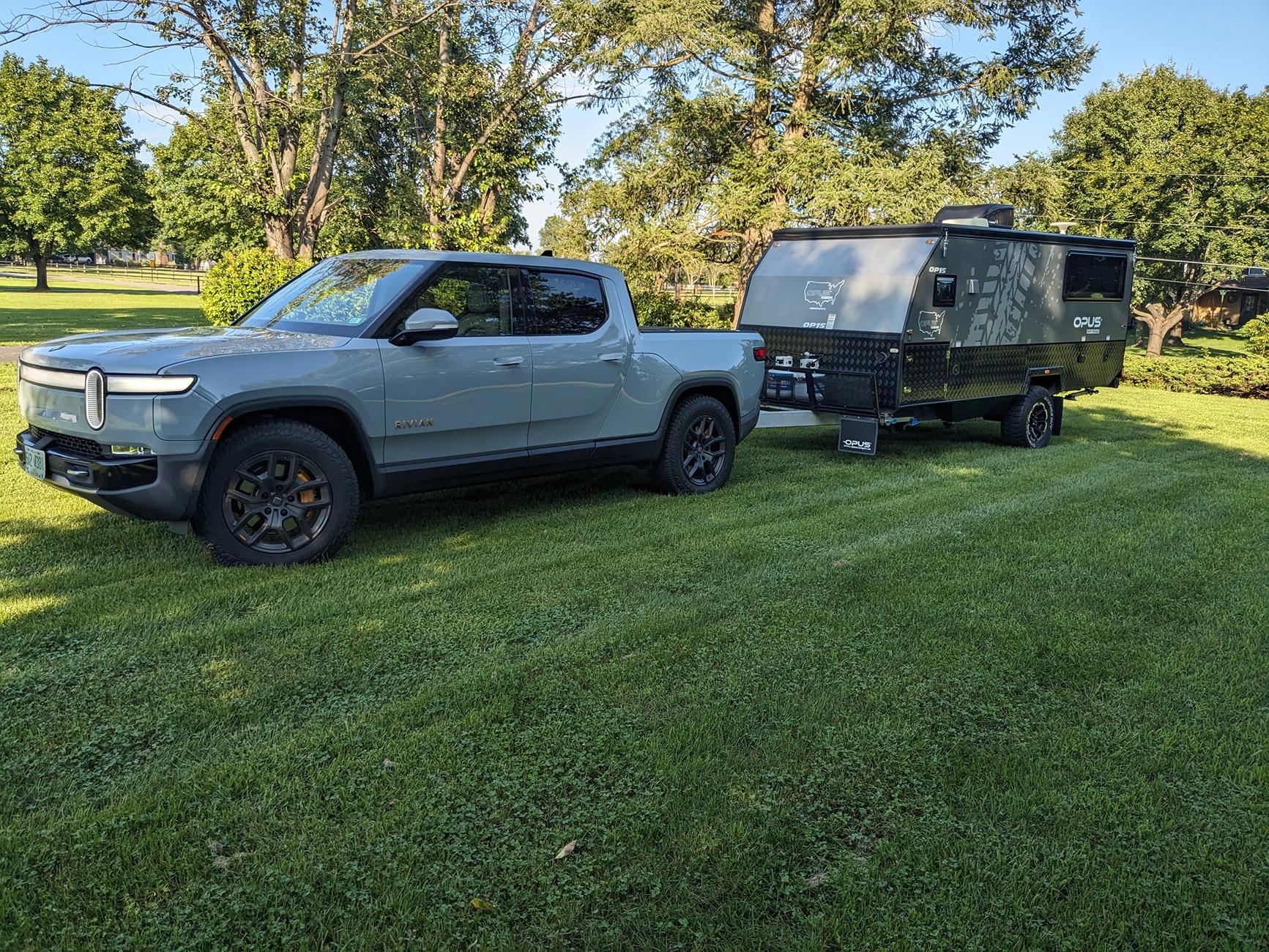

Thanks for the post, I'm seeing about 1.3 avg towing my Opus OP-15, your efficiency is amazing! The Basecamp is probably a little better on aero and weight than the opus, but I wonder if your topper is helping smooth the airflow out a little bit to provide a more smooth transition from the truck to the trailer. Do you happen to have any efficiency data towing that trailer without a topper?
Actually yes. I rented a R1T Max Pack through Turo in Phoenix. No tonneau cover. Did a 119 mile test between Phoenix and Apache Junction. Mostly flat at 63 mph. Of course not true interstate speeds, some stop and go. Got 1.62 mi/kWh. Actually did a 150 mile test in Tucson with a Lightning and got 1.58.

Thanks, sounds like the topper isn't making a huge difference then, seems like the basecamp is just far more efficient than my Opus, which I would expect given the shape and the parasitic drag of my OP-15

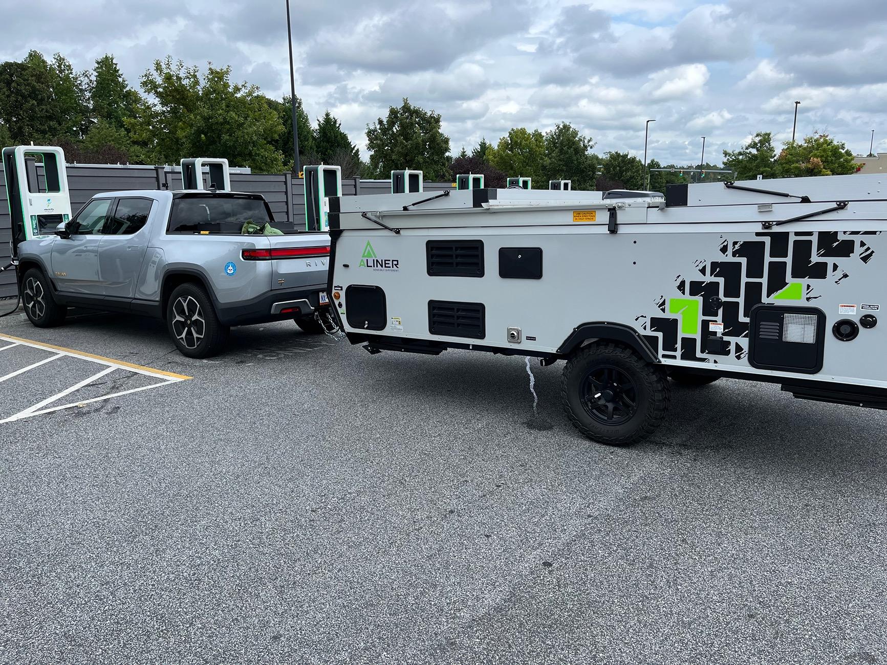

I’m impressed with the efficiency of the Airstream Base Camp as well. I have an Aliner Expedition that folds to about 6 feet. I get 1.6 m/kWh, and have gotten 1.7 on a 180 mile leg with a lot of downhill. Weight is about 3,000 loaded. 65 mph max on interstate and speed limit otherwise.
