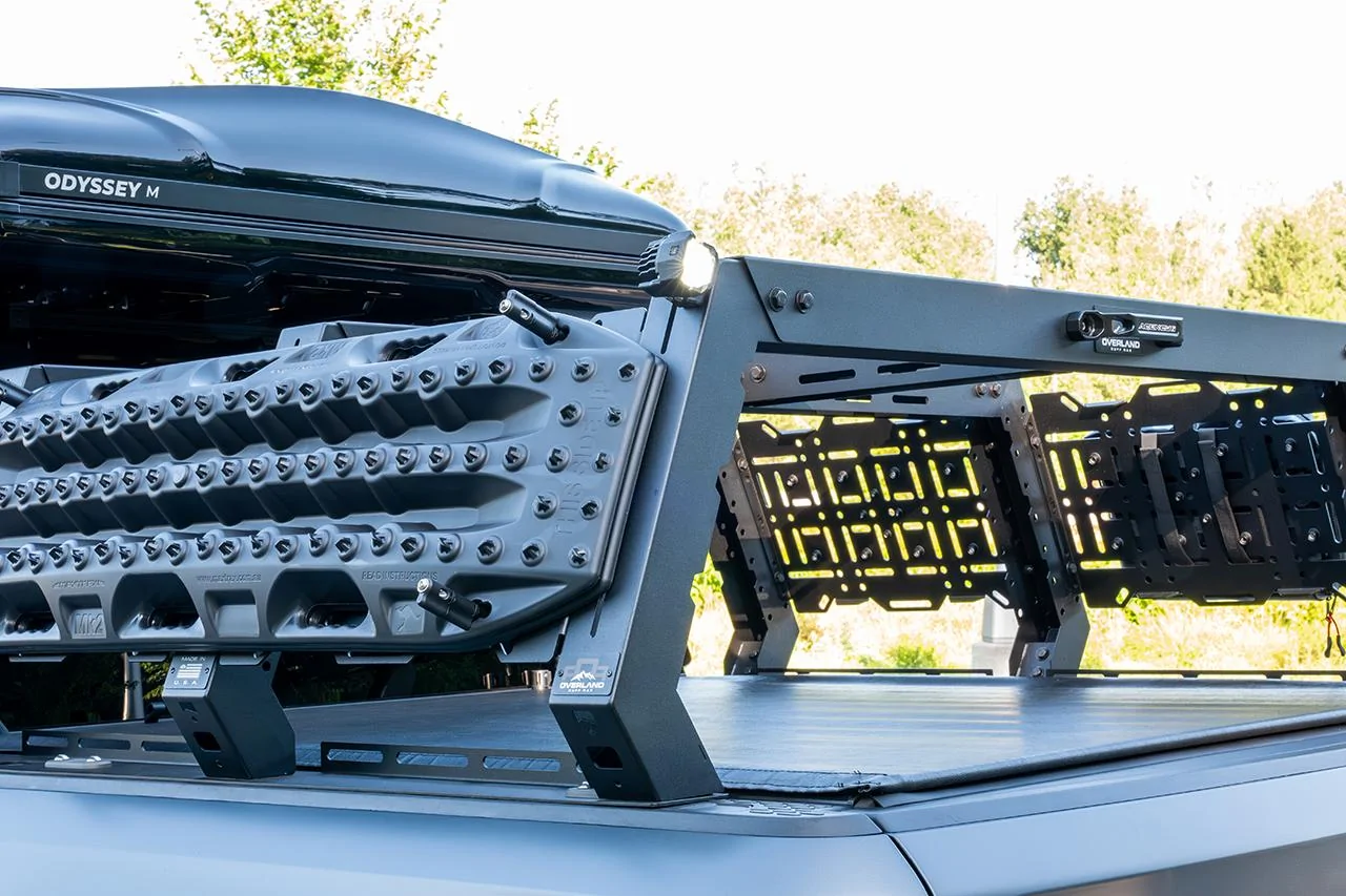

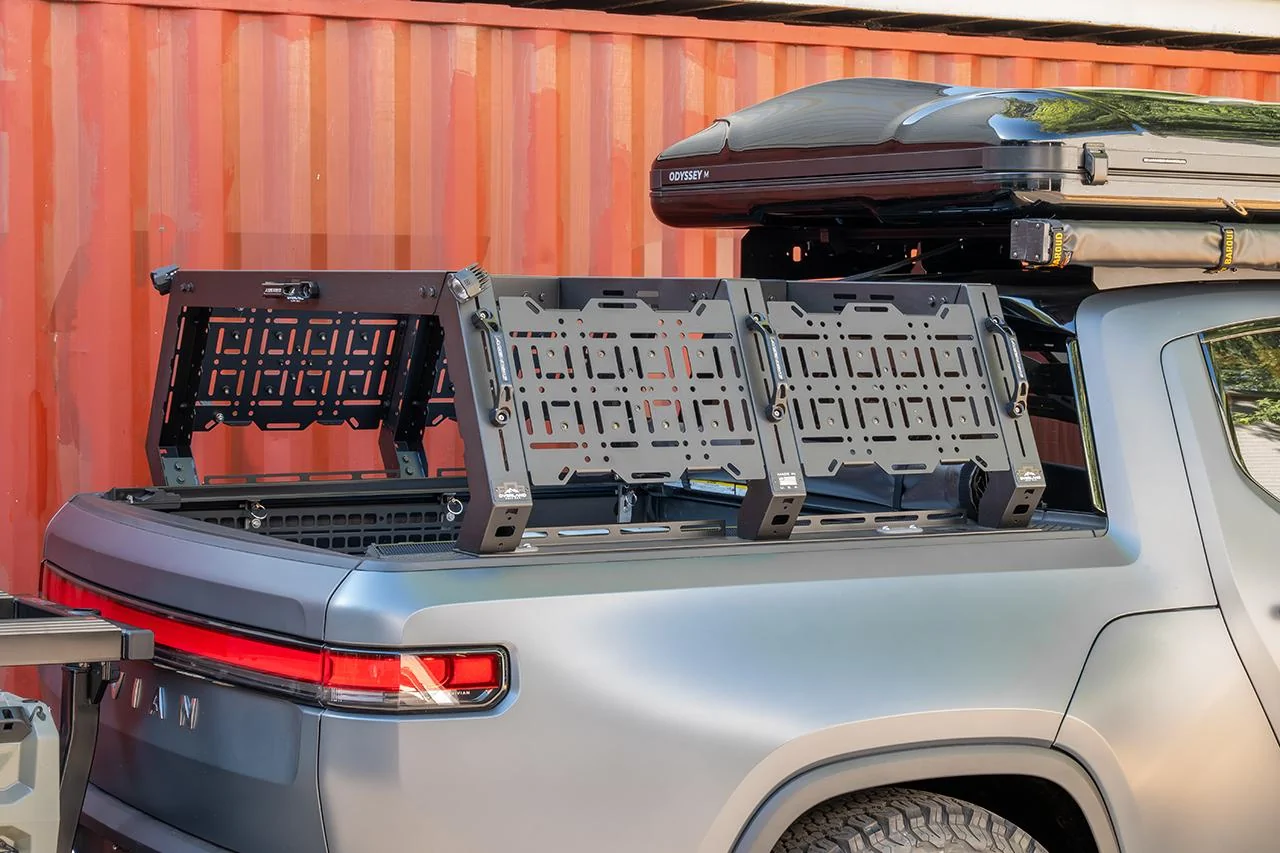

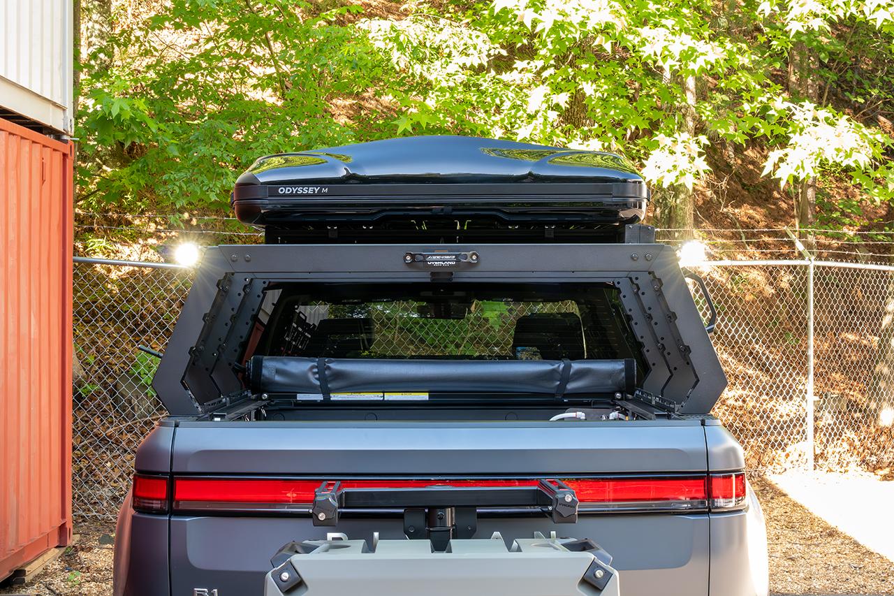

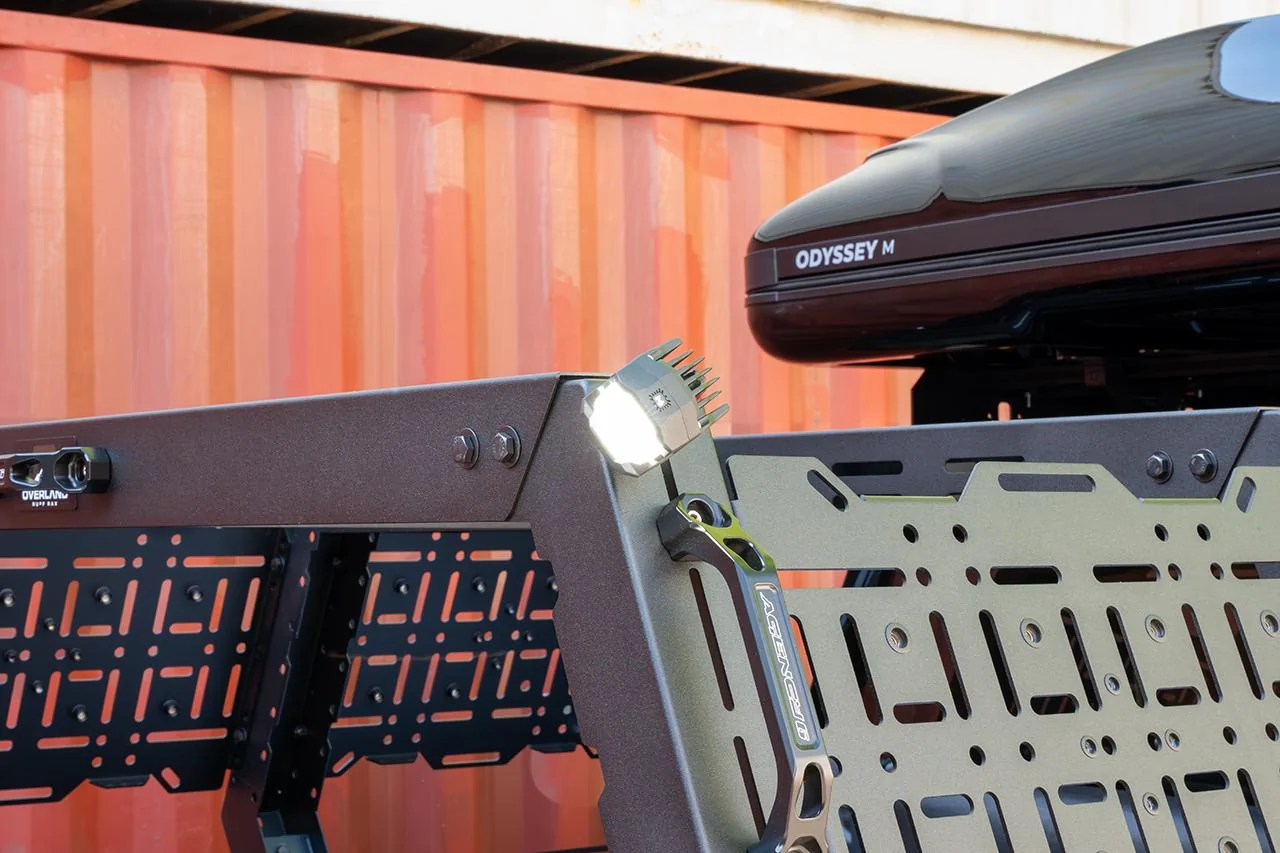

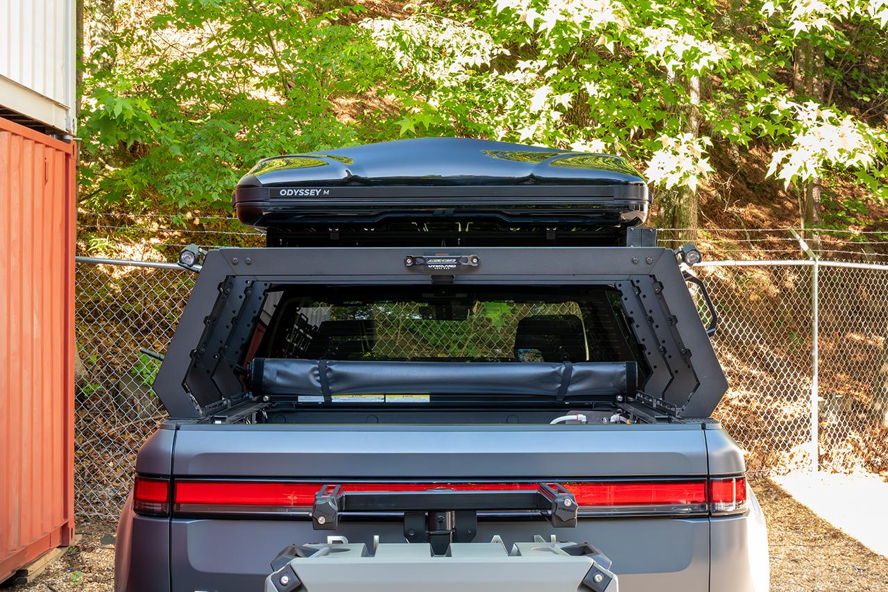

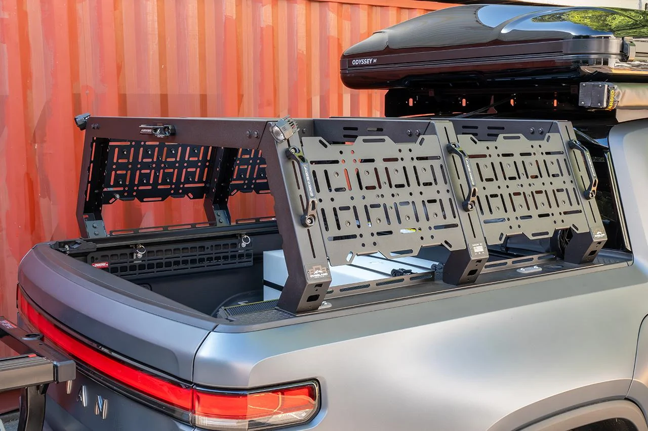

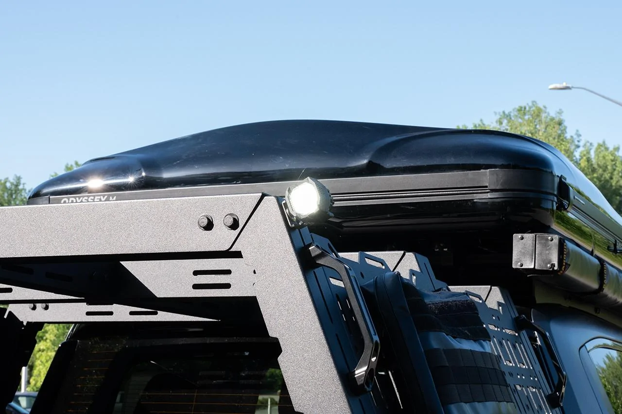

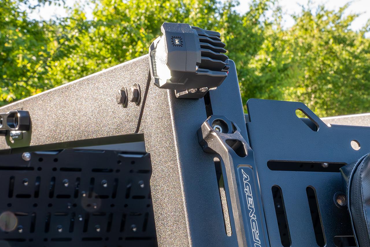

Hey Rivian Nation - check these out! We just finished an overland build on an R1T and featured our 1Banger LED Pod lights on the back of the bed rack. Creates a really nice camp light / work space light.
Like our ditch lights and light bar, these are wireless remote control LED pods:

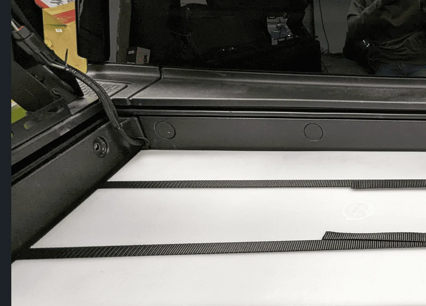

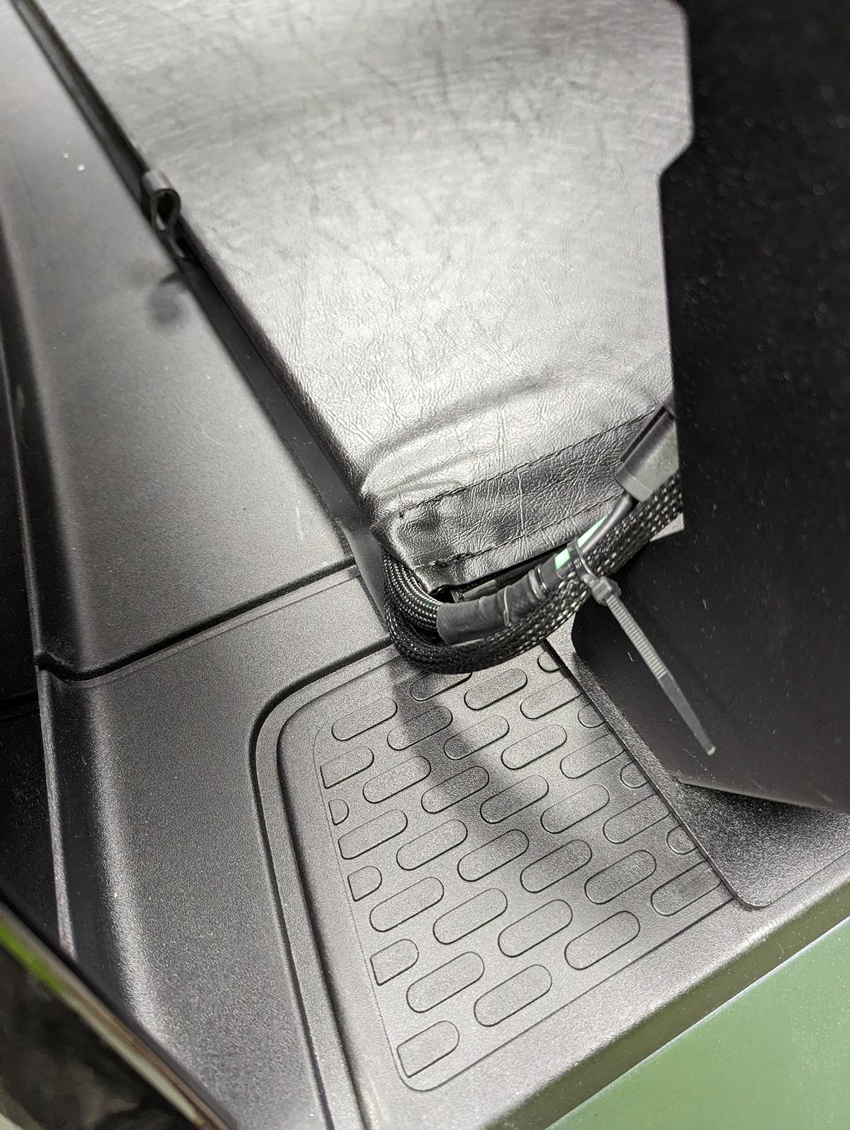

Can you provide any details on how you wired the bed rack lights? Also, if I'm only interested in task lighting while camped, do you recommend the wide or flood?

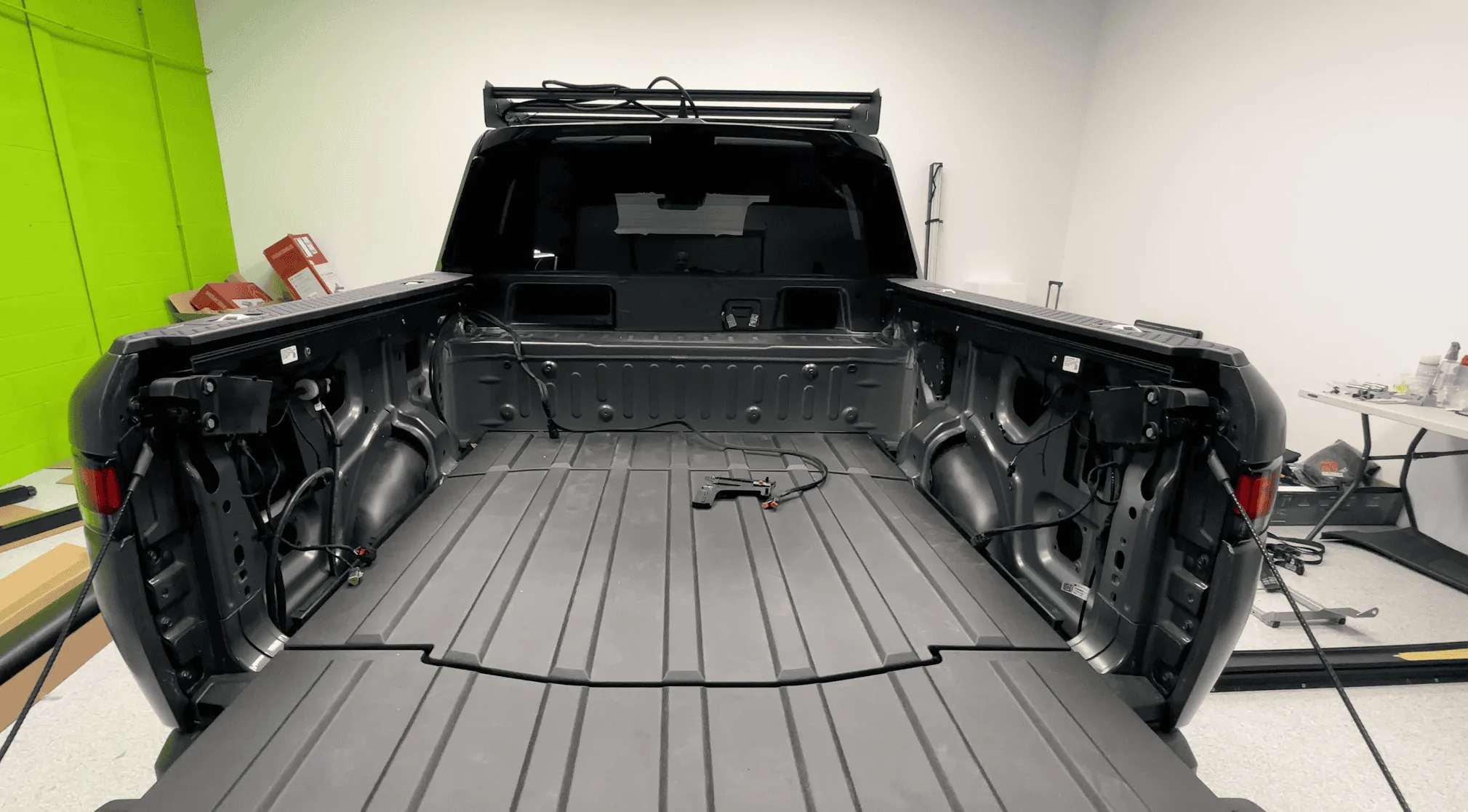

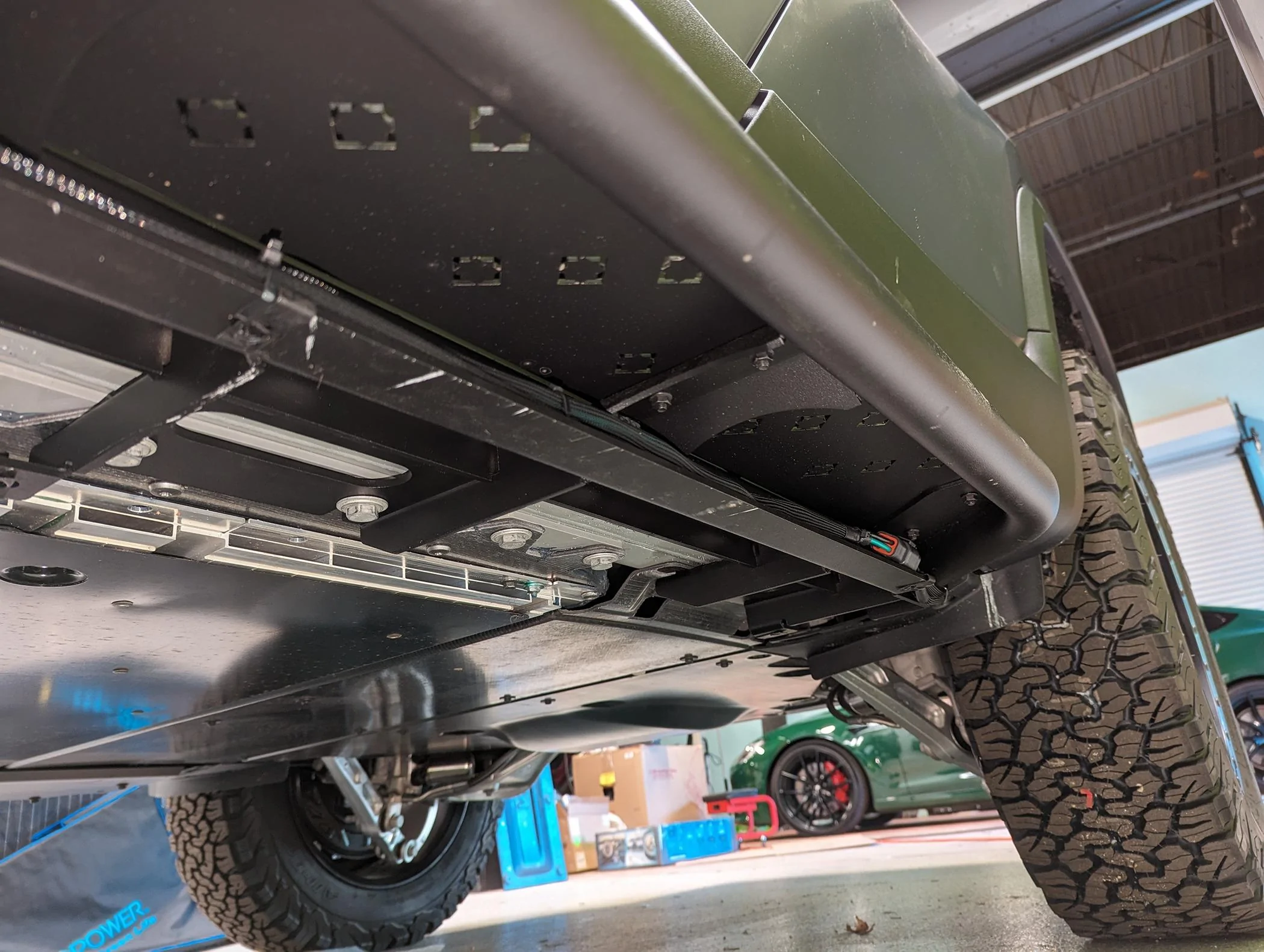

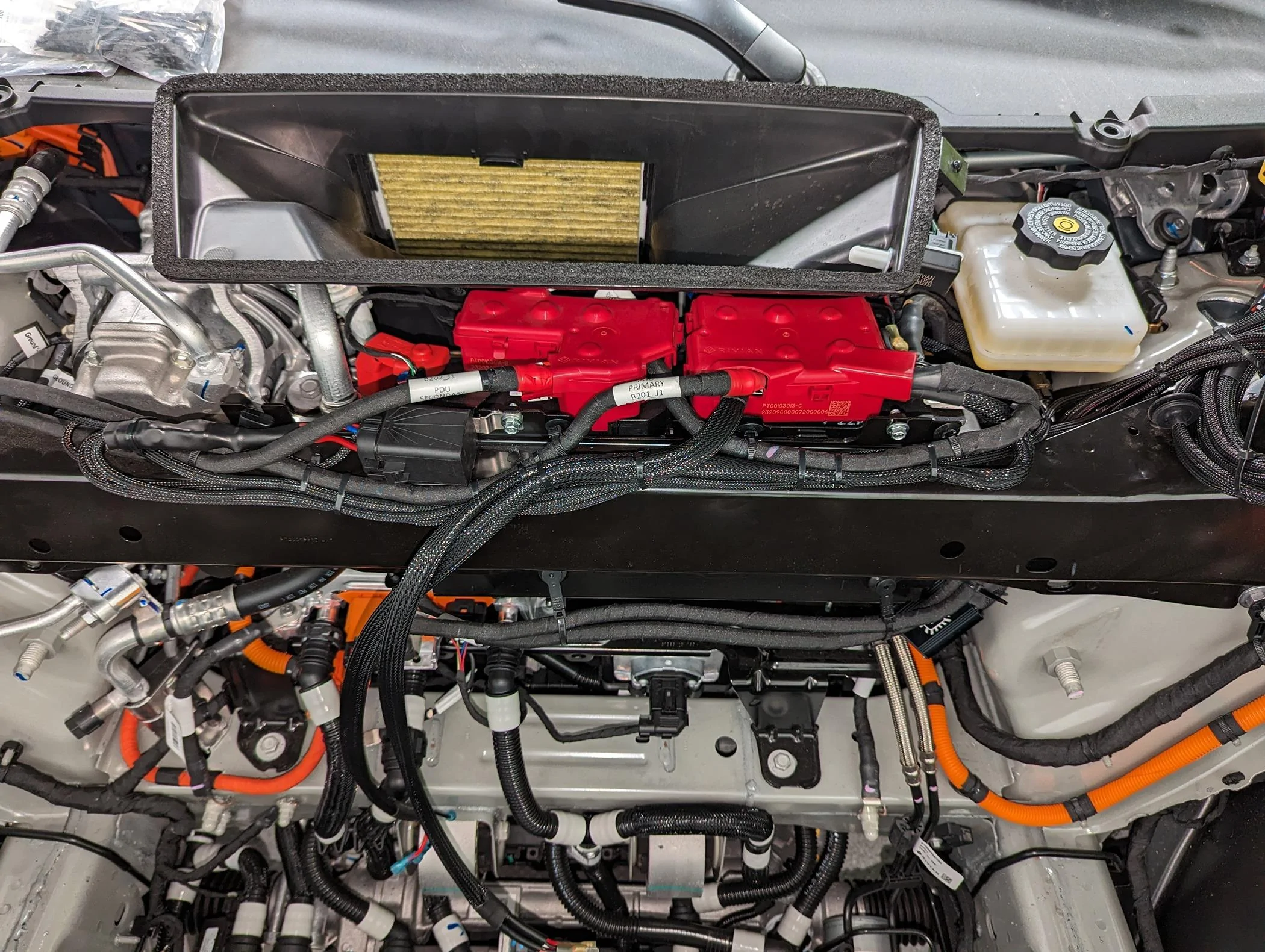

Sure! On this particular R1T build, we routed wires through the bedliner (front left corner)...down to under truck...up to frunk, and connect to low voltage battery. (on R1S, we route wires down through rear hatch)
For sure, you'll want the FLOOD option :)

Much easier and my recommendation to route the wires under the truck - no need to take interior apart. When you pull back the bedliner, it's straight down to get under truck, and routing the wire up to the front inside the plastic aero panels is super easy.

It's much easier and more intuitive than I expected, btw. You can see our lighting harness in the bed here and get an idea...It just routes down through an existing hole / access point in this forward/driver corner as shown. Easy....
