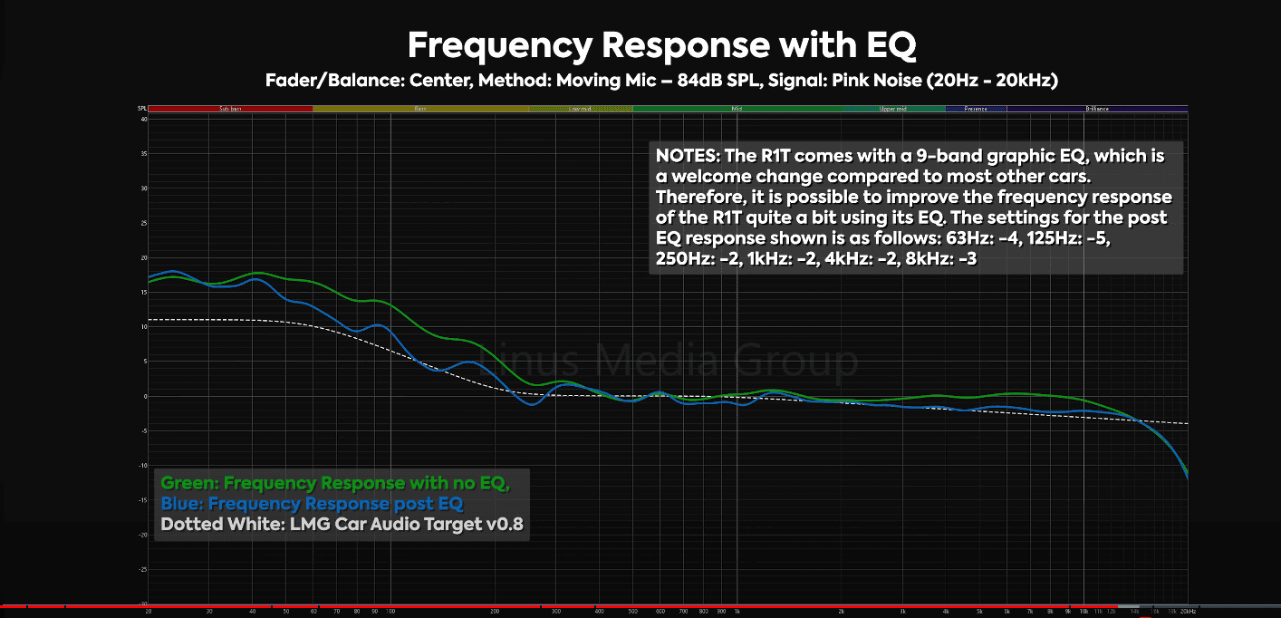

BTW: Your settings:
  • Use these EQ settings: 63 Hz -3 notches, 125 Hz -3, 1 kHz +3, 2 kHz +3.
Are different than the ones recommended by Linus' Labs for the Meridian R1T:
Rivian R1T R1S How to Improve a Rivian R1T's Meridian Sound System w/ Simple EQ Changes (Equipment Measured Tests & Results) + Comparison to Elevation System 1711214972020-kx
I thought the Linus settings were o.k., but I increased the 63Hz and 125Hz by one notch (closer to your settings) so I'm inclined to trust your testing methodology. The discrepancy for 1kHz is really large.
That’s interesting. As I mentioned in my R1S Elevation post, I used a target curve designed for home theaters, which might explain why we want more bass boost in our cars than our theaters.
That said, I’m puzzled by Linus’s cuts at 2 and 4 kHz. That area definitely sounded recessed to me and benefited from a boost.
But try both and see which you like better. Do report back!
